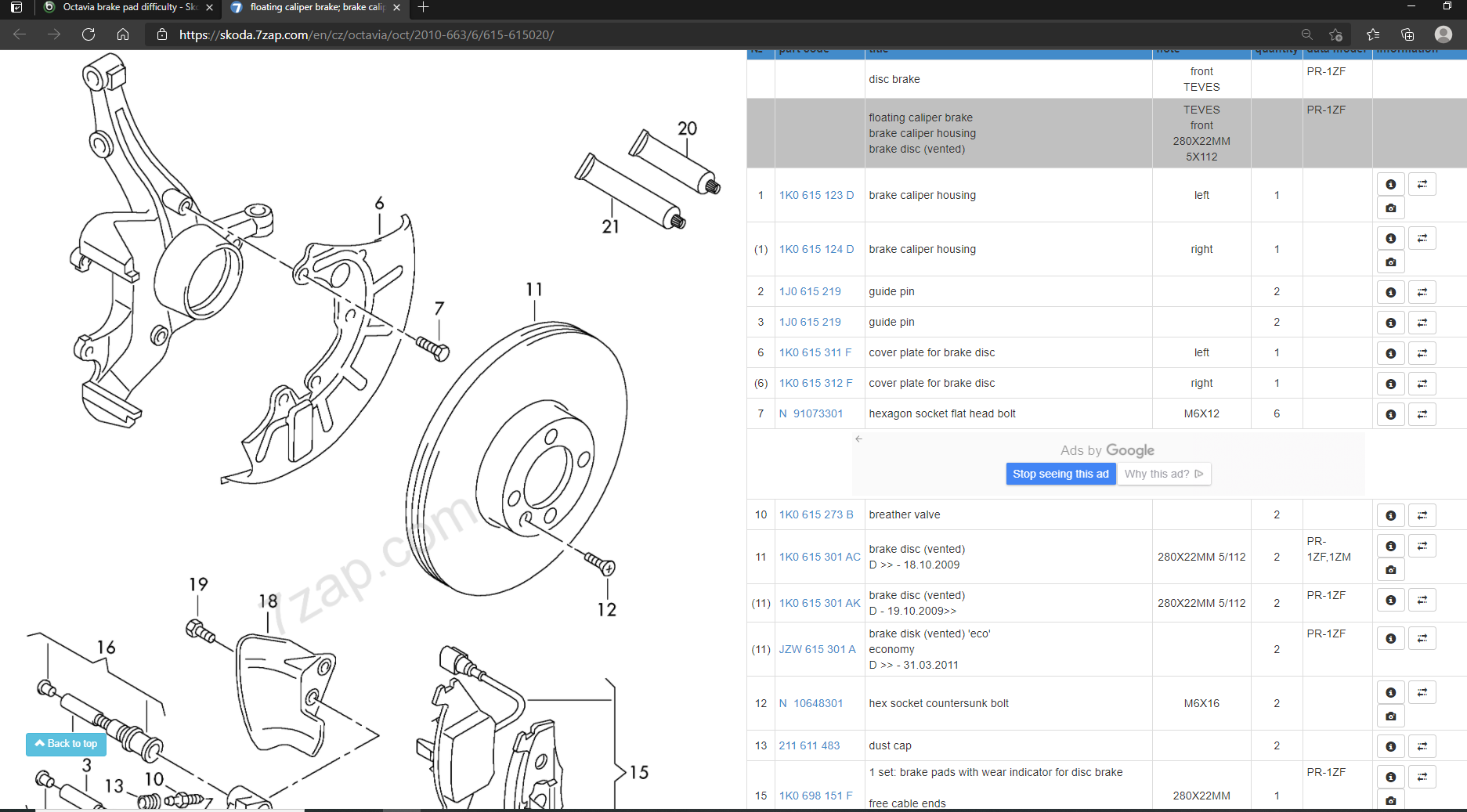

You need to work out, or find out which PR code your front brake system is. 1KS only refers to the rear.
There appears to be 3 different options
280mm discs - PR=1ZF
288mm - PR=1ZE
and 312mm PR=1LL or 1ZB
At 122hp I doubt it's the last of those, so look at your calipers and see if they have a spring clip on the outside face (288 style) or not (280 style).  See diagrams and part numbers of everything via this page: (view on computer not phone or you tend to lose vital columns in the table)

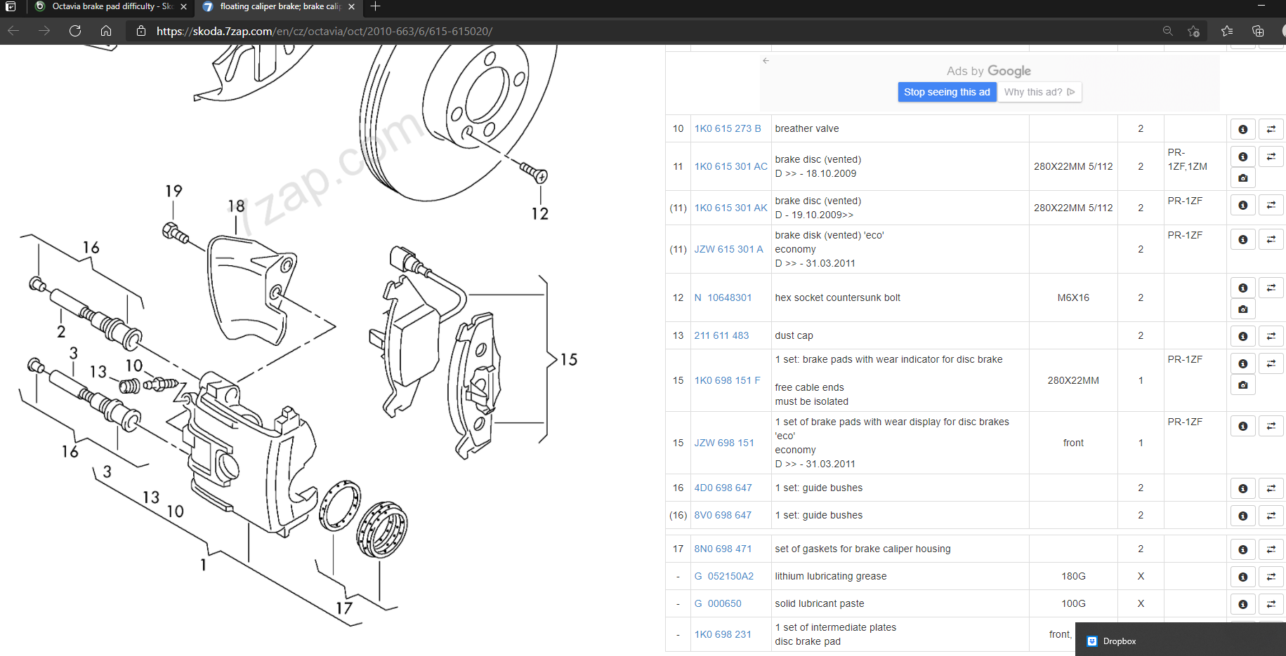

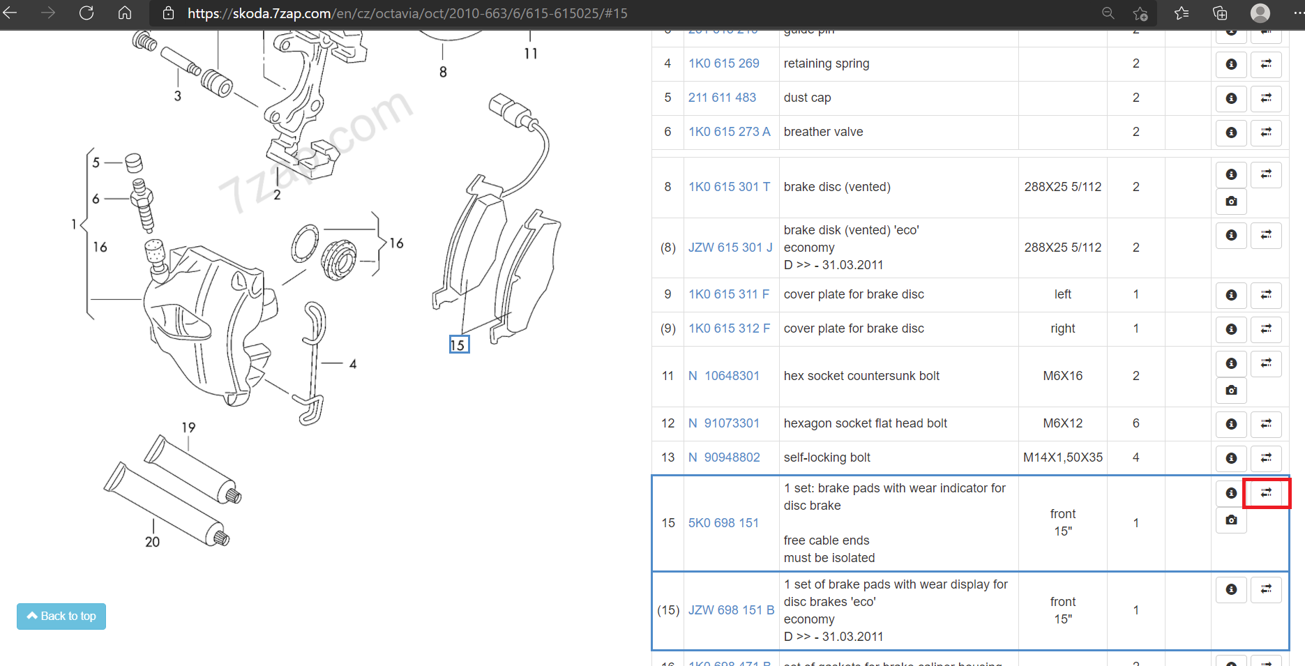

Yours must be the 288 set-up then I think:
Part number of pads shown as item 15. /If you navigate to that page via the link I posted before, then click the button I've highlighted with the red square, it'll give you a long list of aftermarket parts equivalent to that Skoda number.

Oh? How do they have the spring clip (item 4 in my screenshot above) then?
They have a clip, presumed with some springiness, but it is a completely different clip to the one in your diagram - more a flat piece if metal that is combined retainer and anti-vibration shim.
<Edit> a bit like the Teves one, but I can't see the thing at the end, properly, at least not without taking them to pieces. </Edit>
Edited by Camlobe
extra info
  • Sponsor
Ah, OK, sorry, I didn't anticipate that ambiguity. That clip is part of the pad, as you'll see in my latest link.
