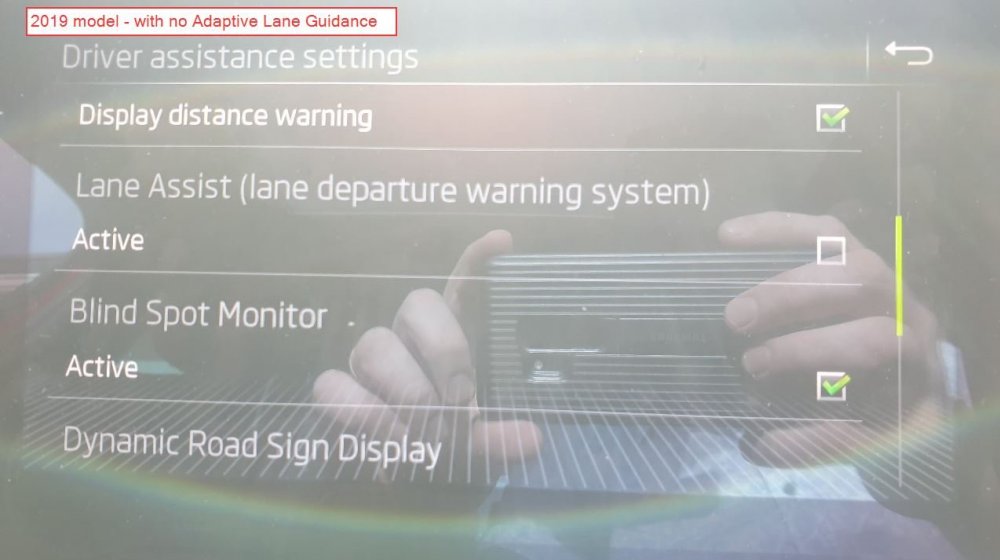

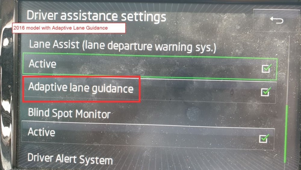

What settings are showing on the infotainment under Driver Assistance Settings? Are there two options (ALG and LA) or just the one? Sounds like neither (if you have both) are on - ALG as I understand it is meant to keep you in a lane (not meandering from side to side) whilst LA would vibrate the steering wheel if you cross a lane marking without indicating. Pic (from a post on this forum albeit for a Superb) shows older options settings screen with ALG and newer without it. Hope this helps. 1359723821_2016SkodaSettingsPic.thumb.jpg.f5b657c9def756a3b955484cbf0197de.jpg.eeff448d5579cd787a91a494c3d70e12.jpg618987289_2019SkodaSettingsPic.thumb.jpg.f05b5e146fb92e165449668a8b597566.jpg.ea09bff1b0a1be319fcf2a2c31366b2d.jpg
Hi VRT24, thanks for your reply, both lane assist and adaptive lane guidance are shown in the infotainment system and both are ticked on. It makes me think that when the camera was replaced a year ago it was not properly calibrated. Due to the lockdown I hardly drove for most of the last year. My ALG ping pongs me from one side of the lane to the other.
