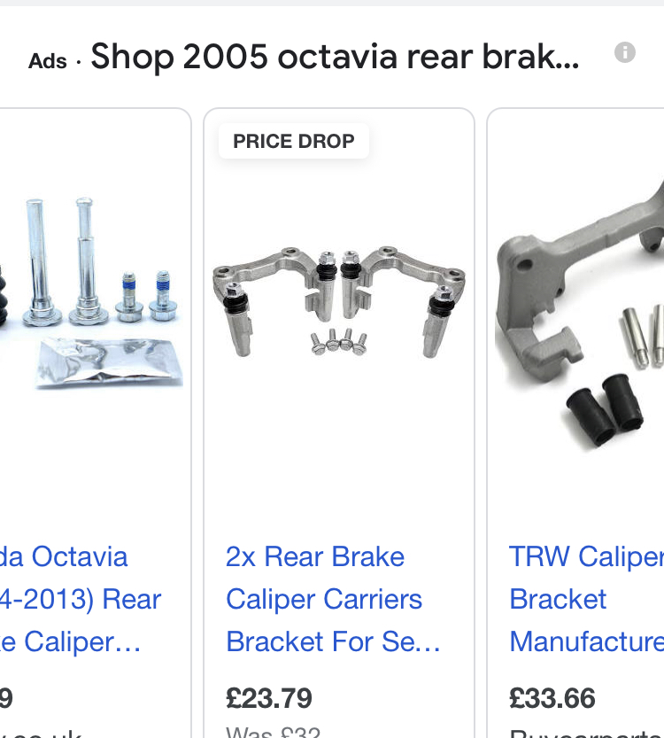

Iirc it does depend on the disc type being a solid disc and the carrier not overlapping the discs too much when in position (if that makes sense!)
I’m gonna google it and see what I can see .....
If you have this carrier on the rears (middle pic) you won’t have to take the carrier off to remove the disc, if it’s not like this then you will need to remove the carrier to take the docs off (the carrier on the right of the pic ) ....

The carriers do look like the TRW as pictured above, however the discs could be removed without removing the carriers, thankfully............ as a few of you have said.
