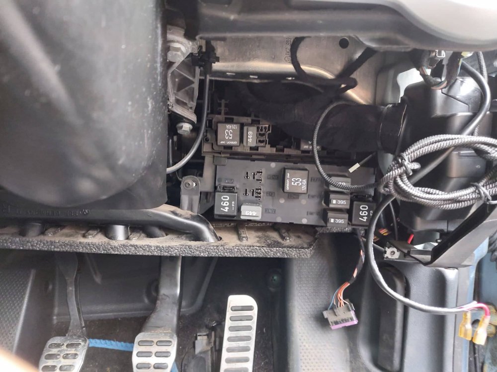

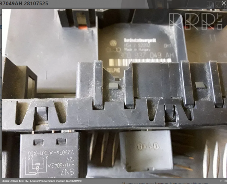

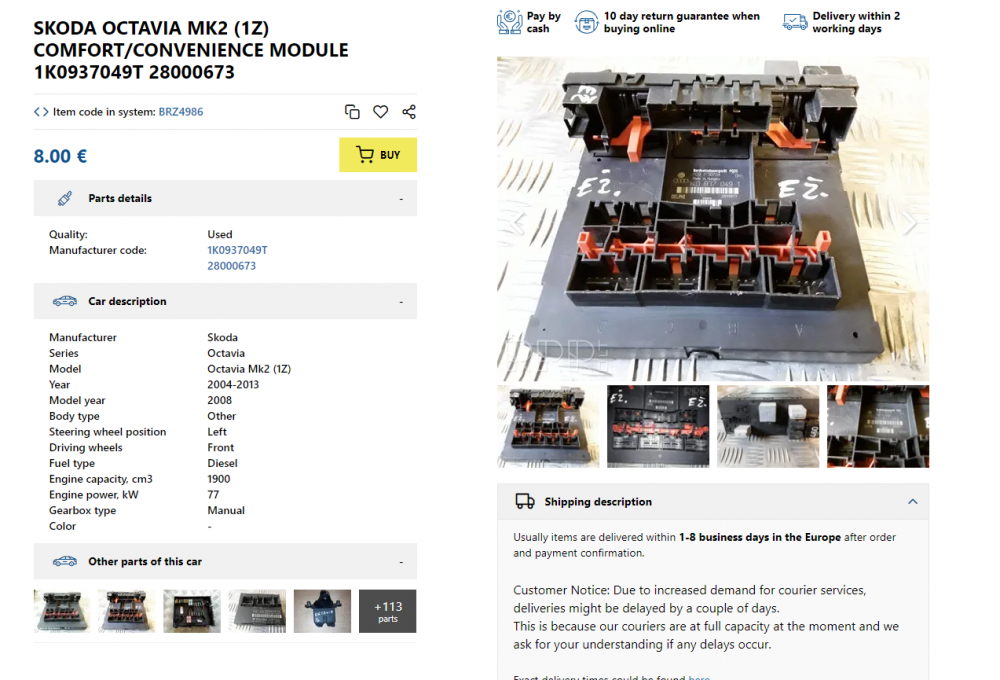

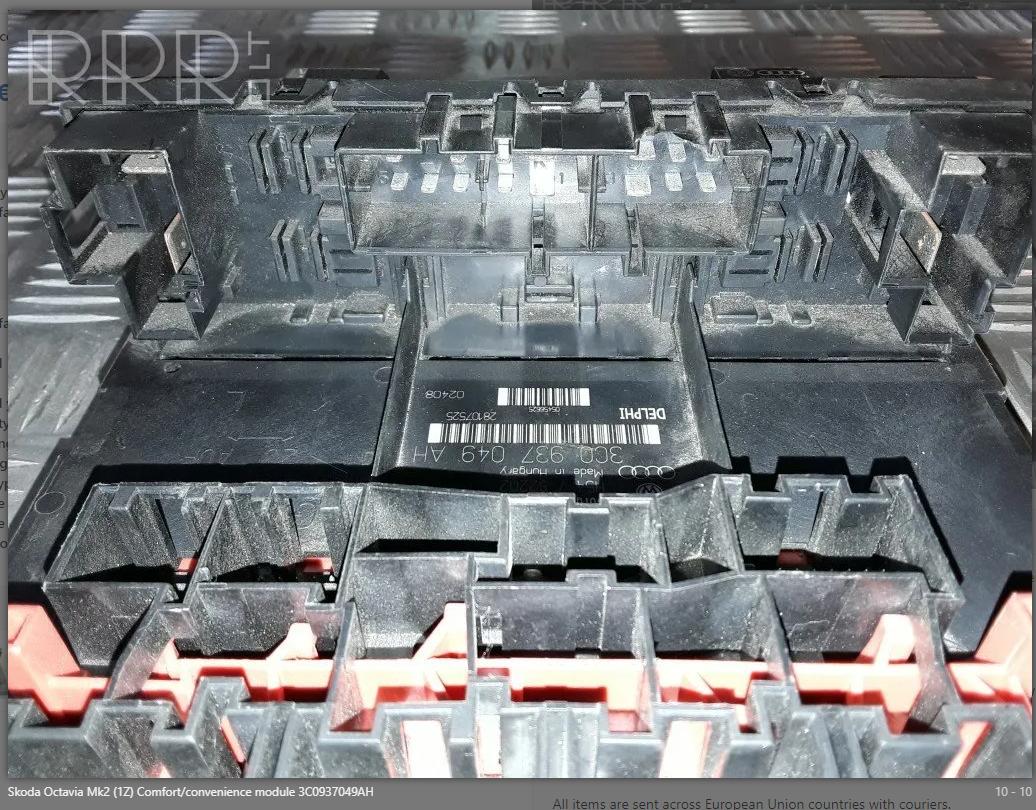

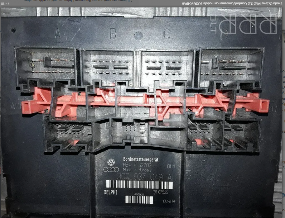

Hi Guys been doing a bit of research and found 1 that looks the same as mine though it dont seem to include the top relays so might be 2 separate boxes. They seem to be plug and play what do you guys think?
New ones are nearly £600 used from ebay about £20-30 but going to try using contact cleaner 1st

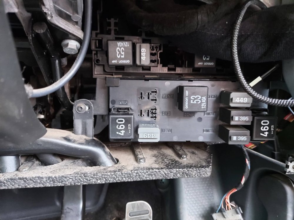

Posting photos of them so if anyone else has to replace them you will know what to look for at least lol
The names that it seems to identify the main relay box is : ONBOARD SUPPLY CONTROL MODULE or Skoda Octavia Mk2 1Z 2007 Comfort convenience module.
Photos
Edited by sealover1
The actual name for it is CECM Central Electronics Control Module
You can also find it in a host of VAG cars 2004 - 2009 Mk5 Golf, Early Tiguans, Scirocco

They are quite cheap now, but you will need vcds to fit it, if you are not buying exactly the same one don't copy and paste the coding either.
Check that the relays are ok, you could try using the same numbered ones in a different place or test them.

I cleaned all the relays and ports off with the contact cleaner but when I pulled the 395 relays off the relay covers come off so I pushed them both back on and wiggled them out, if the covers come off does that break the relays? car still wont start and i,m really stuck,
do you think replacing all the relays might help as I could not see how the relay box comes out so I dont know the part number as its on the back or I would buy another one on ebay, or if you know what one it is could you give me an ebay link please and will get my mate in the garage to fit it as I dont know how to set it up
hope you can help mate as really stuck now I wish I had the money to just take it to a garage and say just fix it (how the other half live A)
