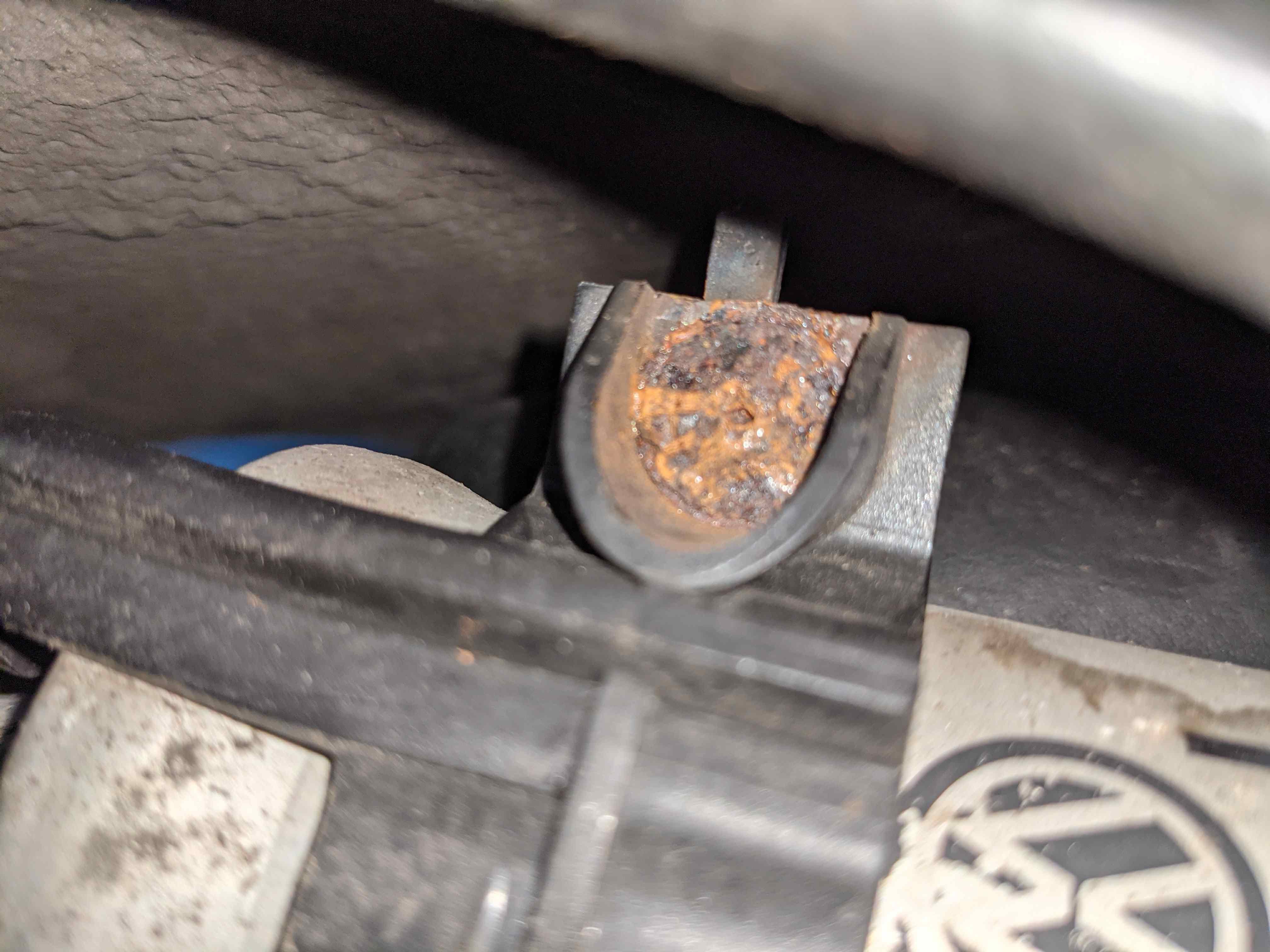

Fuel filter screw
Hi all, I have gone to change my fuel filter and the head of the screw has fallen apart when I went to unscrew it.
Seeing as I will now need to drill the screw out and buy a replacement.
Does anyone happen to know the specs of the screw required?

Not sure what screw you mean, can you take a piccy ? or do you mean the screw in the clamp that holds it ?
Edited by UrbanPanzer
This is the screw in question (not a great picture I know).

While I agree with the fact that it should not need replacing unless it is causing an issue with running, I managed to get that screw out on my wife's old 2002 Polo as I did plan to replace that filter and its associated pressure regulator, I cleaned out the maybe Torx recess and applied plenty proper release fluid especially into/onto the open end of that threaded hole - after a few attempts and application of more proper release fluid (and that does not mean normal WD40), I got that screw out, cleaned things up and either refitted it with plenty grease on it and over the exposed upper end, or fitted a new screw again wit plenty grease.
Replacing a screw that used a captive nut, with a smaller size screw and nut is really going to make things a lot worse for the next poor sod that goes to replace that filter, if I remember correctly, both sides of that plastic clip are part of the fuel tank.
I've always planned to never plant any traps for future owner/fixers.
