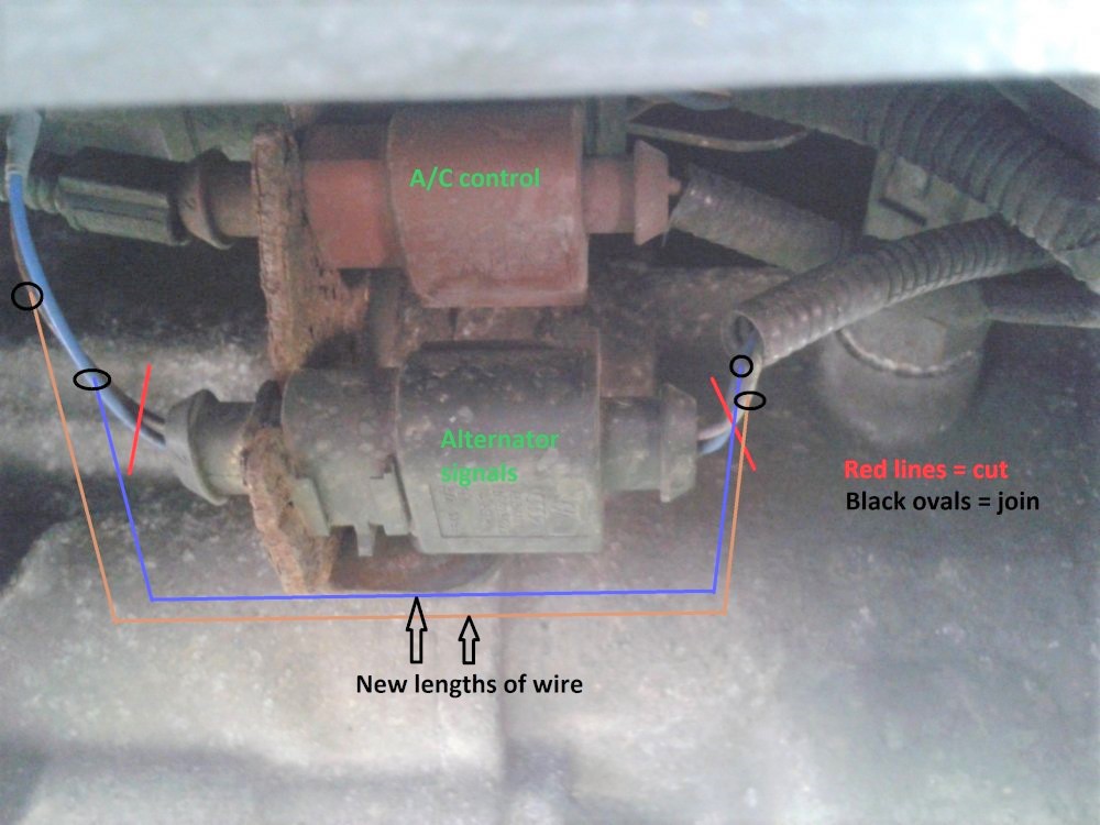

This is usually a symptom of the common broken alternator wires at the plug connectors underneath near the gearbox. The blue wire is the exciter wire that is responsible for the ignition light and correct alternator start-up. Have a look to see if any of the four wires are broken.
Looks something like this....
59baaf0e04213-20150823-154122-Copy-thumb
