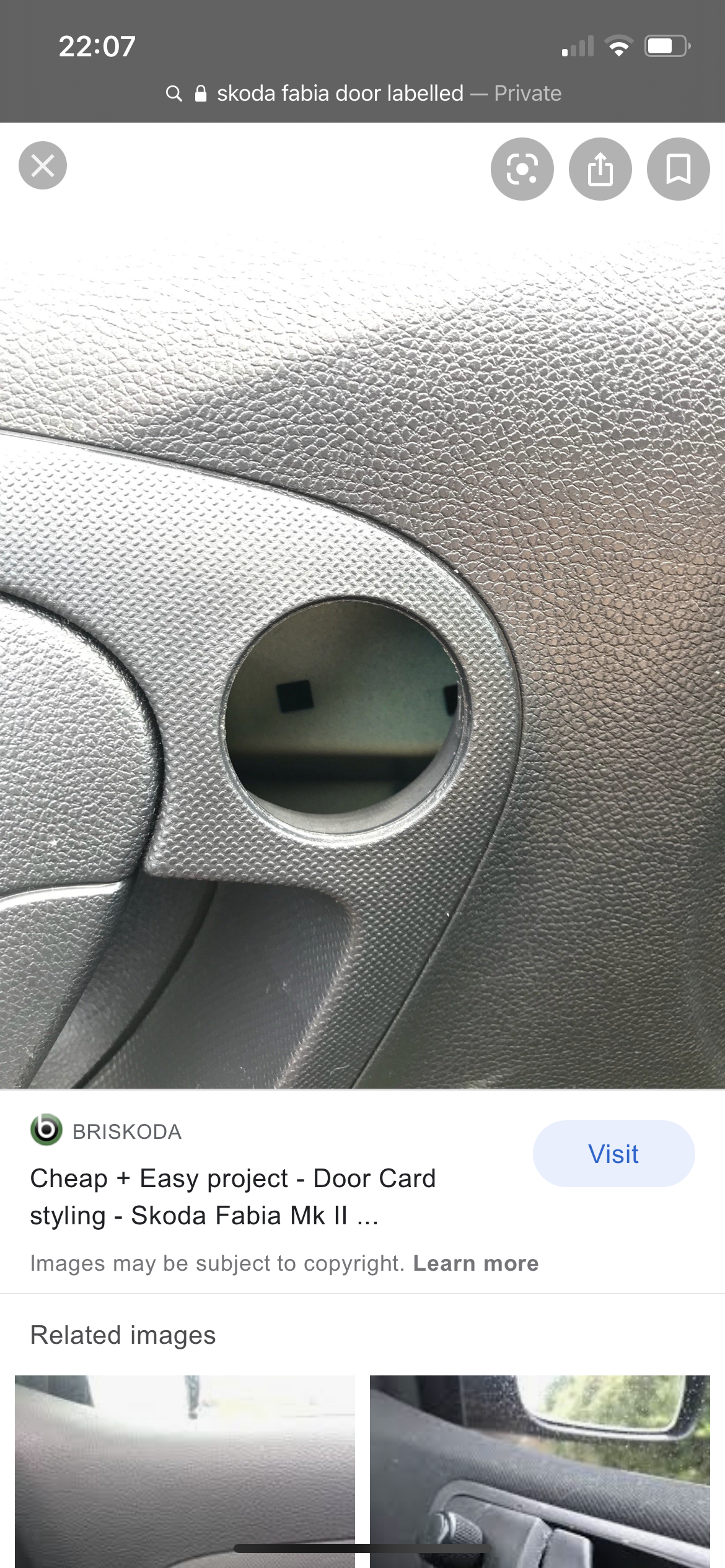

I recently purchased a Skoda fabia and noticed that the passenger side door filler thing is missing (I don’t know what to call it). Does anyone know if I can buy it after market because I find it really annoying. I have attached a pic for clarification
Its the blanking hole for the LHD cars wing mirror adjustment.
Its pressed in from behind so you would need to remove the door card to fit it in. The replacement part number is 5J0 867 329 A (see image below)
Pop into Skoda themselves and speak to the service desk, they will be able to order you the part and I doubt it will cost much (Under £1 I bet). They will also be able to search the part using your Reg.
I noticed yours is a 2012 model though, you've posted this on the mk3 2015+ forum. @john999boy will be able to move this into the relevant forum for you.
All sorted. :thumbup:
As they pop in from behind, are you sure it is not just lying around inside the door? Might be worth your time having a look as you need to do this, to fit a new one, unless you are clever and wedge it through the hole, stuck to something and then pull it back in to place. Probably not worth the trying, TBH.
