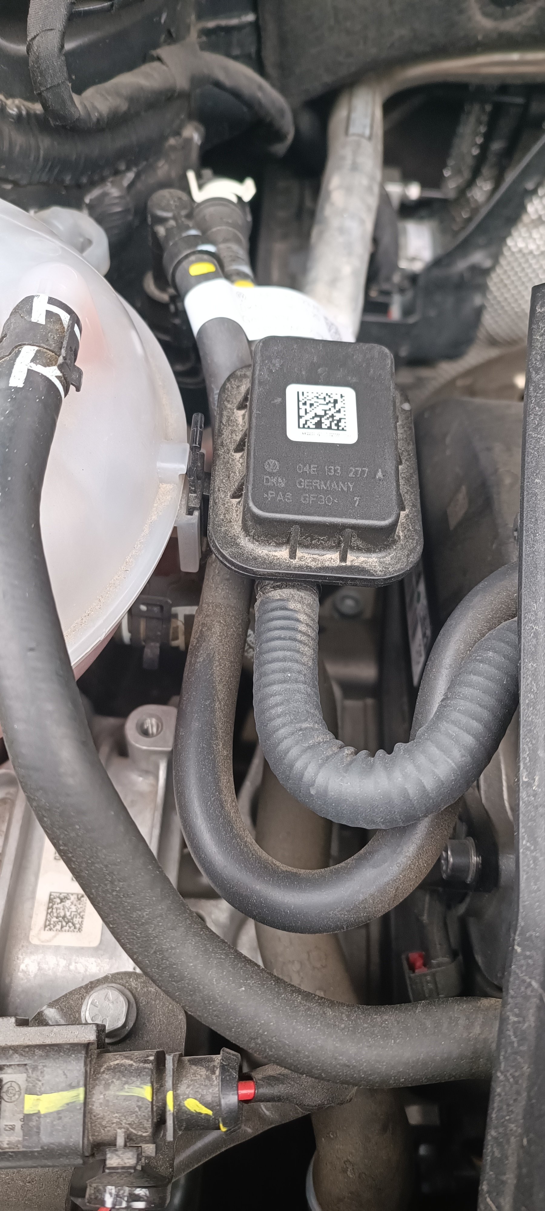

Hi
Exactly the same sound my car does on idle. i was searching where it is coming from for months. Like you said it started after first 1k-2k km. Totally by chance i find it. As you said it is coming from the selenoid valve. But not because the valve itself ,where it is attached to. this valve is attached to the coolant expansion tank. When the valve starts working the valve vibrates the expansion tank.in my opinion as it is half with fluid the empty space magnifies the sound. in my car when you press the tank and valve with your hand the knocking sound stops.
i will visit dealer next month. if they find a proper solution i will share it here.
This is the valve and the tank where it is attached.
Hi I seem to have the exact same issue. I have a cam sensor issue that’s being fixed so I thought it was down to a bad idle. However I am glad that you have found the issue with the solenoid valve.
What was the outcome of the visit to the garage?
1. is this normal and nothing to worried about?
2. is the solenoid faulty or will the vibration damage anything?
3. can this be repaired or replaced under warranty. Also my car only has 5k on it and a lot of people are saying they have this noise from nearly new. Will this part fail every 5-10k or is this a recall or  known issue from Skoda?
Any updates would be great. Thanks
(In my attached video you can hear the sound stop after 17s with a picture of my finger in the shot. )

On 18/01/2022 at 19:16, mustafasahin said:
Hi
My 1.5 TSi has a knocking noise in this exact area. It’s the ribbed hose that has split causing an air leak.

The picture is part of the activated charcoal canister system. The puffing noise is it working. If the pipe breaks, which it did on my 1.0tsi Kamiq, it gets a whole lot louder, but it is normal.
