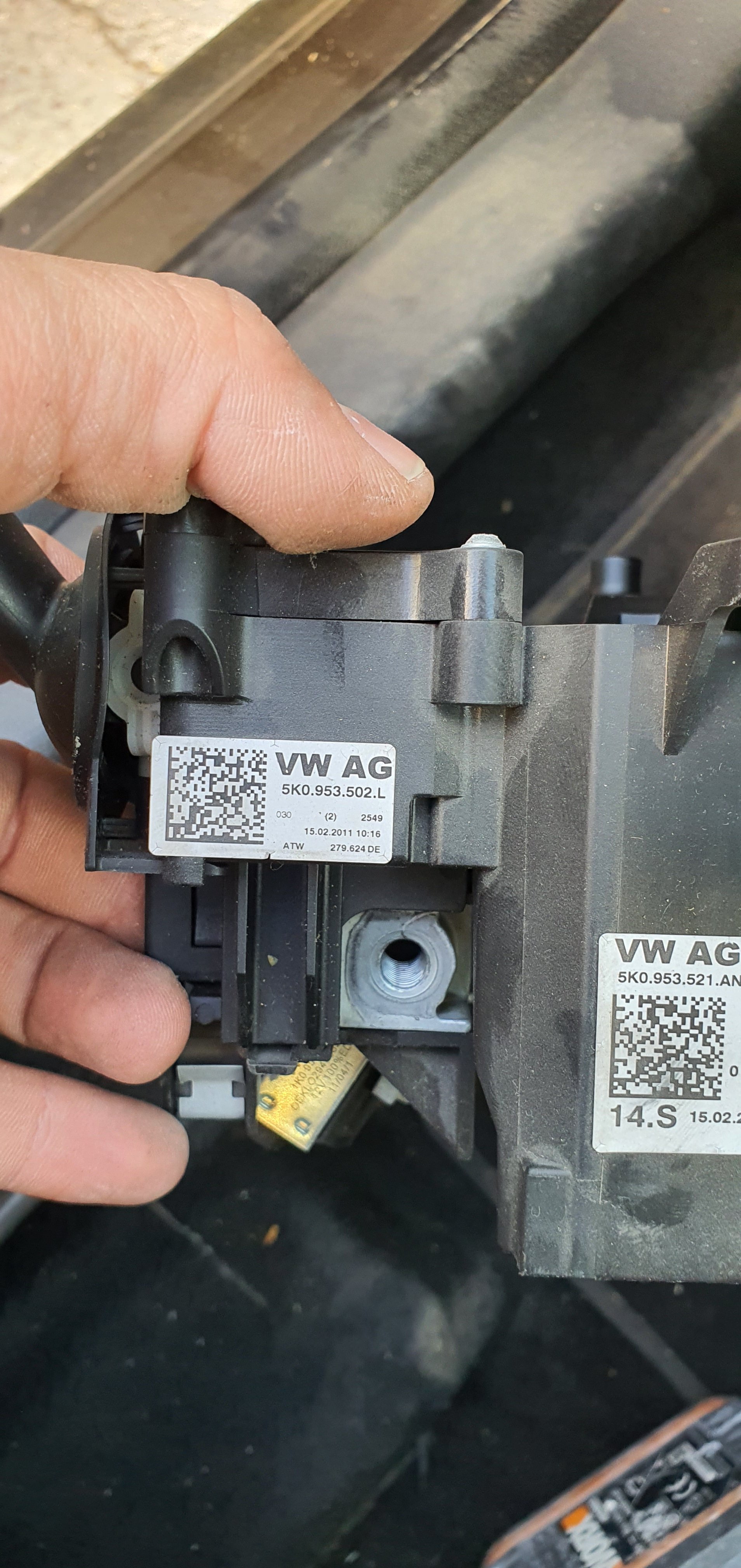

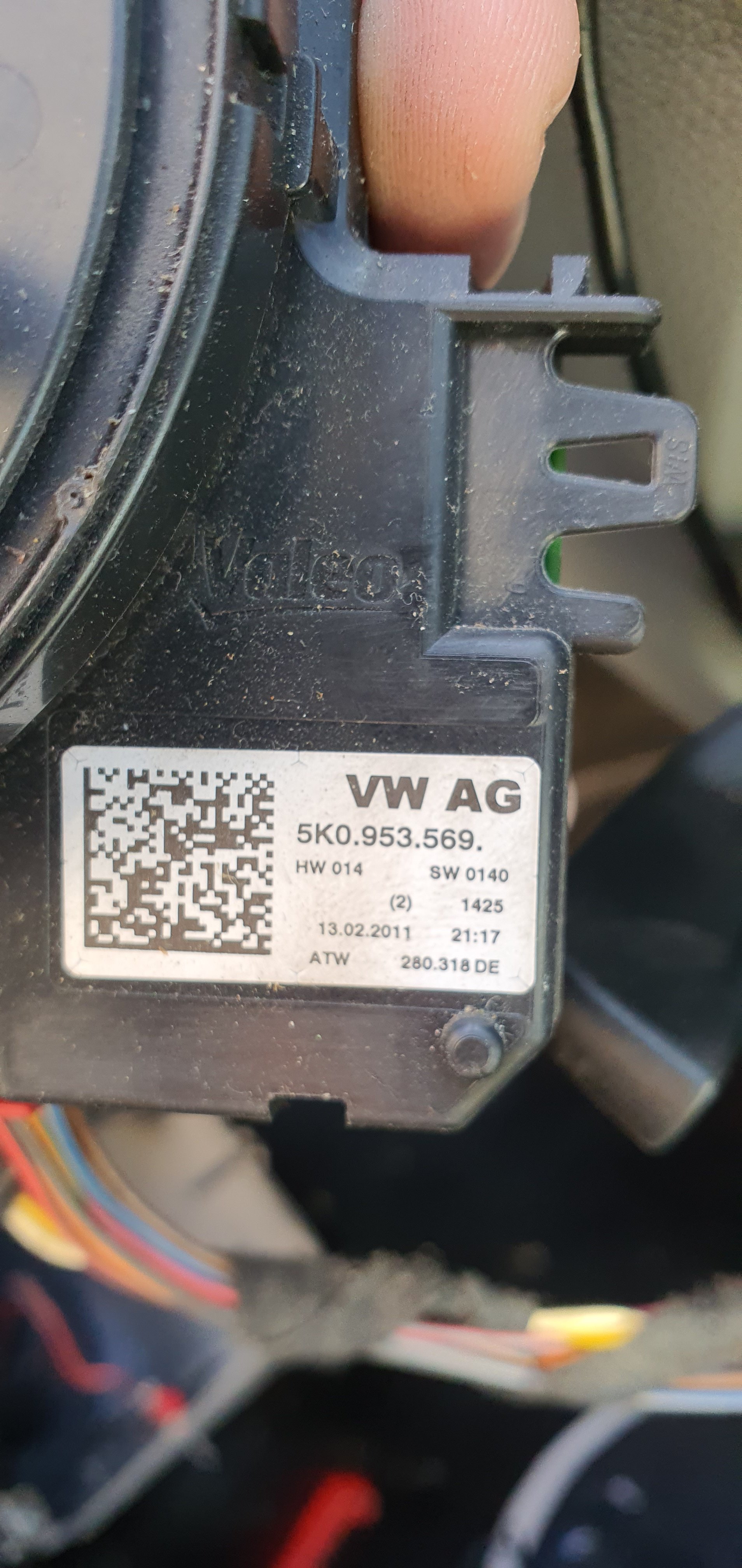

Hi everyone, i have recently bought a Skoda Yeti 2011 2.0 TDI 4x4 ambition, and i have successfully retrofitted MFSW on it, not i want to activate the cruise control.
Here is what i have done:
1) replaces the slip ring from 5K0 953 569 TO 5K0 953 569 AH.
2) replaced the Steering wheel from a yeti 2017 3 stroke with push to talk button (everything works)
3) of course the airbag is replaced and works fine
4) replaced the stalk from 5K0 953 502 L TO 5K0 953 569 N (the one thas has cruise control buttons and trip computer buttons)

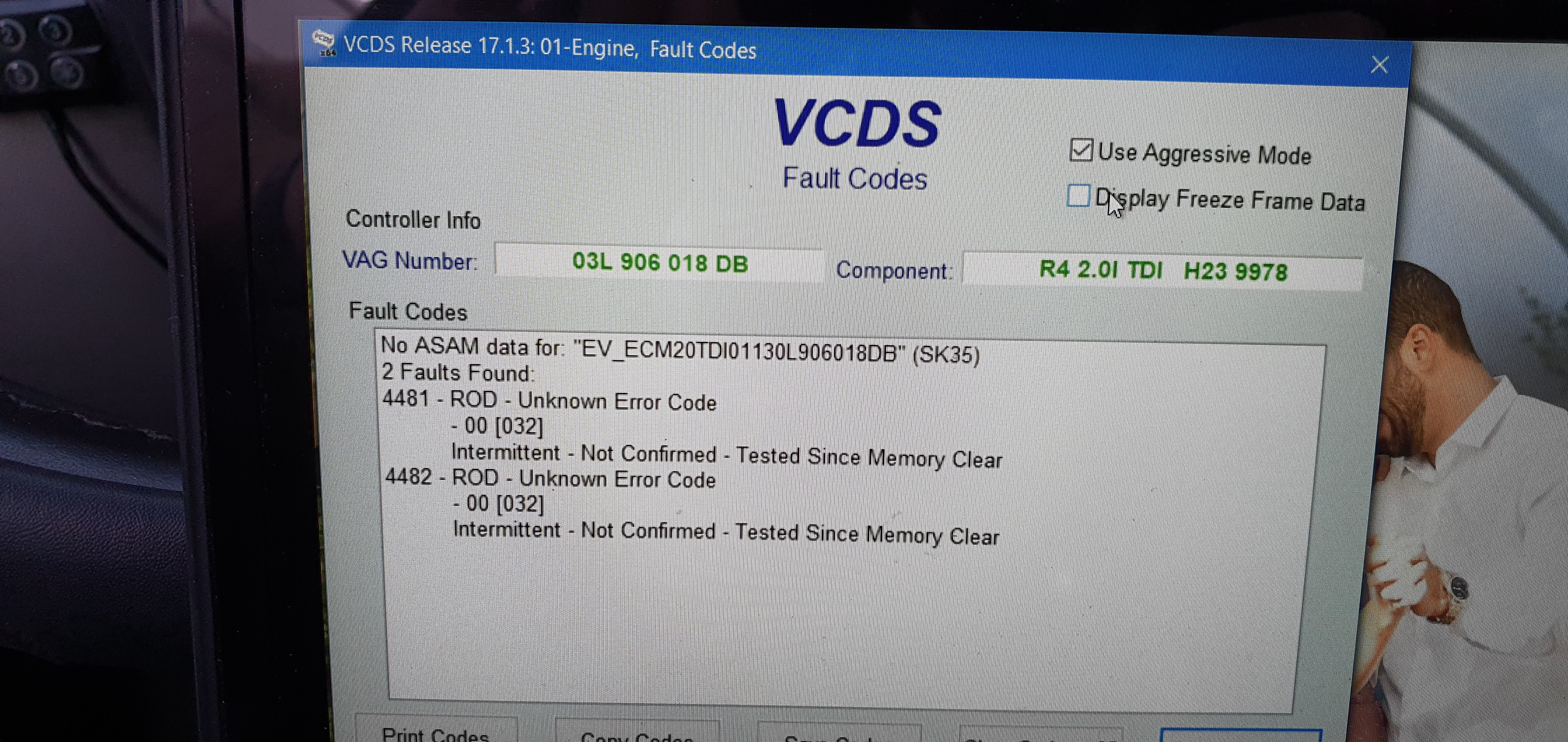

5) using VCDS, i have activated the CCS in 01-ECU and in 16-Steering Wheel module and activated CCS display in 17-instrument.
I still get and error in ecu: E45, implausible signal.
I think this car need a wire from SWCM TO ECU.
Can anyone show me how to do it ? Using videos or pictures to help ?
Anything you need i can provide.
Apparently the car electricians are not professional enough to do this and i really need CCS in my car.
Thanks in advance

Thanks, i did find a video about adding the wire from T16 pin 05 to T94 pin 64, using VCDS  i checked the ccs buttons and they do work. From the Steering Wheel Control Module, the ecu is still having a DTC, cruise control set signal. I was adviced to replace the BCM, The one i have is 1K0 937 086 H, but i do not understand how the BCM is related. Maybe it's a hussle but i do need it. Any advice?

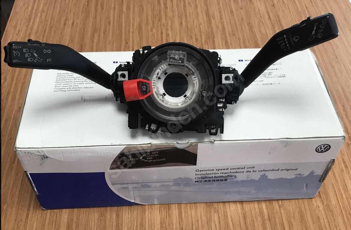

There is no rocker switch on the end of the wiper stalk, do you have MFSW?
So should I look for a CC stalk without the rocker on the end? I have a three spoked MFSW with Maxidot.
The rocker on the left stalk is for setting speed, speeding up, slowing down and to resume cruise control speed so how is that going to work without the rocker?
Edited by Urrell
You have MFSW, therefore you don't need the rocker on the right stalk.

Hello guys, i think it comes down the Steering Wheel control module, the 513M fits an older model, mine is 2011 and it uses another codes, the slip ring on your 2012 yeti is 549 while mine is 569, still i do not know whats wrong, all the signals work, the buttons of the cruise control work fine, only weird thing is that the accelerste button works but does not SET speeds, and the error i ak getting is Cruise Control Set Signal. Maybe there is a wire that i should connect other that T16/05 to T94/64 ?
