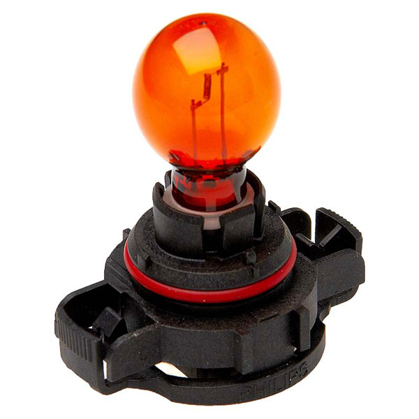

The reverse light looks like a  P21W / 382 bayonet straight pins.
The rear indicator bulb looks like either a PY21W / 581 bayyonet offset pins.
The front indicator bulb looks like a WY21W / 585  wedge type. (and look a pain to get to)

The front indicators are definately filament amber glass, and , I will see if I can get to it so I can double check the type,  it looks like a Philips PSY19W
In the owners manual it shows the same bulb type, but says to pull the bulb straight out of the holder, as normal for Skoda they skimp on specific bulb codes as if it is some secret that only Skoda should know about, very very annoying.
