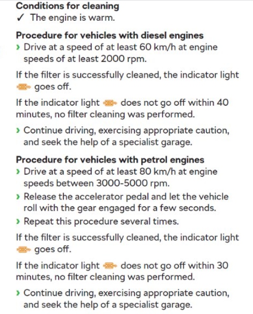

So being a 1.5tsi it has a GPF.  They got them before the WLPT /RDE was introduced.  (As did 1.0tsi )
Edited by e-Roottoot
I had no idea that petrol cars had a regen!
