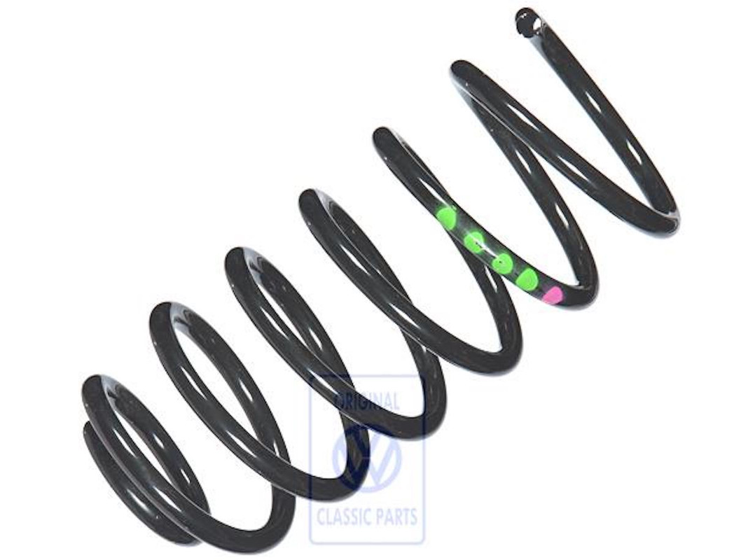

The factory springs have coloured paint splodges on them which can be helpful for identifying which part number you need (if you still have a factory one(s) fitted and the paint hasn't worn off).
Like this....
VW-Golf-MK4-Bora-New-Beetle-Coil-Spring-
Edited by TMB
Like this....
Thanks,
Yeah I know about the paint splodges but I can't see them on my original springs so I'm guessing it's been worn off :/
