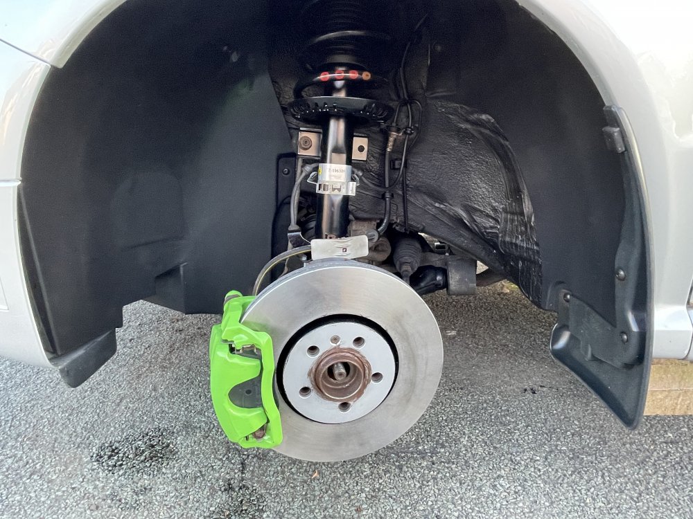

Just been doing wife’s Vrs ( all standard) and just put this side back together with a new disc shield fitted also.
question, should it be bigger than the disc and slightly visible ( old ones missing so can’t compare)
Starting to think TPS may have given me the wrong ones
Any ideas
cheers
Looks like they gave you 256mm shields instead of 288mm.
Thanks for reply, looks like it to come to bits again 🙄

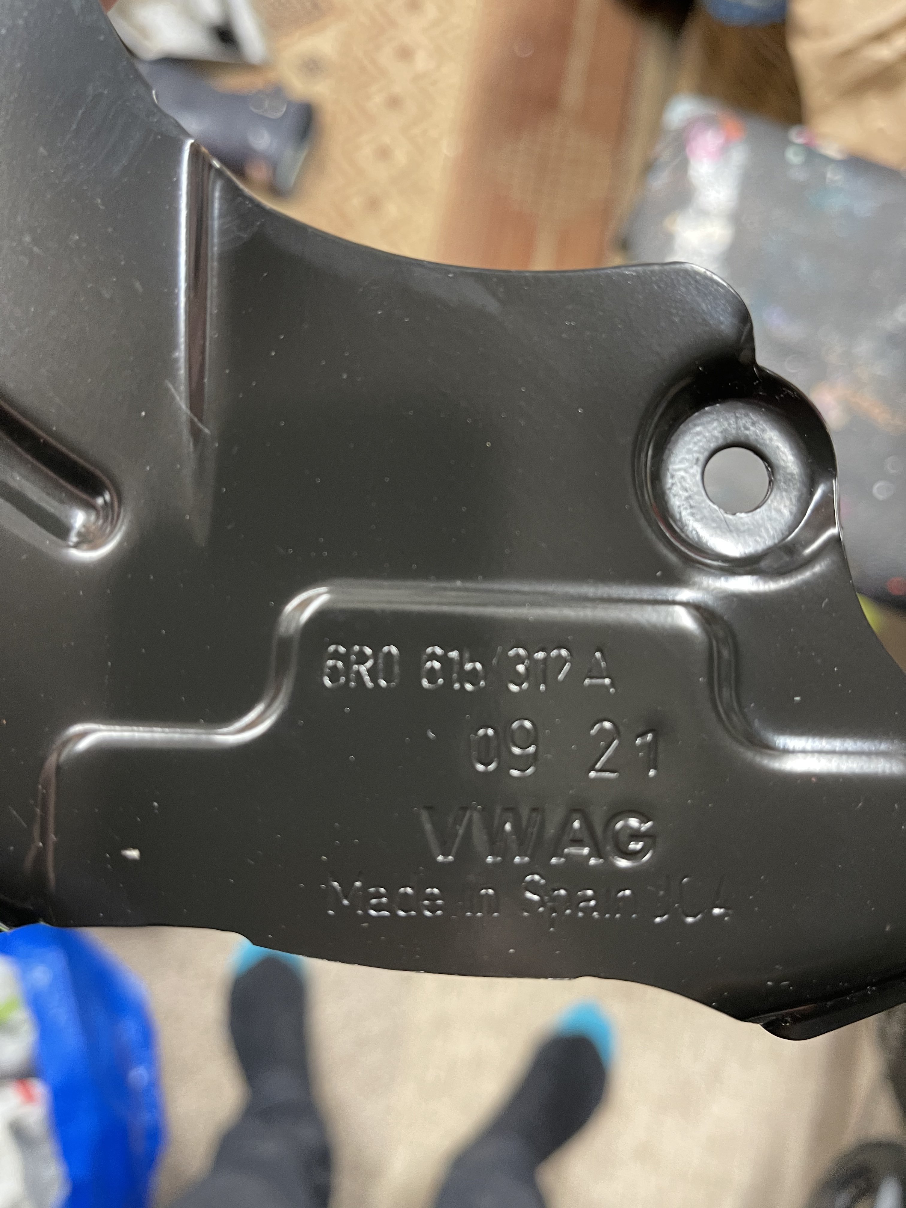

Thanks for that cheers
Yes it’s 2005 and this is pic of the the o/s front yet to fit ending 312A so now unsure if correct or not 🤔

Same shields fitted for 239, 256 and 288mm brakes.
Thanks
So they are the correct ones then for 288mm discs and not visible
  • Sponsor
Apparently, yes.
3 hours ago, Wino said:
Apparently, yes.
Thanks for reply and TPS have said they are the right ones
