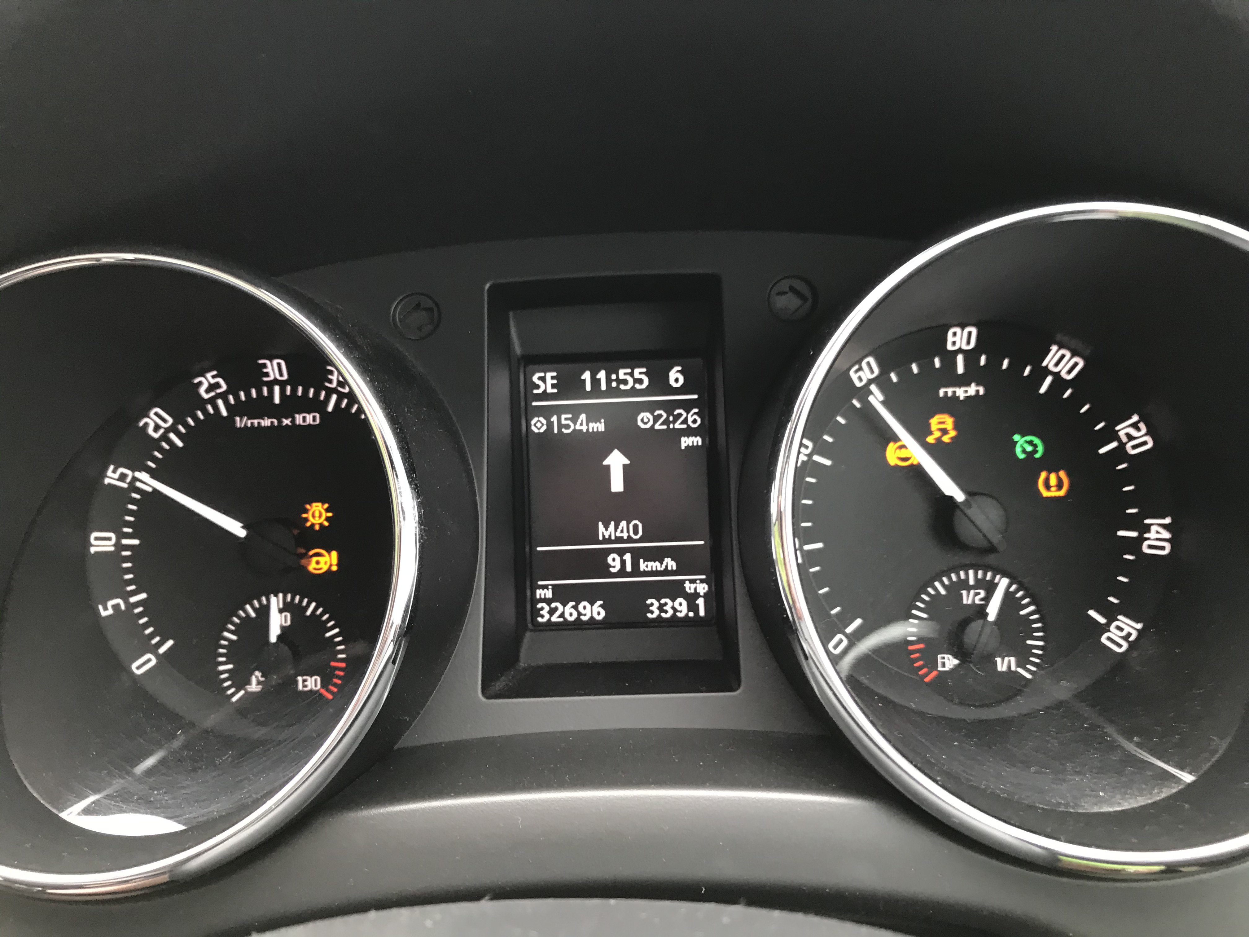

Hi, travelling on holiday today and moments before arriving at our destination we had the dreaded bong from the dash!
the following lights came on;
Brake system
Power steering (although only half the little wheel icon lit)
ASR /ABS light
Lamp failure
Tyre pressure warning
All a bit alarming but the car was running perfectly and chanced the last mile or so.
went back to car after leaving it stood a while and now lights are out.
Has anyone else had this happen, and if so, what was the cure?
many thanks

presumably like this?IMG_3467.thumb.jpeg.fc21c313c69f696e0f1b757732bab9ab.jpeg
Give it a brake test, if ABS does not cut in then you can be sure its a fault in that system, probably a wheel sensor.
Then you can make an informed decision whether to carry on driving or seek a repair, only you can decide that.

lol...the reason you "think" only half the power steering light comes on is because part of the light is hidden behind the speedo centre "button"... :)
Hi,
Yep, just like that!
