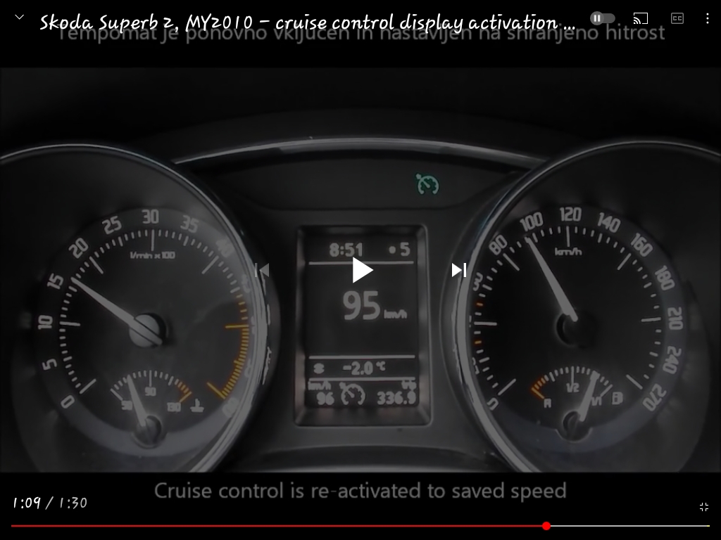

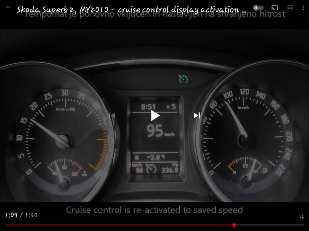

Just found this on YouTube. MFD display bottom left shows cruise on and green indication top right above MFD. This is an identical MY10 dash as mine.

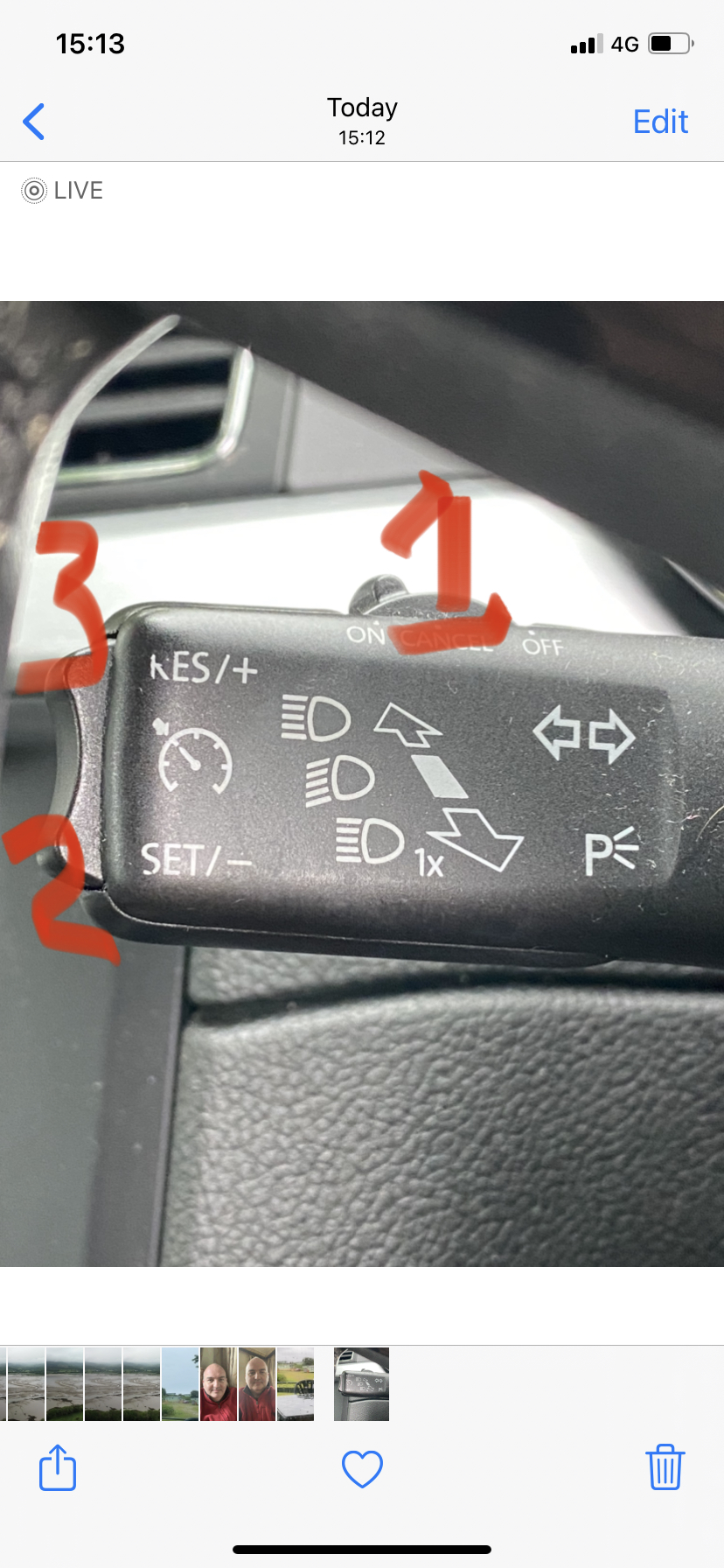

Does your stalk look like this?
1 - on off switch
2 - set/reduce speed (this is when the green icon appears)
3 - restore/increase speed
i leave 1 in the on position at all times. Press 2 when I want to set cruise control on. I press 3 when I want to speed up or restore cruise to the previous speed.

Yes, my switch is identical to that. I know how to activate/use it, as I previously mentioned it's the same system as fitted to my MY08 Passat. You press 2 it sets the cruise, if you brake and press 3 it resumes the set speed. If you press and hold 2 or 3 it will increase or decrease the set speed until you let the button go.
