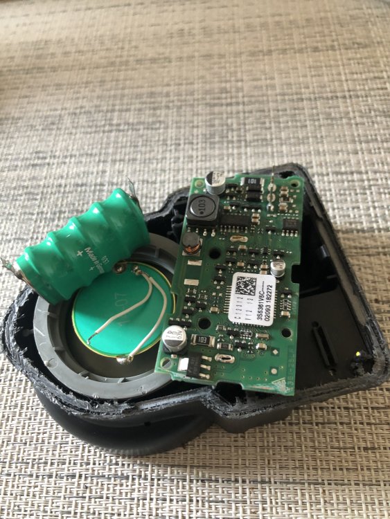

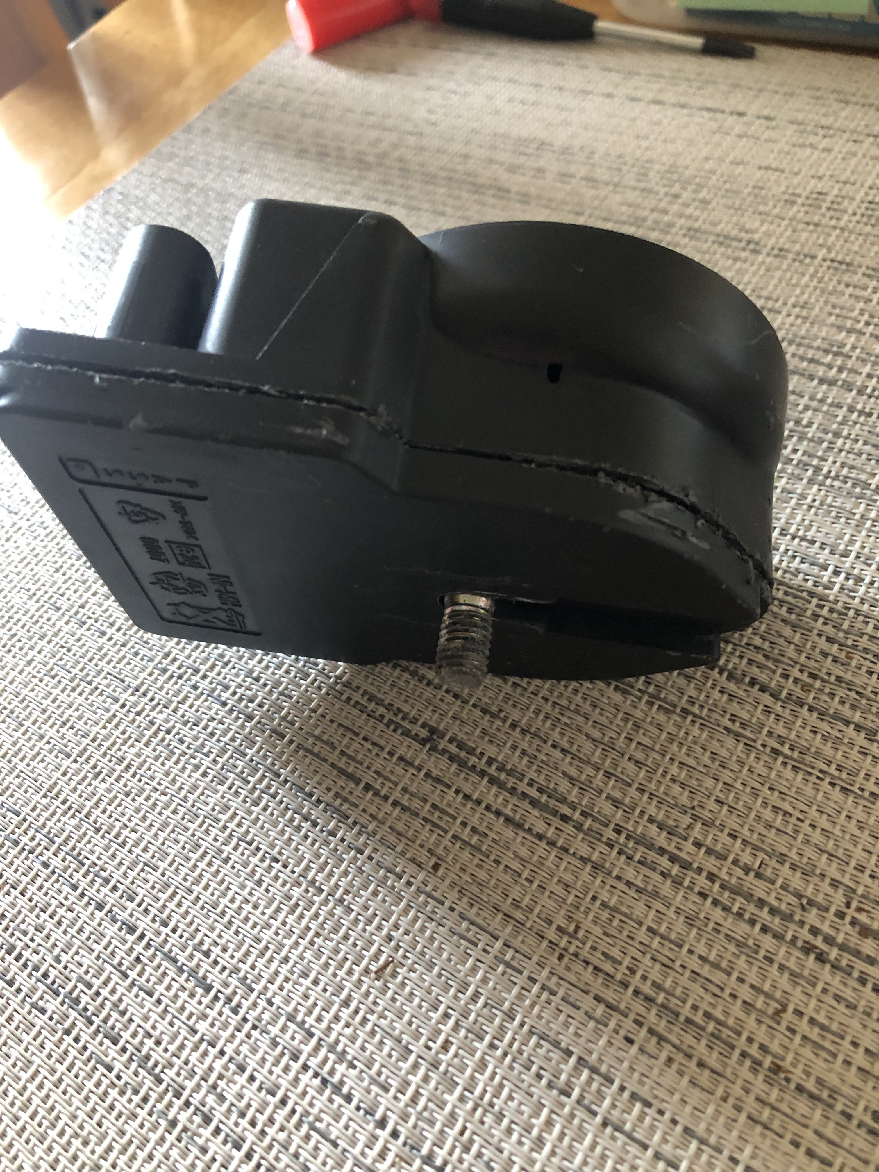

It’s under the lining, rear end of the n/s wheel in a metal box, The Easiest way is to remove wheel and lining, remove bolts to alarm box and bend the box down, no need to cut it.
Edited by Morph
Thankyou pal  il buy one one

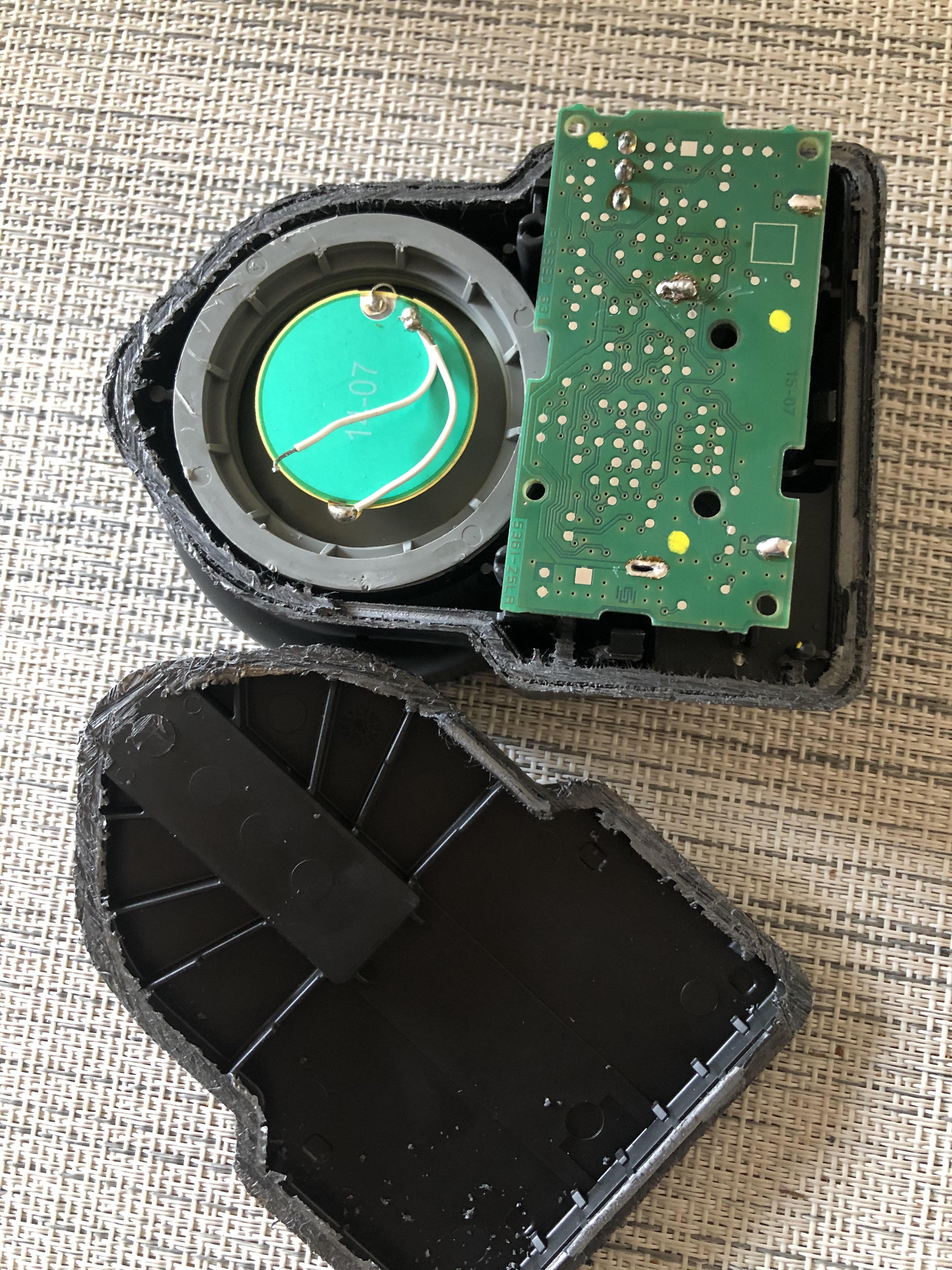

You can cut the alarm open and do a battery replacement if it just that or buy a new or second hand one
When I say no need to cut it I mean the metal box it sits inside as it just bends away but you could carefully cut the alarm open as said and shown above
