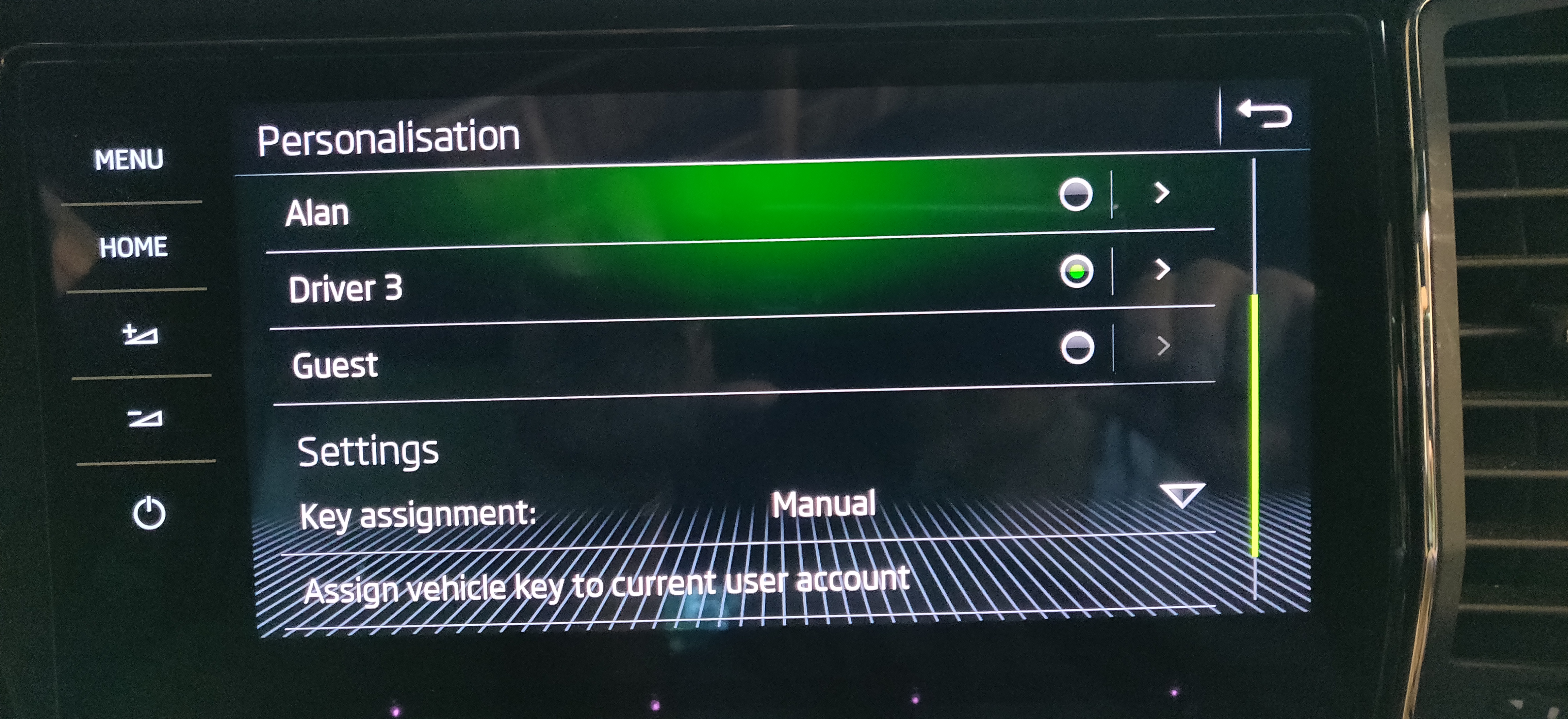

I find that it's best to have the personalisation set to manual, then after you make an adjustment select key assignment to store the changes. I think it asks you to press a key on the fob to confirm. This way you don't find that changes are being saved that you didn't intend.

Thank you All for your support....
After several emails.... With Skoda UK...  The computer needed an adjustment...  All working now.
