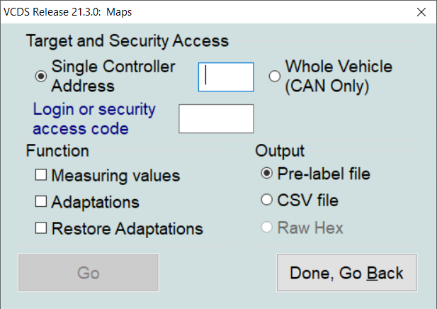

From my understanding of your issue,  you need to change the ESI adaption channel "Oil quality" adaption back to "Good Oil Quality" to get variable oil distance back but there may also be other adaptions that need to be changed to get the days right too.
Control Module 17 will be "Instruments" open and look for Adaptions and put in the search box Oil, click on the drop down and it should find the channel in question.
Attached you will find my Admap of my 2016 TDI before I had it put on fixed interval oil changes. If you open this in excel and look at line 27 you will see ESI oil Quality and also listed will be miles to next service etc yours may be different so I attach as an example.
If you want to get this file yourself from VCDS, run from VCDS then open, Applications> Controller MAPS, tick "Adaptions" and put 17 where it says Single Controller Address,  it will output the below file into the VCDS LOGS folder on your laptop.

You need to change the oil quality and then go through the SRI/FIX/ESI channels and set them to what you need.
Definitely take a 17 adpmap before you start just so you know where you started from...
One thing i forgot to add,
In the Controller Map application, you need to tick "adaptions" box before asking it to create the Admap. This outputs all the adaptions into the CSV file.
As @langers2k mentions the Admap is a backup file of any changes you make to Adaptions.  Do one before you make the changes.
