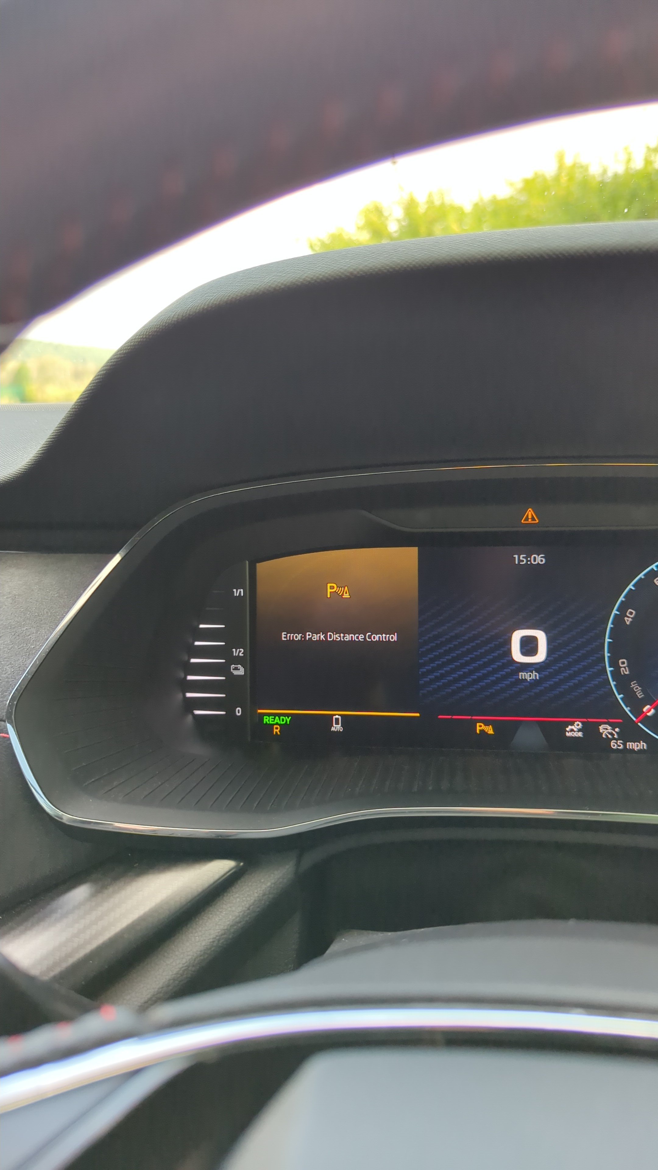

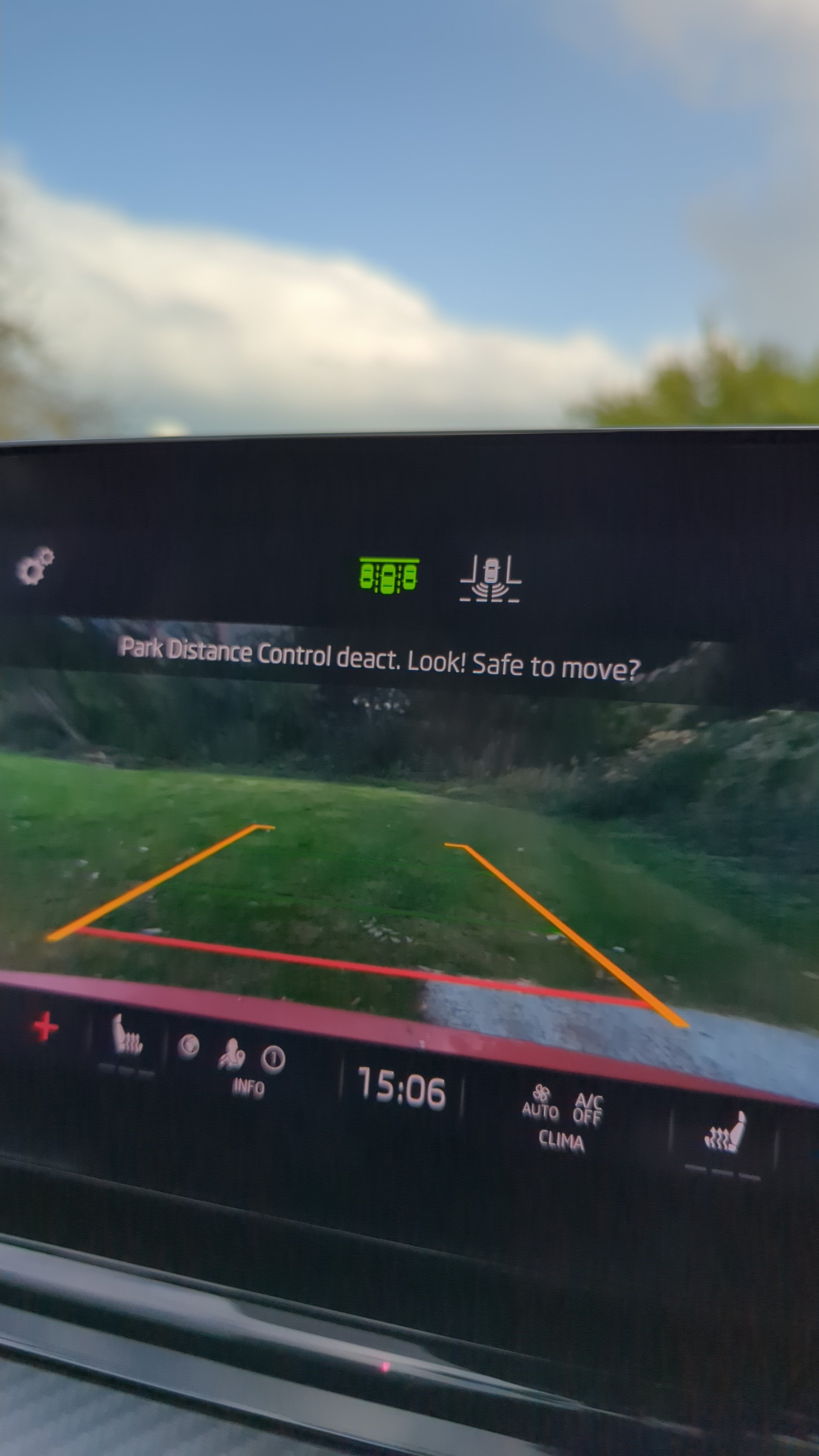

Hi all,
I'm also suffering with the loss of audio on my 2021 MK4 VRS. Now onto day 4 with no audio, but oddly. No Parking Sensors either?
I've attached some pics which is what appears. All very odd!
I spent 2 hours driving to DM Keith Leeds and Wakefield, looks like over a 1 week wait to be seen and they still want to charge me a full fee for an alleged software update (Although the car was sold to me with a 2 year extended warranty)

On 23/09/2024 at 11:43, AntBoii said:
Hi all,

Shortly after this, the 12V battery died and Skoda assist had to come out and give it some juice. After they did, the audio and parking sensors returned!
However I was still booked into Skoda, so it went in yesterday, where I was charged £153 for two software updates...
- One for the Infotainment Screen
- One for the HV Battery where apparently if you charge the HV Battery to 100%, it drains the 12V battery.
Contacted Skoda Customer services and after being passed around like a cheap date.. Finally managed to get my £153 back!
