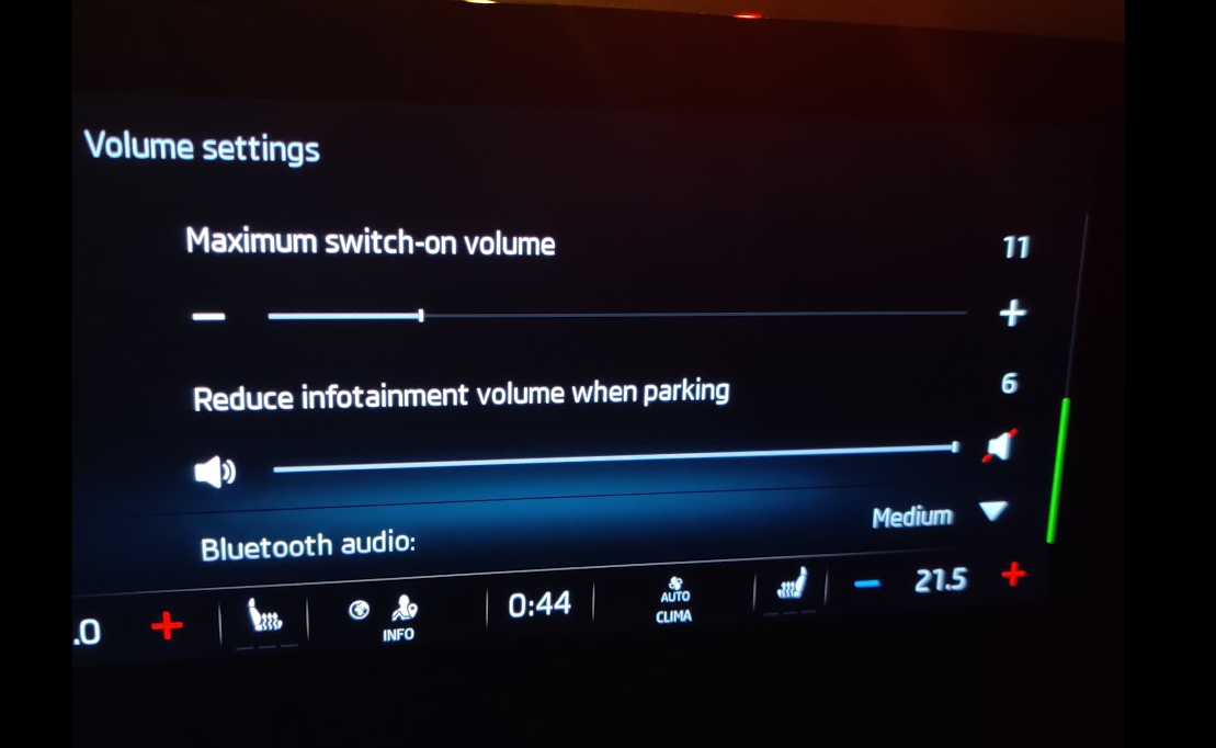

I did some reading, couple thing i found, that might cause this:
system went into mute, because of parking, incoming call, or android auto something, or even voice assistant, and system could not unmute itself for some reason.
so in case this happens again, disconnect phone, or leave it at home,
check voice assistant again,
check parking mute settings, there is slider,
I strongly believe removing fuses is not the way to go, that i would leave as last option.

Hi guys. Same thing happening to me. What do you need to do with volume slider regarding parking mute? Turn it all the way off I assume?

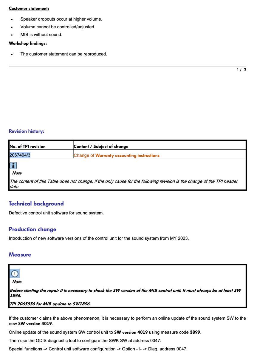

If you've got the Canton sound system and have these audio drop outs then you likely require the sound system module to have its firmware updated.
Affects cars that are 2022 and older.
Here is a snippet of the TPI:
Screenshot2024-05-06at12_16_53PM.png.07514bfecdf8d2df37a8f7a1558870bd.thumb.png.60ae22d4009efed2a82a2a23276b582b.png
Similar issues have been affecting the entire range. The Kamiq I traded in for my Octavia had the same issue and it had the upgraded Skoda Sound System.
Thanks! Just made a booking to dealer . If there is an update will take some time to confirm if the issue persists as I have the issue from time to time, not very often.

Got the same update as you, 4019 from 4015. So far no issue with the audio for a week. I don't know if only seems but I am almost 100% sure the Canton sounds better after the update.
Have you also noticed some changes in audio quality?

I've faced this issue on a few occasions, I have a 2021 Mk IV with Canton, is this update still relevant do you know thanks?
This update worked for me facing same issue as you before, moreover improved Canton audio sound and it sounds noticeable better.
More than a month and 3000+ kms and audio did not go away since than.
Thanks @axw, I guess back to the dealership for yet another software update then lol.
Let me know if you experience same positive changes after ver. 4019 audio update, thanks!

Apologies for the late response, it was only an intermittent issue so I was waiting for my next scheduled visit to the dealership.
However the issue came back and this time seemed persistent over 2 days, I had to work for the next 4 days with no need to use the car.
When I came to use the car, the battery was completely flat, this has happened once before, also while there was no audio.
I called out Skoda assist who have run the update so will see if this solves the issue.
With regards to the audio, I do feel it sounds a little better, but possibly also slightly quieter at the same volume level? I've only been for a short drive since so far though so I haven't tried many different tracks.
