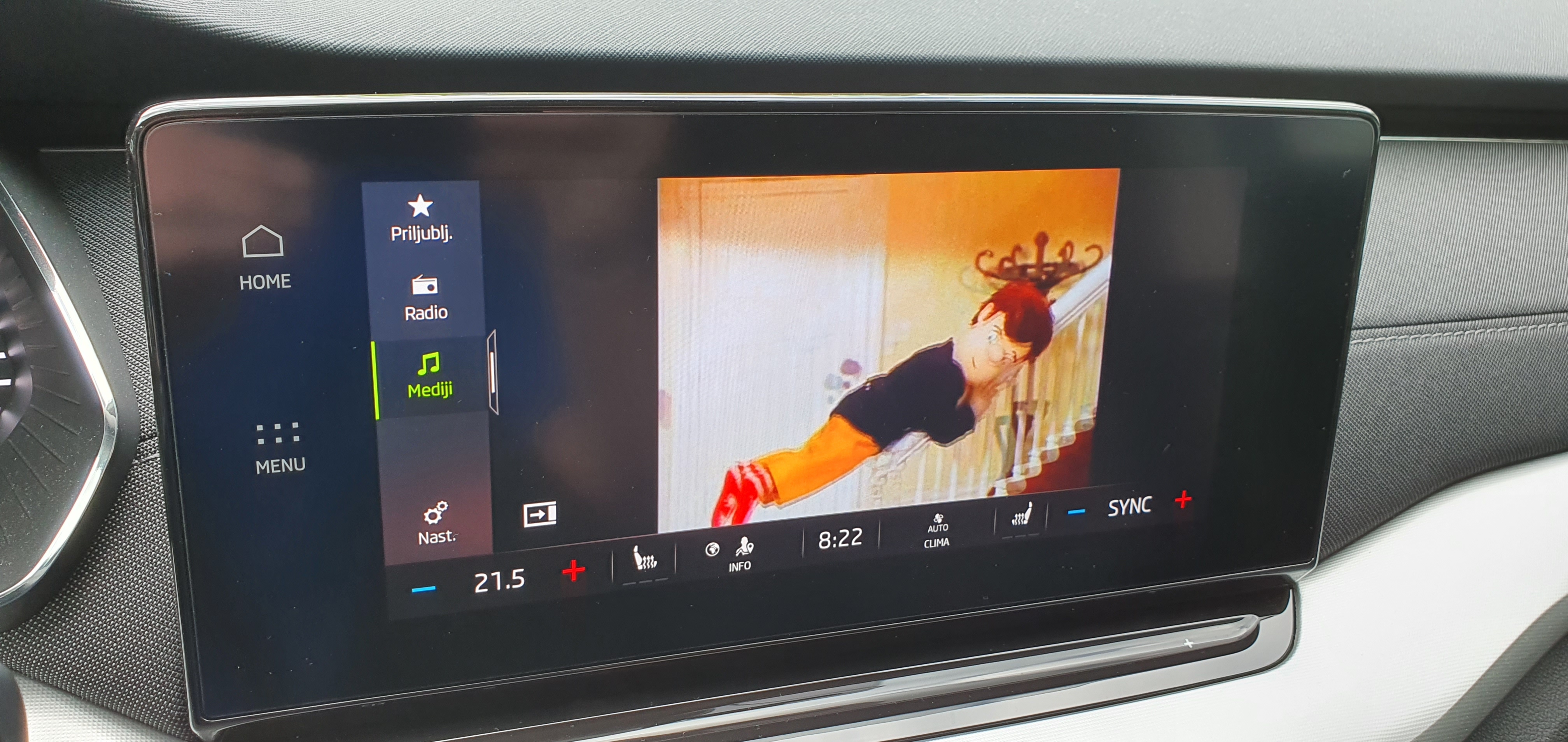

It is working for me. But video is a bit hiden. You need to swipe left after you click play.
Igor from MTL was not able to unlock video in motion in my car.
so video is working (while car's stopped) without any coding?
Jup.
Great...
I will ask Igor from MTL next time and we will see if video in motion could be unlocked - my SW version is 1803.
So, did you need to change files according to video from Igor (MTL) or the only requirement is x264 codecs?
I used Handbrake to convert videos, because some were playing without sound.
Can you make me screenshot what settings exactly did you use..
I was following the instructions in MTL video which you already posted.
Thank you for the hint..
It is working for me..

Hi there. Realise this is an old thread, but do you know if it's possible to switch to full screen (i.e. without the media menu on the side or the a/c menu etc at the bottom.)
I've played with the settings but not worked it out.
Cheers!
Probably not. My goal was to play video on looong trips for kids.. so never played to hide other inf. buttons..
Thanks. Seems a shame for all that screen real estate to be wasted. But never mind...
