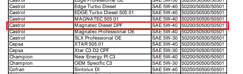

Interestingly, if you look up the oil you have in the engine now, on erwin skoda's approved oil list it is rated as 505 00 / 505 01, just as Castrol claim, but if you look up the same oil on an older version of the same information, it also shows as 502 00 compliant (502 00 being the petrol engine standard), so I expect the main change is in the way VW group wish to label their oils now.  Only one oil is shown as 502 00/ 505 00/ 505 01 now, where there used to be a whole table-full.

On 01/07/2021 at 16:11, Wino said:
505 01 has special additives to solve cam wear problems that became apparent on the PD diesel engines when they were getting 505 00.  The same additives are probably good at protecting timing chain components, but I'm not a qualified tribologist, so cannot  promise this. @weasley may have suitable knowledge, if he chooses to comment.
Saved info:
Check this out, I downloaded two PDF´s with the characteristics of the oil, in one like you posted in the image above says is compliant with the VW 502 00 specification , in the other only says VW 505 00/ 505 01 , but in the technical characteristics  like viscosity index gives different values. This means that are not exactly the same oil?

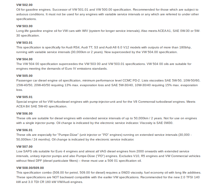

This might be useful for those looking at this thread in the future.
How old is that?!  It mentions CCMC PD-2; CCMC was replaced by ACEA in 1996!
It is as recent as 2018 since it includes VW 508 00 / 509 00
