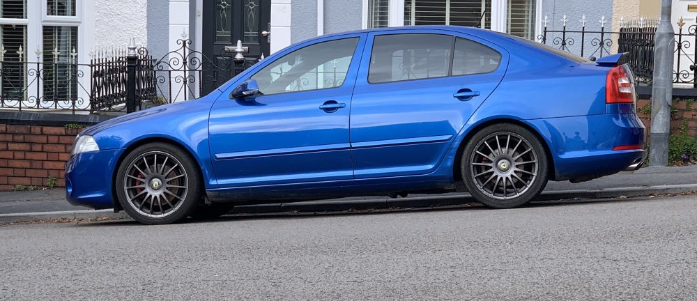

(Pic of my car below…..if I can work out how to upload)

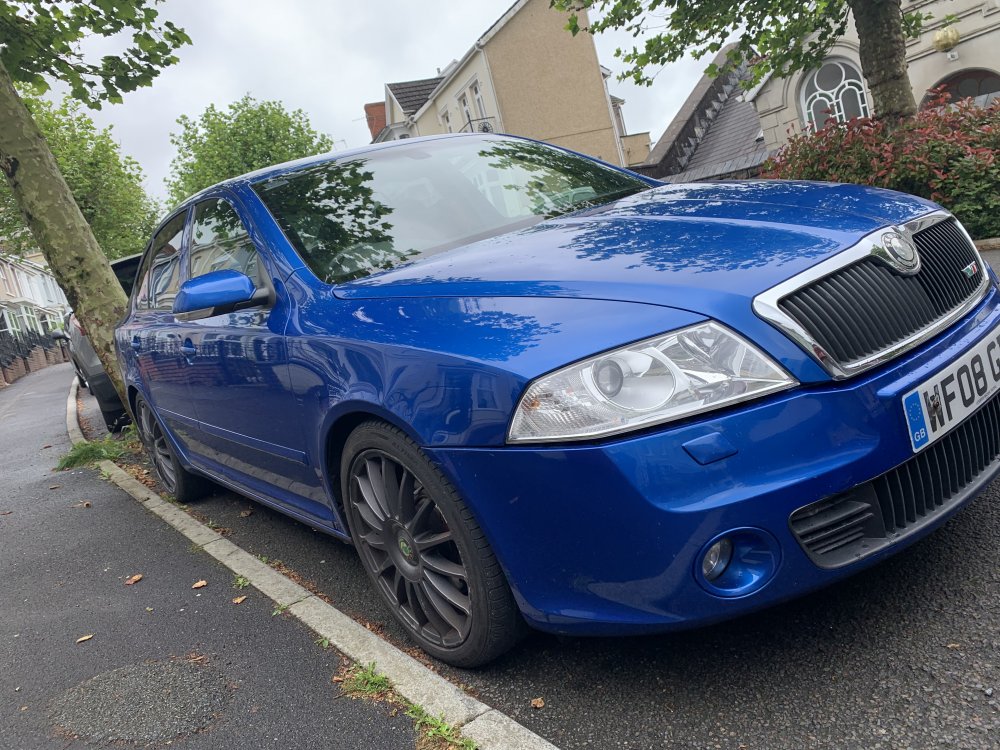

I’m probably in the same boat as my OSF wing has a crease but my OSF bumper sags towards the edge (pic attached), so I may well need to replace some brackets as it looks like it’s been bodged on at some point, with some washers propping it up etc.  I’m also missing one of the headlight retaining collar screws and nut so something has happened previously, think it will be one of those when I dig i’ll keep finding too.
