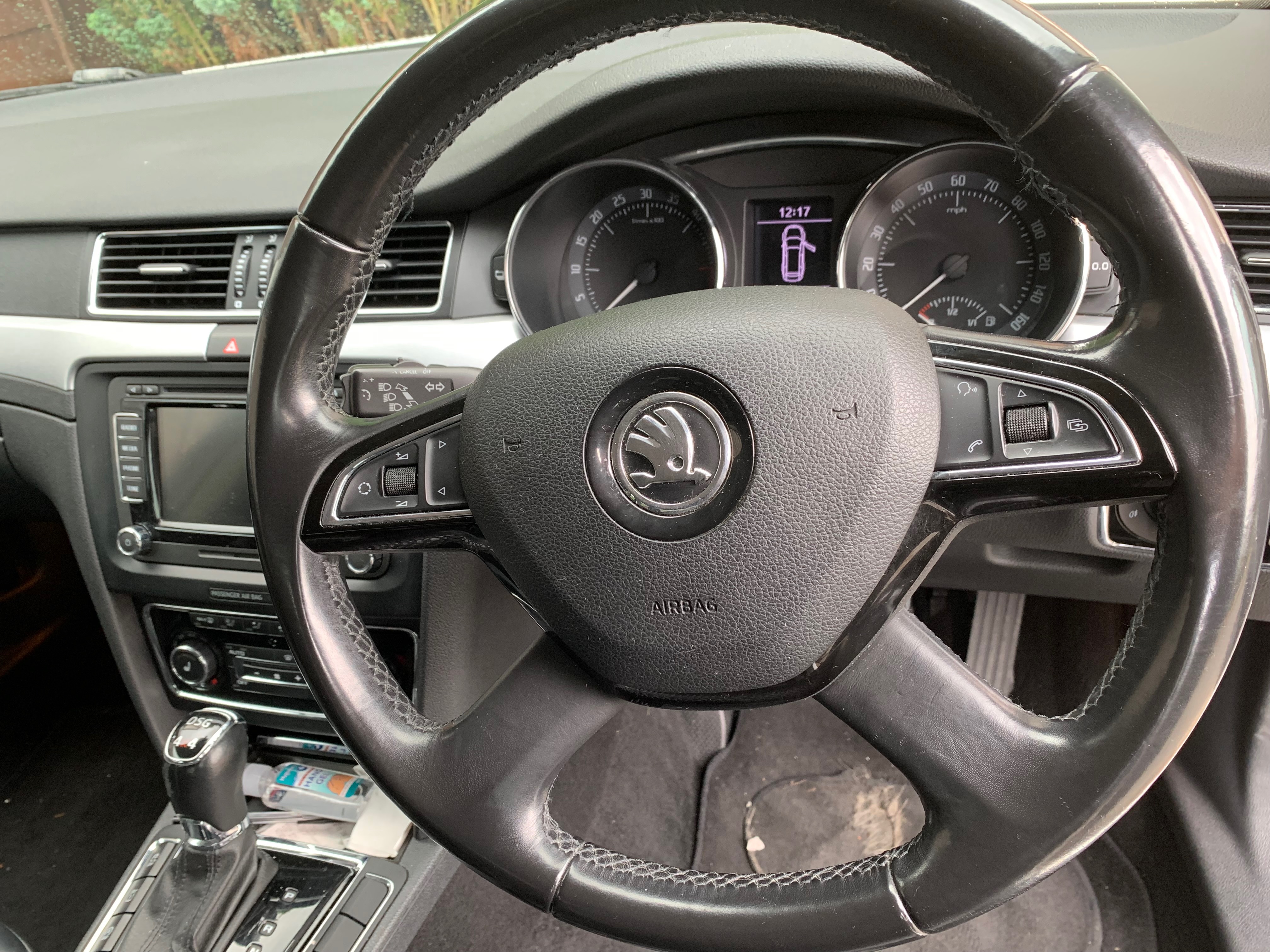

If it's a MK3 and you have buttons on the wheel then it should work fine. I have one you can have for postage plus some beers if interested.
no mine is a mk2 from what ive been told, i was lead to understand that fitting it would work once its been switched on in the ecu, friend of mine as a 2009 maybe 2010 and he as done his, can you send me some pics over of ya wheel pal?
A wheel from a MK3 won't work in a MK2. The MFSW butons aren't compatible...
You'll need a either a MFSW wheel from a MK2 or to change the buttons to a compatible version.
Have you got a VCDS autoscan from your car? If it hasn't got a MFSW fitted, you'll probably need to replace the steering controller too...
