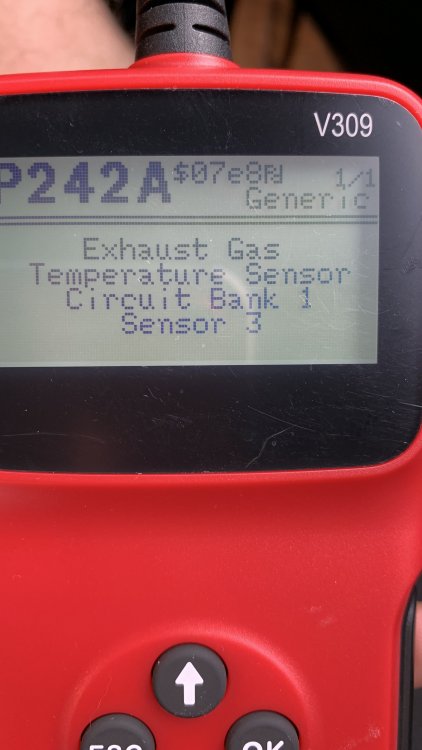

You need to know what sensor it is. There’s at least 4 egt sensors

Bank 1 sensor 3

The one under the cat

No it’s under the cat that’s on the left. The one circled is sensor 1
I can’t see any wires or plugs in that area. Got any pics of where it is? On mine I can only see 2 plugs/wires. One that’s goes to the sensor that you can see on top and the one I circled.
