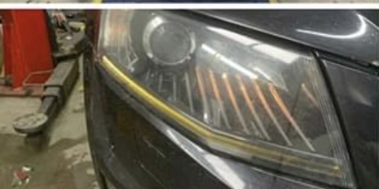

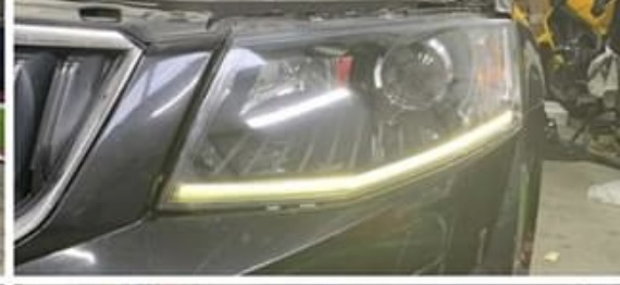

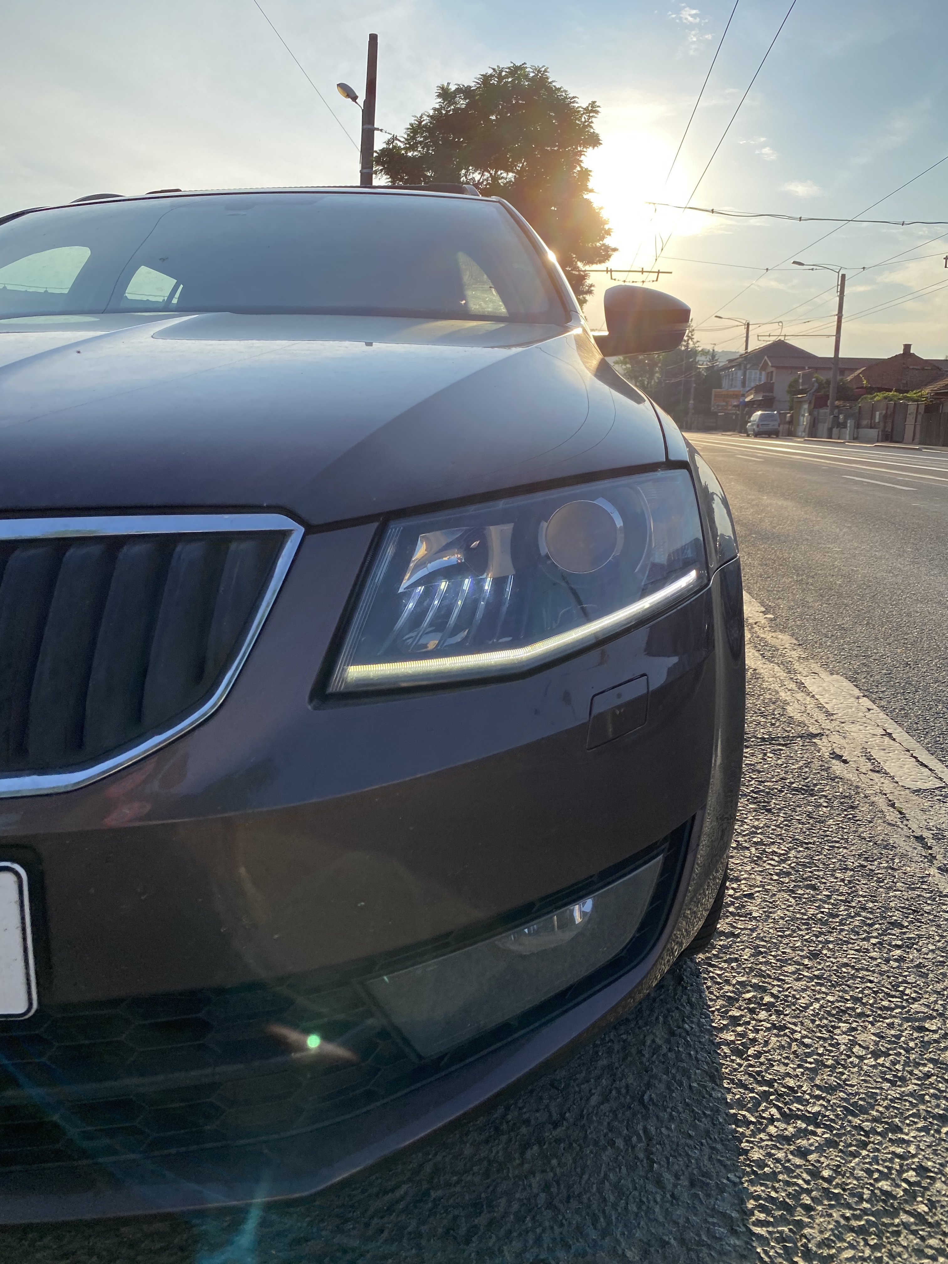

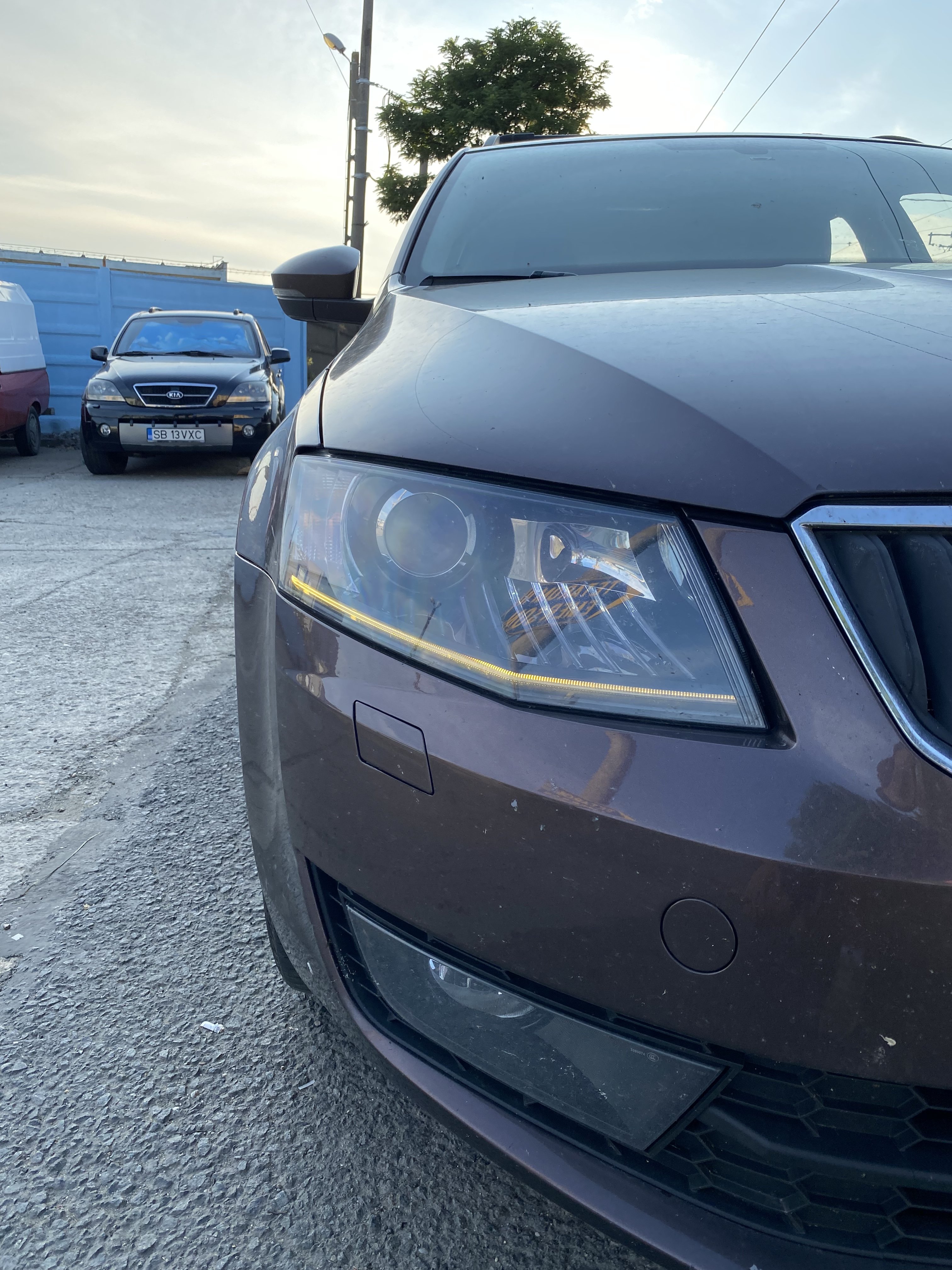

Today I found out that my left side DRL turned yellow. The right side DRL is white. Any fixes besides changing the whole headlight? I heard some people that are repairing this thing but I am looking for a DIY tutorial. Thanks in advance.
Two thing: if you have a bulb for your DRL's (on S, SE, SE Business specs), then it is just a bulb replacement.  If you have an SE-L, Scout or VRS, then you need to get the dealer to look at this as this sounds like a problematic LED panel for the headlights.
Check the condition of the front of the headlight - and if the front headlight is yellowing, then you need to clean and restore the headlight as appropriate.  I personally recommend AutoGlym Headlight Restorer.
Thank you. But I am talking about Octavia III Pre Facelift.
Only left one is yellow
This is my car now.
The LED DRL is dying.  Sorry - either new DRL unit or new headlight unit reqd.

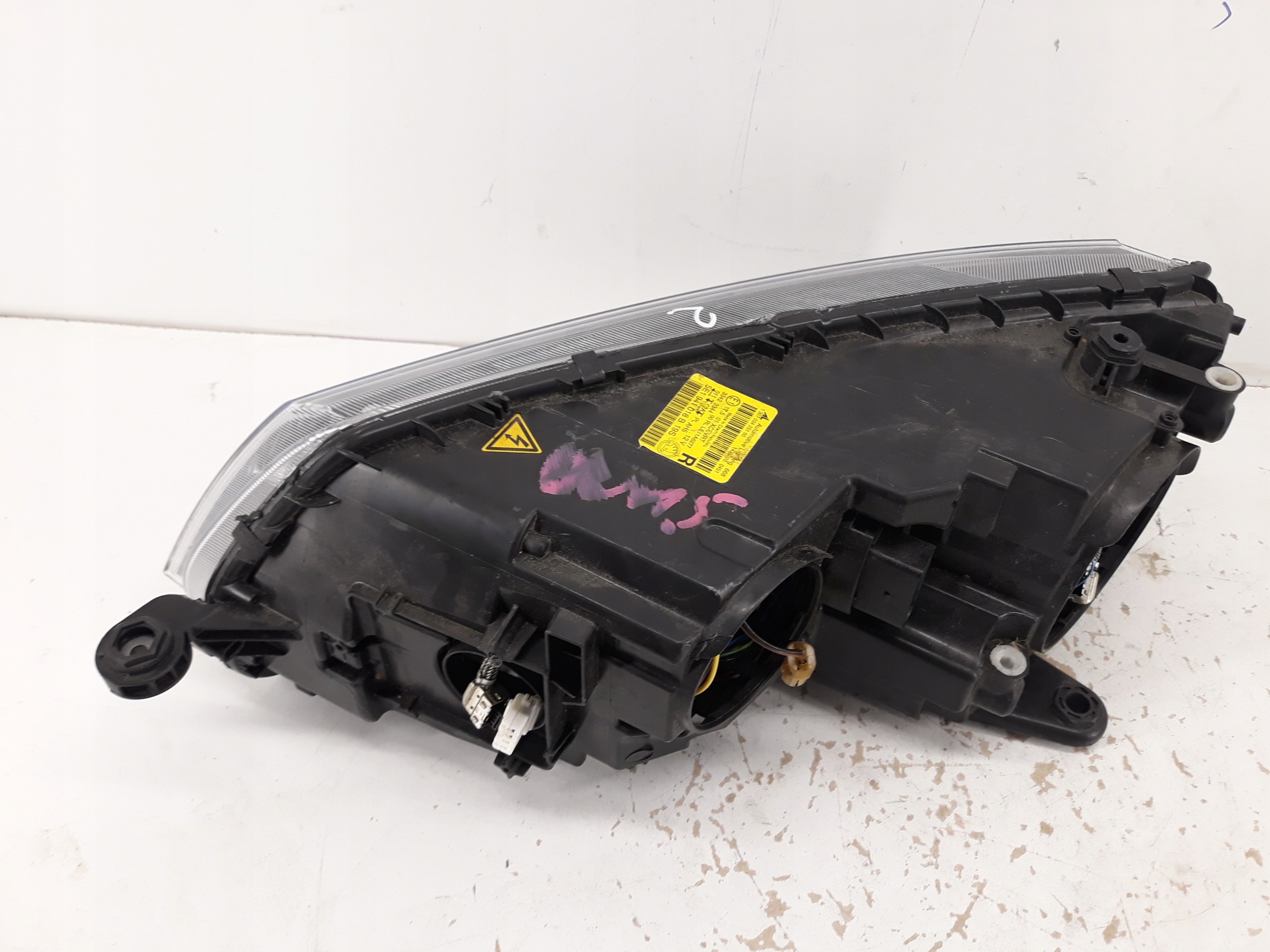

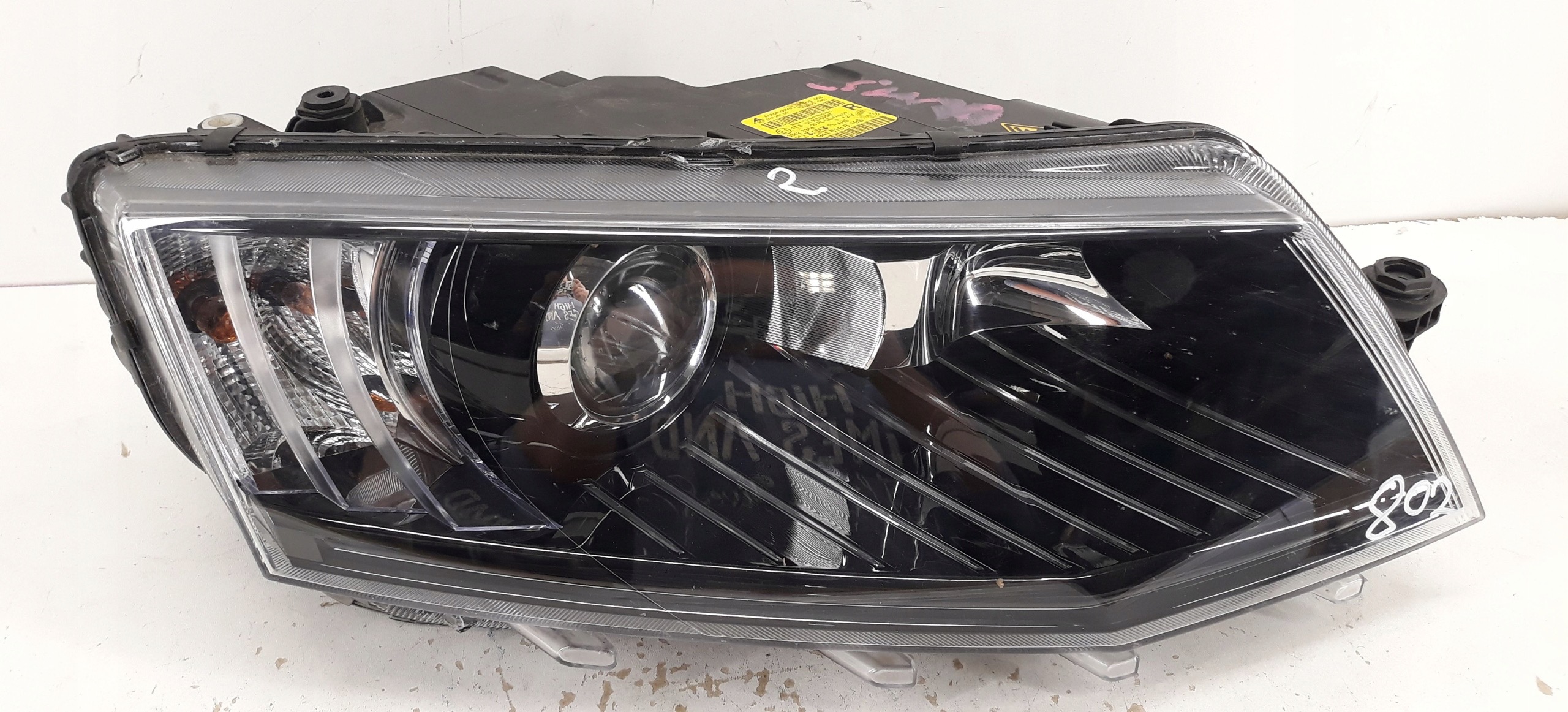

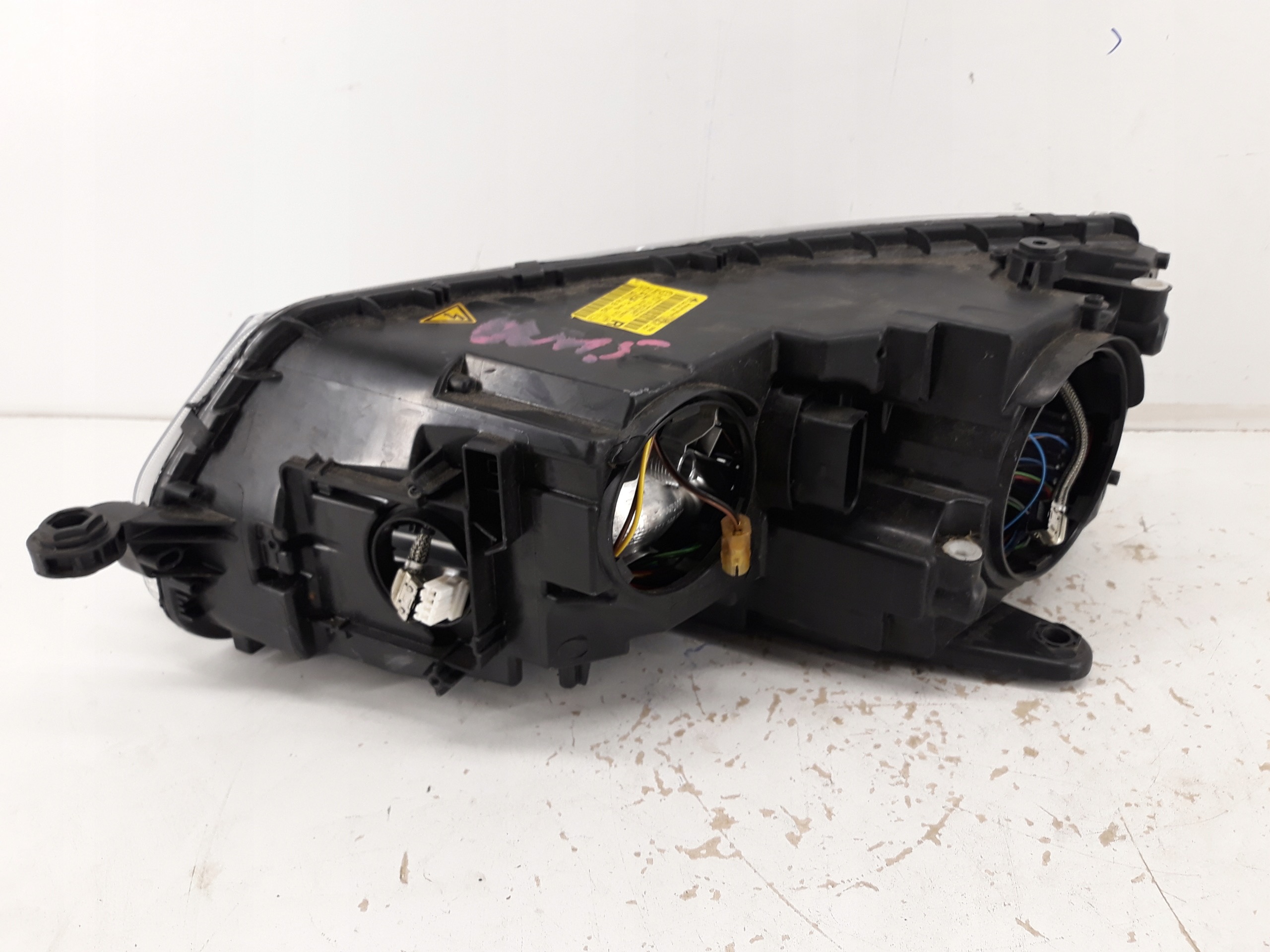

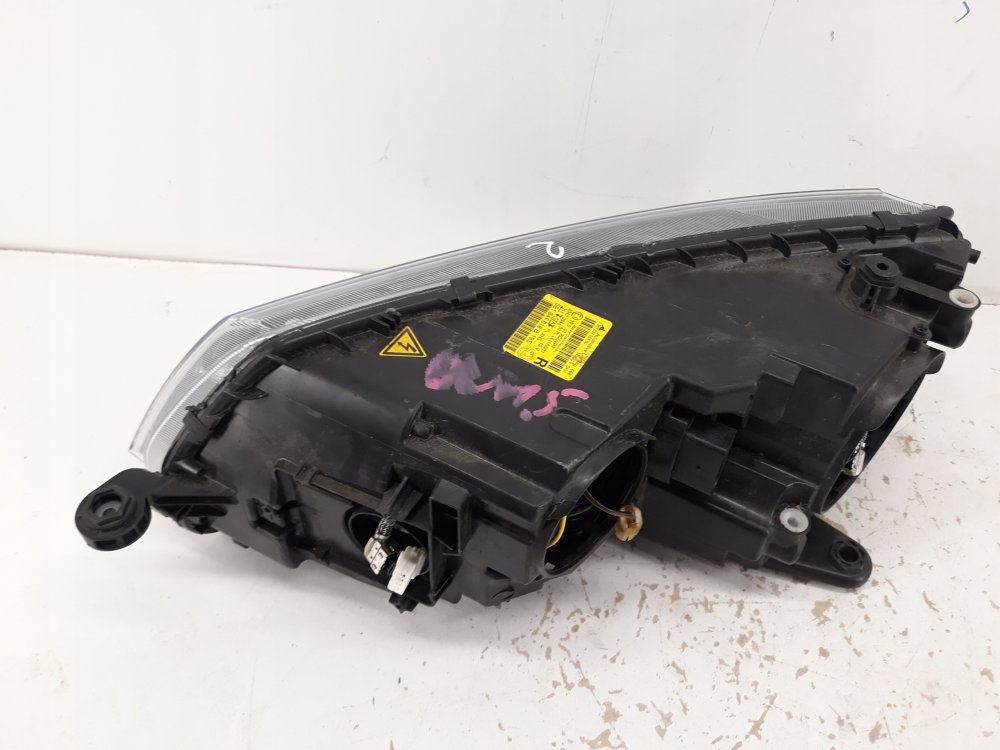

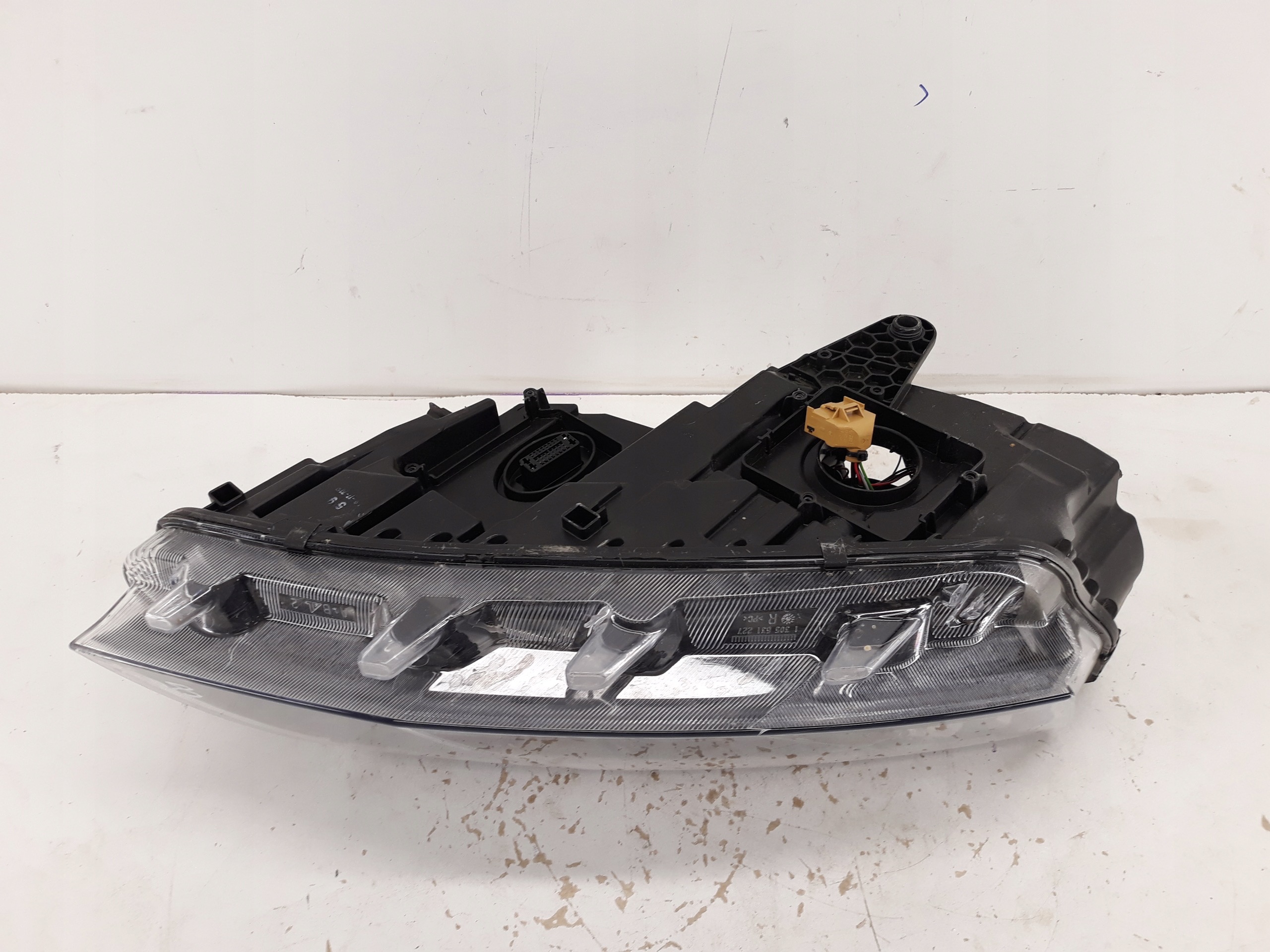

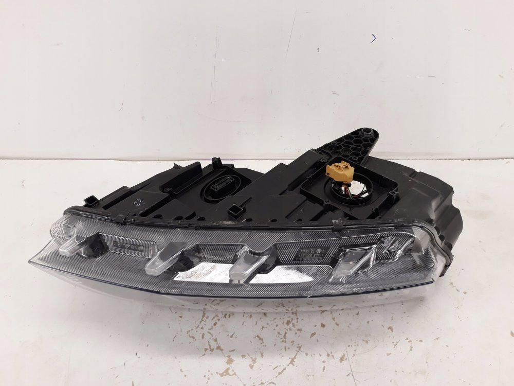

Good evening, @fr1nklyn and @varaderoguy. Please guide me in the following purchase. I found a really good headlight 2020 production date, but it is naked. I mean look at the photos. How can I be sure that the DRL line will be white? The seller can not provide me a photo. The DRL is a separate module or it is built in the headlight? This is not clear for me. If the headlight is relative new the DRL should be fine, but I do not understand why the seller can not test the headlight to show me if the DRL is working. He is saying that the headlight is naked and he can not test the module.
Edited by sebic98
@sebic98 See the link to the pdf shared in the other topic - LED Control Module 2.pdf
Number 4 is the control module. Each headlight has its own one. Try to swap the control module on your headlights and see is the DRL yellow on the other headlight after that.
If yes, it’s from the control module and you don’t need to buy a headlight.
If the same headlight still has yellow strip, it’s from the headlight itself and you need to replace it. But just in case talk to the seller to return it if it doesn’t work.
Don’t buy it unless you’re sure it’s from the headlight, that’s my opinion.
