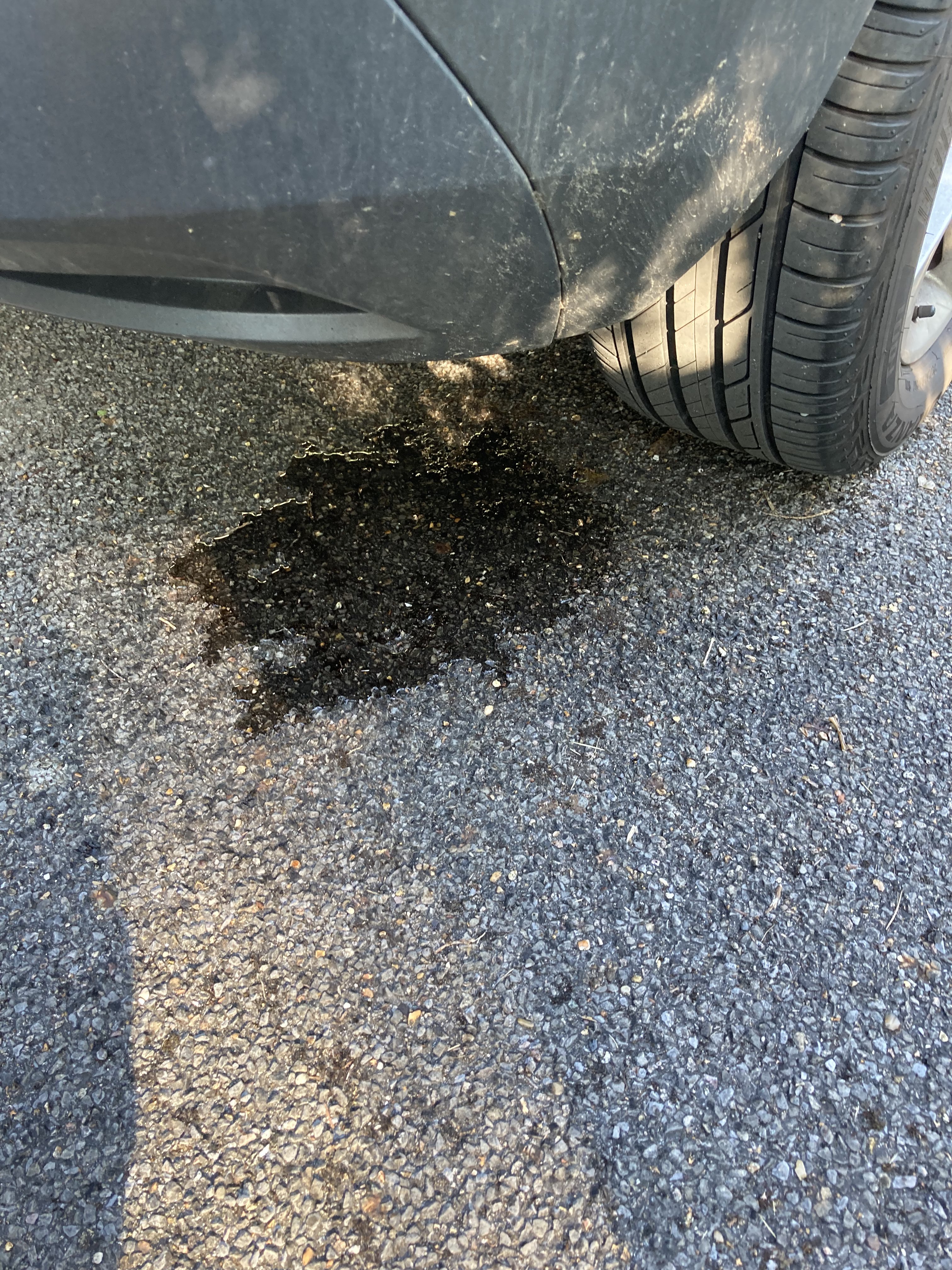

Car was reading 1,400 miles range on the old AdBlue, I can add 5.something litres to 8.5 litres, 10 litre container at the ready.  Planned to fill it up until there was only 1/4 of the container left.  Well that was the plan.
Then it all went pear shaped.  She probably only took 5 litres of the stuff when it started overflowing and dumping the excess down the fuel filler overflow drain.  Tried it again, no joy, it wasn’t taking any more.  Half of the AdBlue is still in the container and a good dollop all over my drive.  Reset the AdBlue “clock” by leaving the ignition on for over 30 seconds and it was only showing 3,500 miles “range” so only added 2,100 miles.
