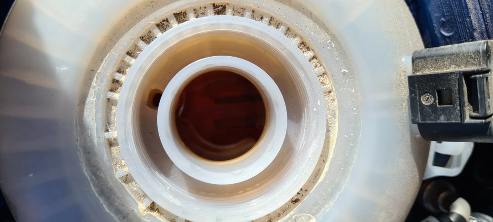

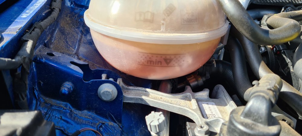

Here's the colour and state of my expansion bottle. Funny colour isn't it?
It got a bottle of perrier still water the other day!  Posh water 😄
Edited by TheWanderer
It's not great. Coolant change is reqd every 5 years. But that coolant definitely looks browny red.....
Should be bright pink through the wall of the expansion tank, and your tank has Mit Silikat written on the side which is the evil tank that can deposit granules into the heater matrix and block it up. Check heat on drivers side vents, might be tricky as it 25C at the moment, 😃 if they feel cooler than the other side, its a new heater matrix to fix it.
