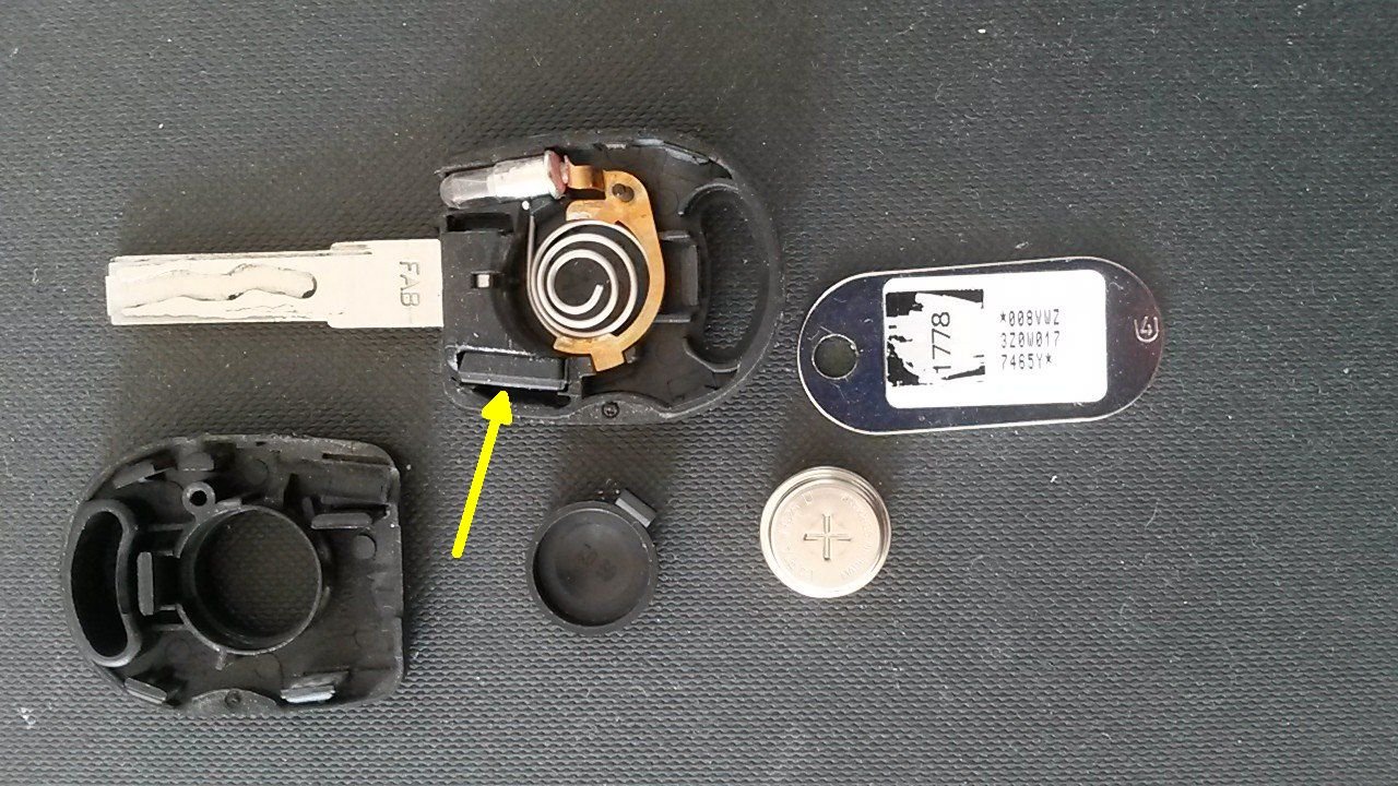

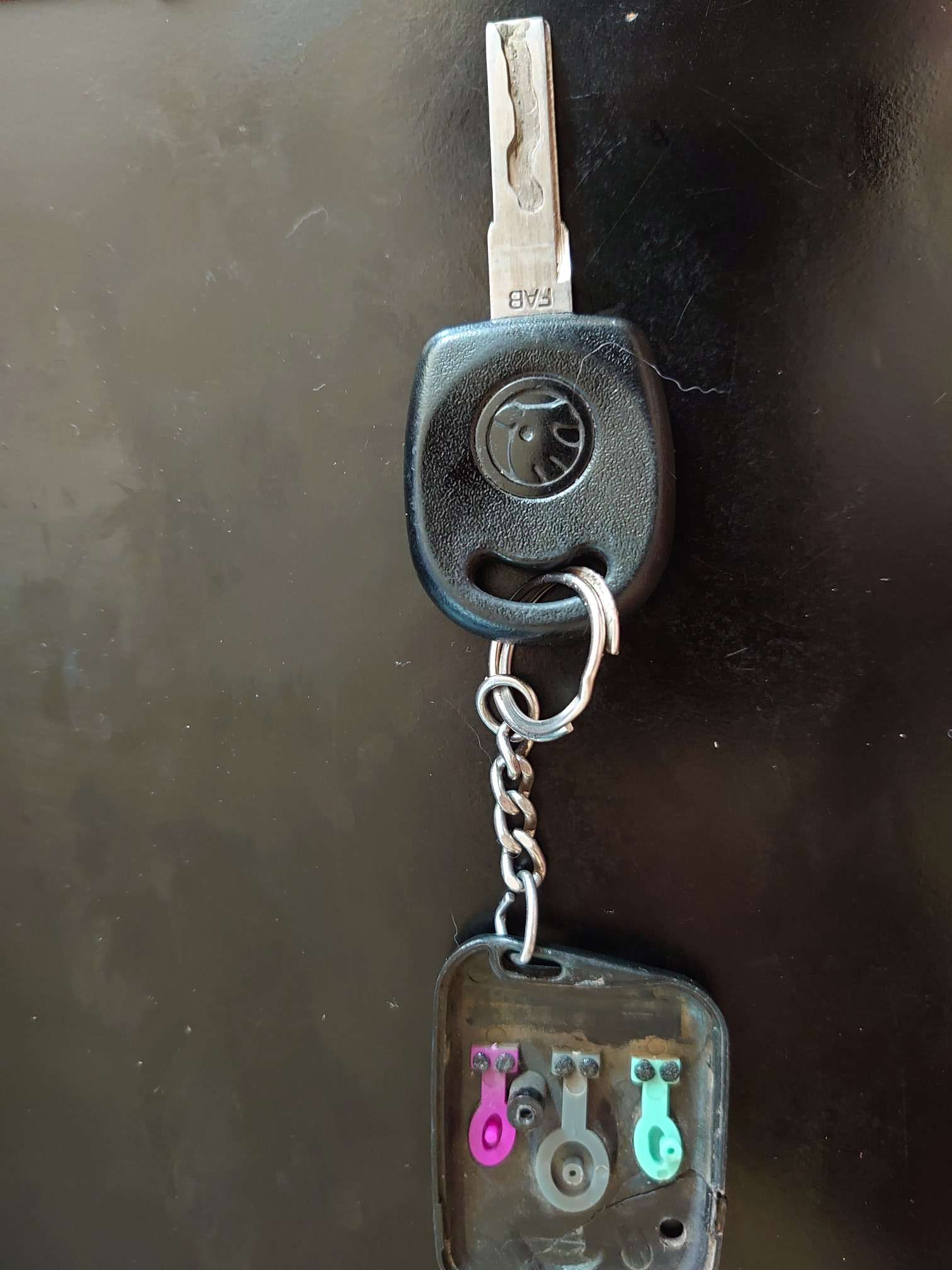

Ok, so checking previous threads, I found this image pointing out the immobiliser chip:
However, my key seems to be a bit different. It has no LED and I cant see a way to open it up (it seems like a solid bit of plastic).

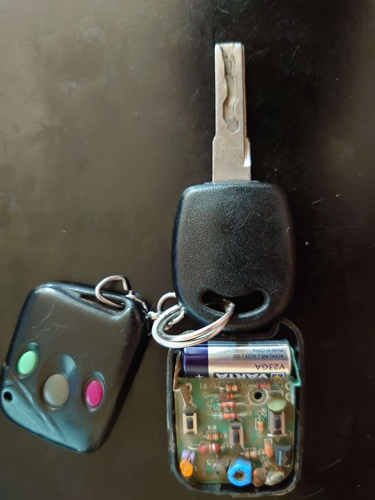

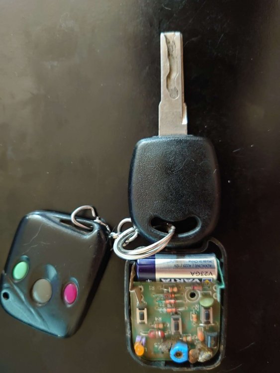

I have attached two photos here of what the key looks like:
270493969_1626608869506(1).thumb.JPEG.10e3362a52de5f9430e10894adce3363.JPEG784360904_1626608869201(1).thumb.JPEG.205fb718e7e320c9de107a5c733b7e35.JPEG
I've switched out the battery on the FOB and it's had no change. The FOB LED doesn't come on and nothing in the car responds to it.
Well I said the key not the remote.
Check by switching the immobiliser chips between keys if one starts working then you know your issue
I only have one key, the one seen in the 2 photos by the remote.
Sorry if this is obvious, but how do I open the key up? The seam is barely visible and it has no screws, it seems pretty solid. Attempts to pry it open along the seam have only lead to a finger cut.
Should point out that with the key in the ignition and turned onto the "on" position, I still cant use any lights, radio or anything. It's like the key isn't there.

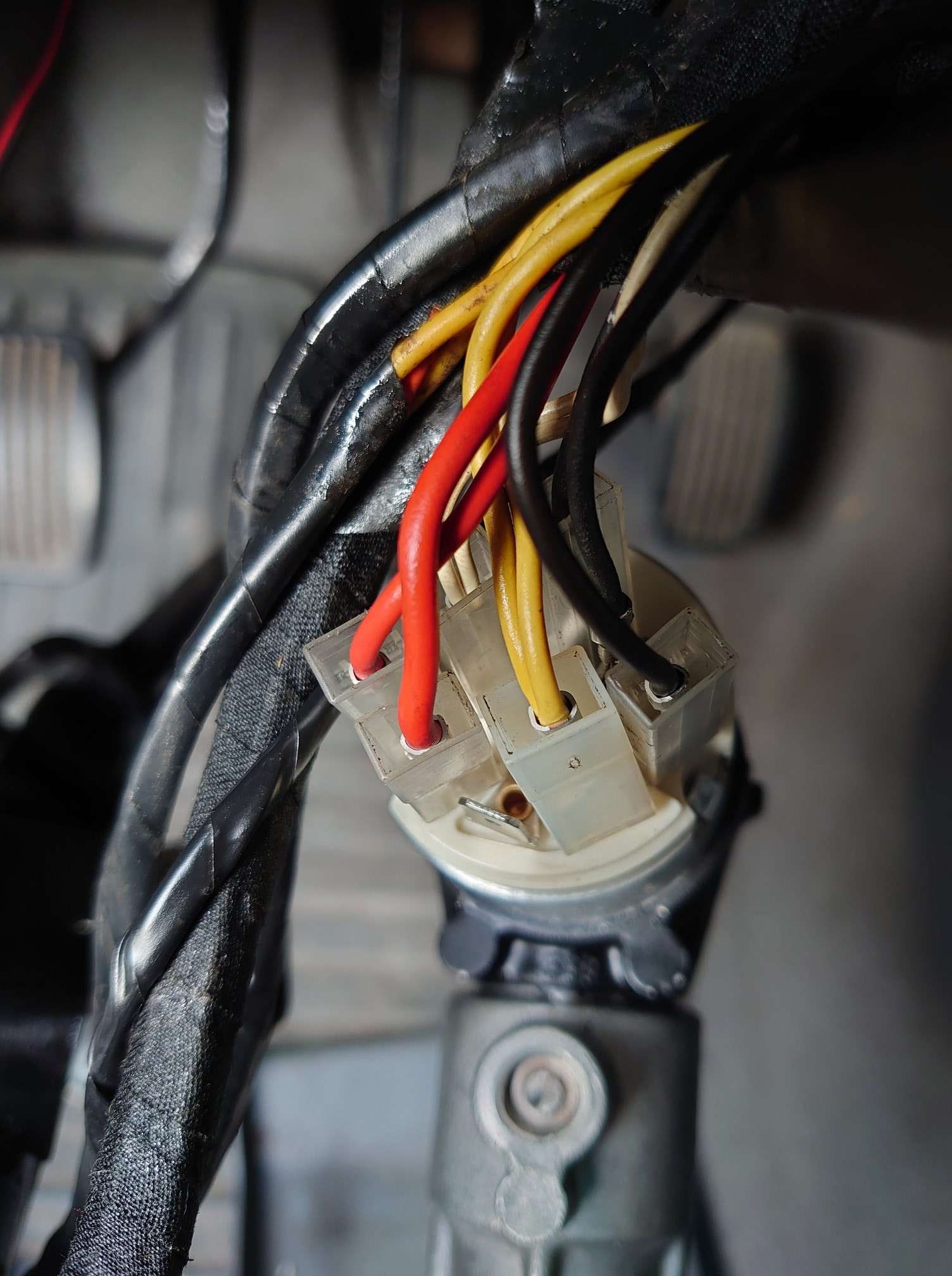

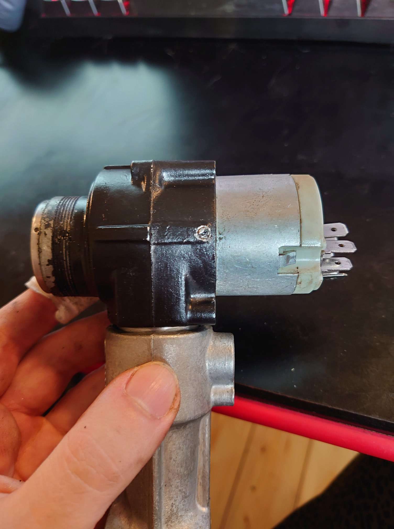

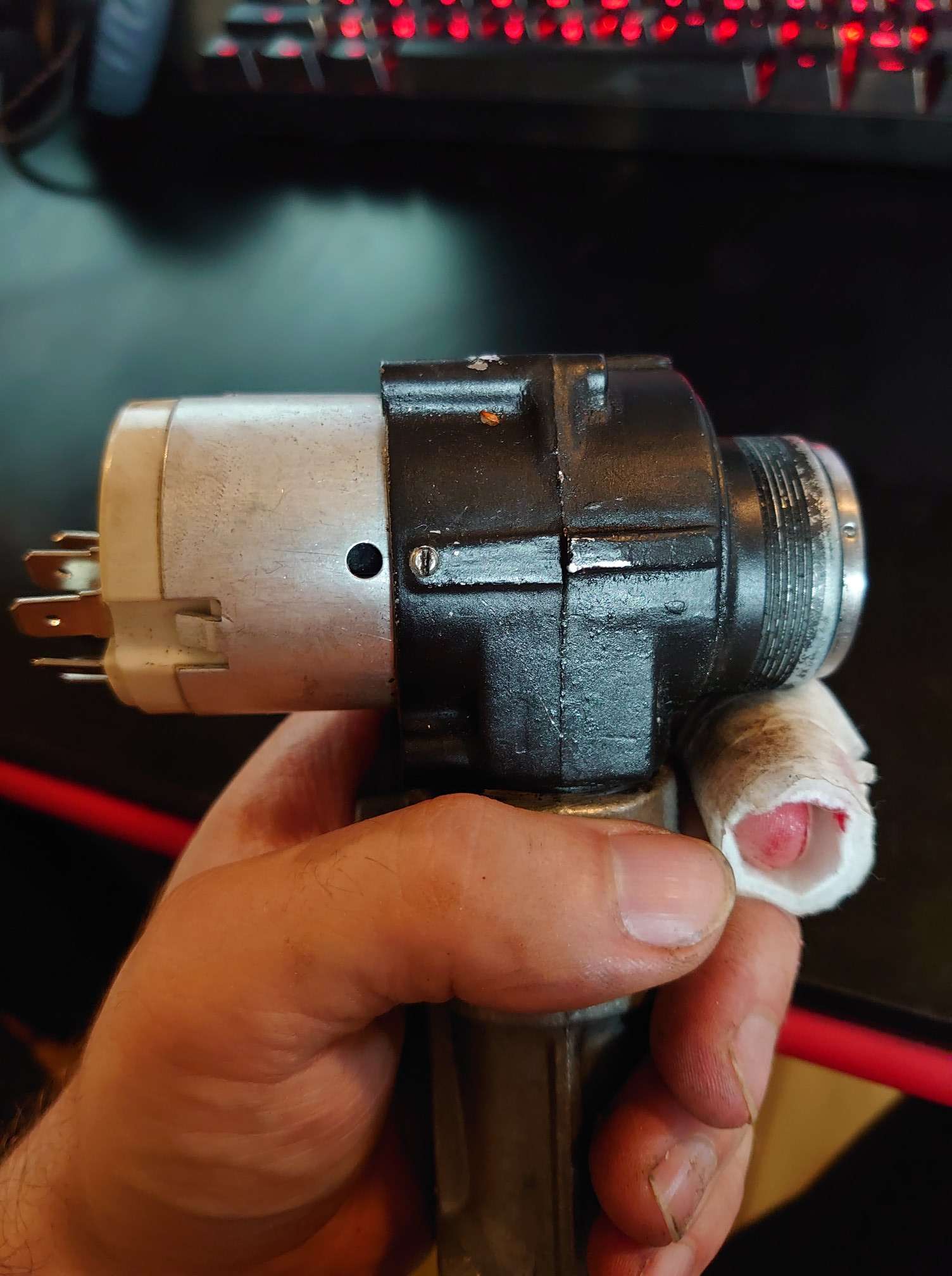

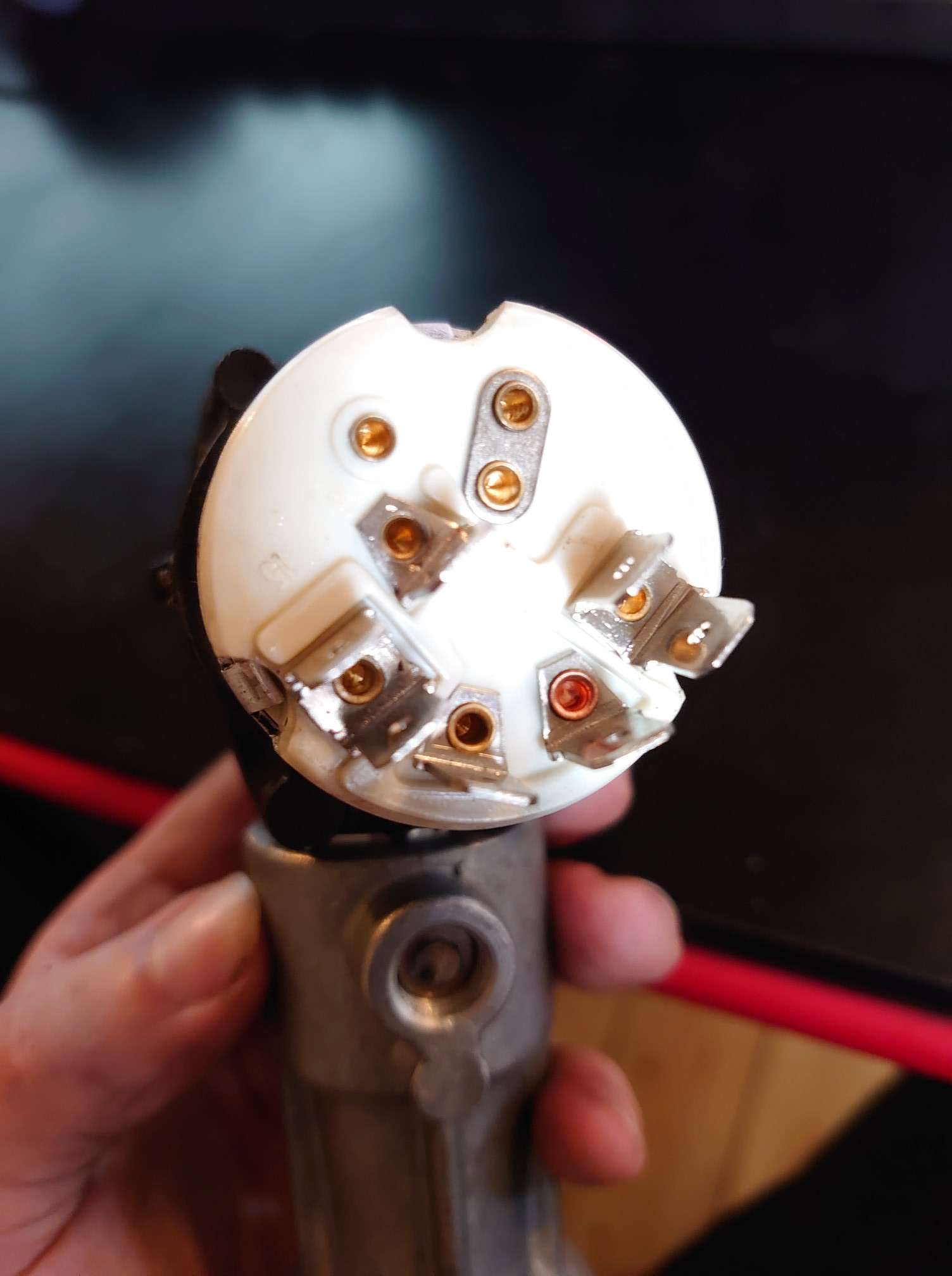

I figured that could have been an issue as I saw it in the "common issues" thread and read that the connections can get corroded, so I followed the procedure there to take it out.
However, based on my absolutely worthless opinion, the whole thing looks pretty great. There is a lot of play in the keywell but the connectors look great and nothing strikes me as broken:
1626629092015.thumb.JPEG.a9e472c56f3adaa6d7bc3254d6ade37e.JPEG1626629092289.thumb.JPEG.248cb1126f214cb6eb428a375ace0c39.JPEG1626629092768.thumb.JPEG.b3a08fd660115a94e4f8268a3de39c4e.JPEG
I'll keep taking it apart and see if I can find something suspicious, but so far it doesn't seem like the issue.
Following up on the previous images, I finished taking it apart and could find nothing suspect. Turning the key while in the keywell makes the white part make a clicking sound, as I imagine it is supposed to. I cleaned everything up, reattached it as it was previously after making sure the connections were good and it still does not work. I attached a photo of the connected ignition switch in case something there is a clear bad sign for someone else:

OK. You realise that the ignition switch is a key operated multi-position switch (off, accessories on (eg radio), ignition on (alternator and oil pressure lights on if engine not running) and a spring-loaded starter on position (starter motor runs while key held in this position). As I understand you, you have no power/function on any of the switched circuits and that pretty much has to be a failure in the ignition switch (not the key barrel, the actual switch), the live feed (usually the centre electrode), or a totally flat battery!
Hello Ken
Thank you very much. That explanation helped me a lot. I actually had no idea that's how ignition switches worked.
Going in through the possible issues you mentioned:
I don't really know how to read these, and I haven't found an ignition wiring schematic for my specific model (I just put it back the same way I had found it), but looking at this:
And at the schematics for other similar models (diesel and pickup), it seems like the red wire is the one coming straight from the battery. The red one is also centered like you said, so it seems like a fair guess that that's the live one. I'll check it with a multimeter later today and see if it has power.
I already tried to charge the battery with the help of another car with no effect, so if the red wire is carrying power I'll buy an ignition switch and replace it.
I'll report back with the result.
It is safe to buy a new ignition switch and replace the old one. The only inconvenience will be that you'll have 2 keys instead of one for all doors and ignition. The new ignition switch will come with its new key.
