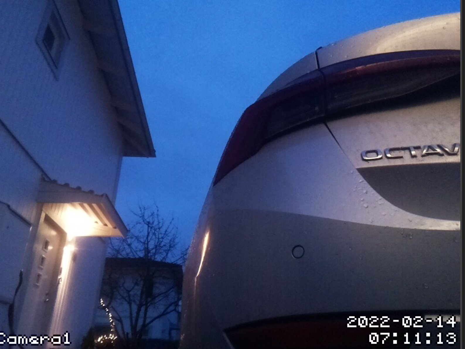

I will build a photo sensor + a Arduino/Raspberry Pi to keep track of how many times and for how long the car lights up, if it occurs again. I don't have any possibilities to keep track with a camera but I think it will work fine.
At writing time our car has been at the service shop for 36 days in total (we have had the car for 74 days). 🙌

Ok! I managed to setup a motion-triggered camera which also can trigger on changes in light, and had it running last night but the car did not light up. I will keep it running to see if something happens. It’s super to be a beta tester for Skodas products.  :)
So far so good with the 12V here! But just 9 days since MIB change.
And, quite mild temps now -3c. EV Range 45km yesterday.
The annoying aux heater messes up engine sensors still exists... got it at -17c.
Maybe there is a thread for that...
