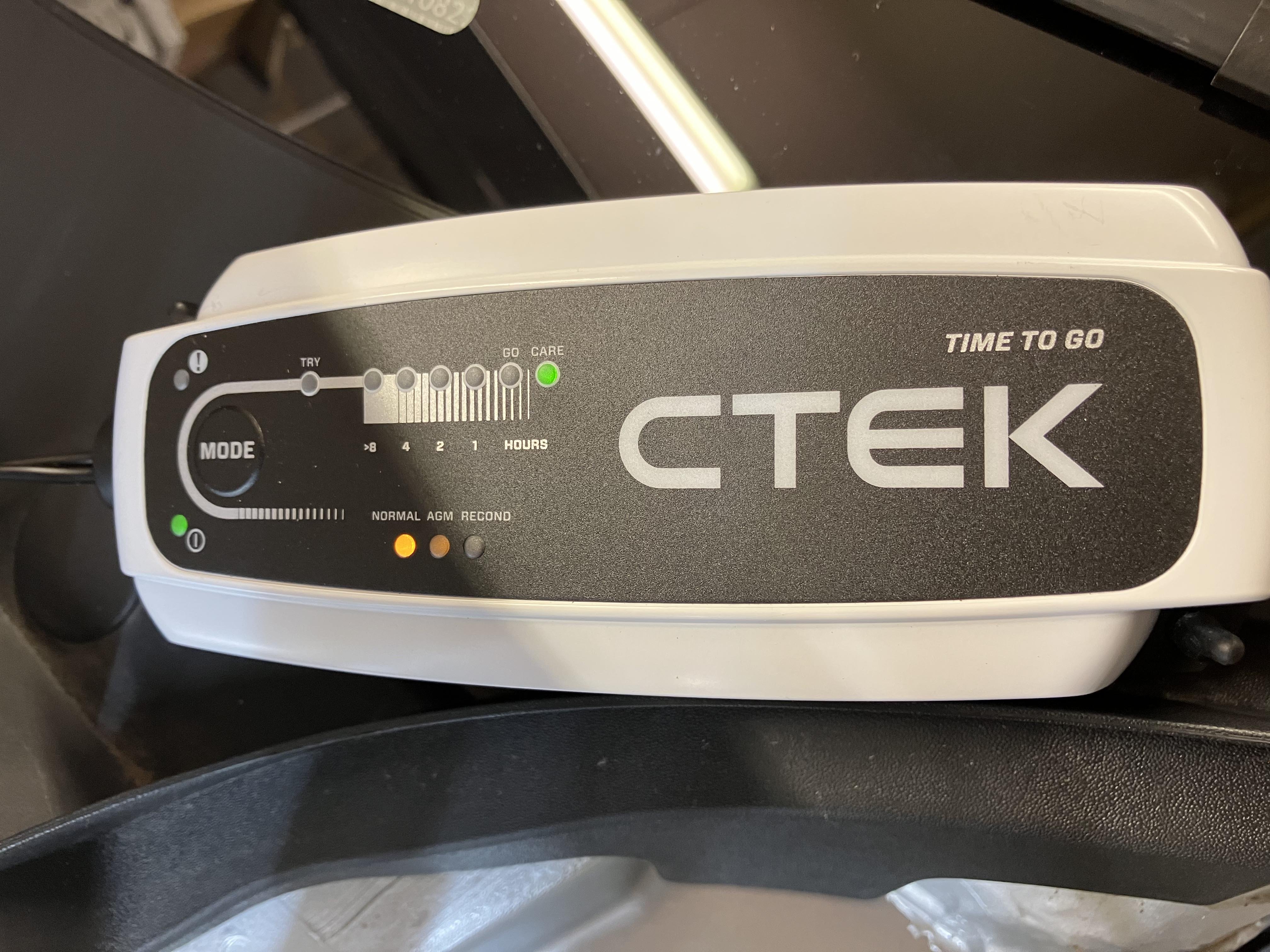

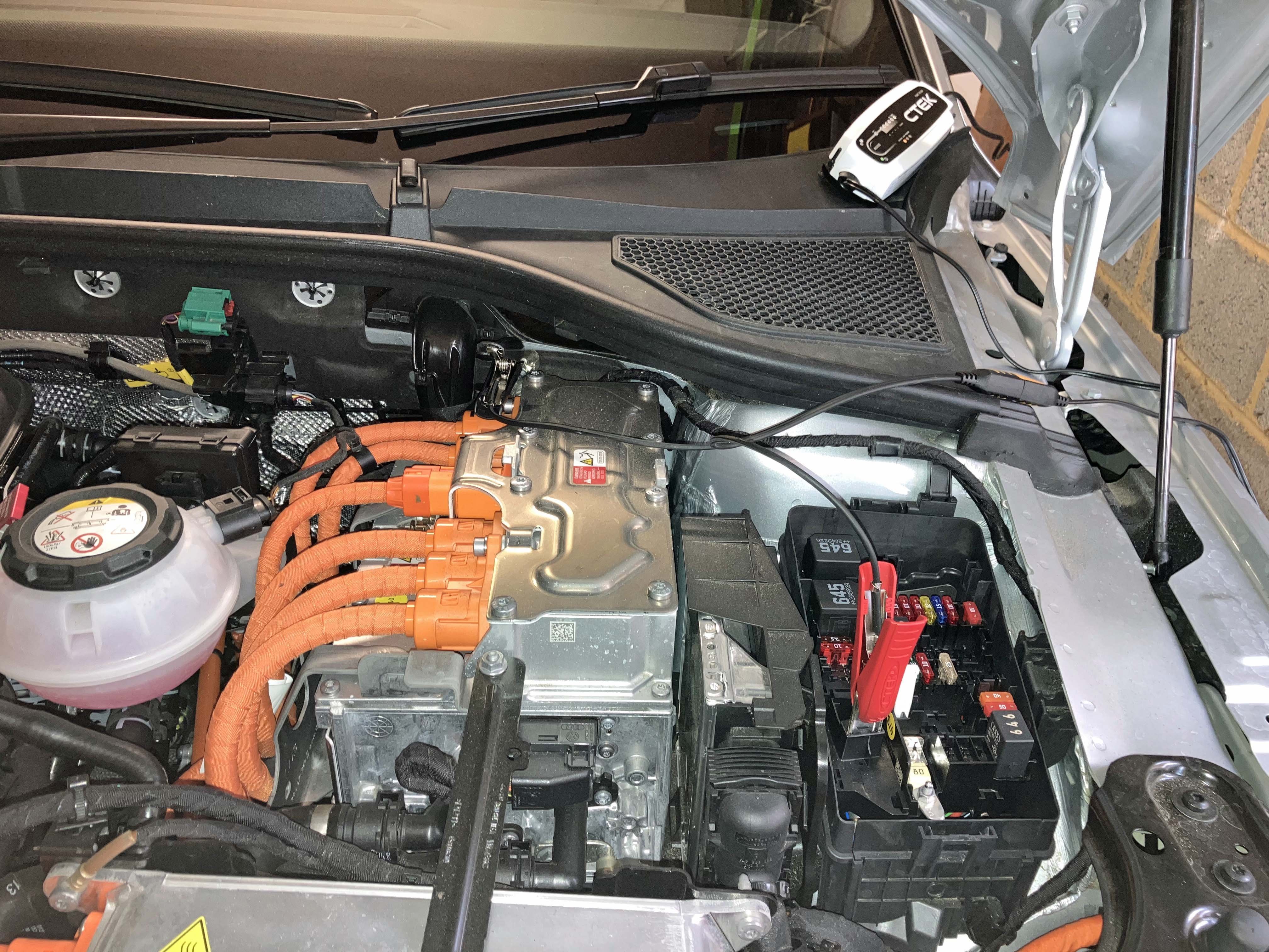

Going back to the first paragraph of my May 30 post, above, I thought it might be useful to some to see how I maintain the 12v battery. Of course, this only works if you have a garage with access to power. Being retired, the car can often go several days without being used so, every time after use, the car is garaged and then the CTEK device is plugged in, connected to the earth and +ve terminals, switched on and left on the ledge below the windscreen. Time left for charging is indicted and then the "Care & Maintenance" light comes on to show battery level is good and being maintained. Been using this compact and efficient system since 2010.CTEK_2.thumb.jpg.9d6d7ac8e1500c5dffc57595e73035a9.jpgCTEK_3.thumb.jpg.aad979c61474cf3e9c376328adeb5110.jpgCTEK_2.thumb.jpg.9d6d7ac8e1500c5dffc57595e73035a9.jpg

Jim2015 - I've never heard of the head unit (nothing in the manual). Where is it and how is it re-booted? As I noted above, if my car is idle for several days I leave the CTEK plugged in. If only overnight then I put it in the garage and pop the bonnet  release so, if necessary, I can get into the engine bay with faffing about with the keybit/doorhandle thingy.
