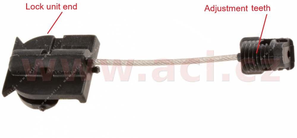

Did you adjust the little bowden cables properly? The handle ends of the cables have teeth on them to enable adjustment so that only a tiny bit of slack is present. Here is a pic of a front door cable but pretty much the same as the rear....

Hi TMB, thanks for reply and pics.
Yes I have adjusted the cable end with the teeth and there is a slight improvement in handle tension but it still appears slightly loose and the handle sticks outward slightly. Just doesn't feel right for some reason?
I'm just wondering if I have located the handle correctly at the rear (Cable) end? When the front end of the handle is hooked in how is the rear end supposed to be fitted? Should it slot into place or be pulled backwards and then pushed into place? I have a feeling it is something to do with this. Also, is the lock unit end (As per your picture) supposed to float inside the door or should it be fixed? Thanks.

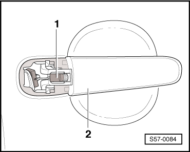

Okay... Sorted. Basically the rear fork of the exterior door handle was the wrong side of the door catch fork so when operating the handle it was pulling the cable to open the door but not fully pulling the catch. I fashioned a U' bend in a piece of wire (difficult to pull the catch fork forward with a screwdriver) to enable the door catch fork to be held outward whilst locating the handle fork correctly to sit behind it. It's a bit of a fiddle but the handle now sits tight against the door and feels nice and tight to pull.
Thanks for the Vids above, this enabled me to view the operation inside the door to see that I had located the rear of the handle incorrectly.
I've added some pics. The lower two show the difference between the two handles. (First pic of the handle is showing it incorrectly fitted and protruding slightly, the second is showing it correctly fitted)
