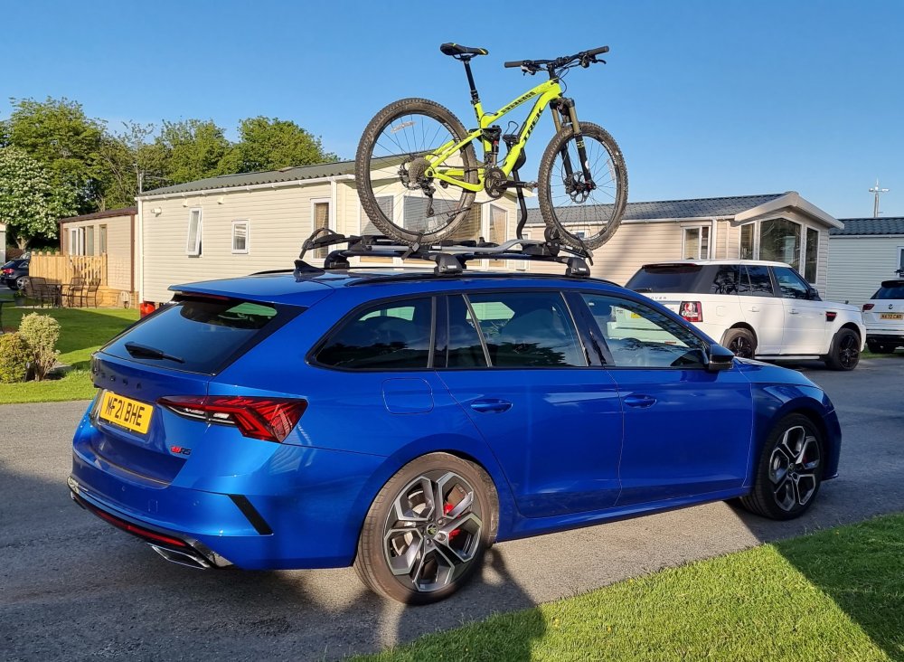

It is Thule ThruRide 565, I also like it because bike is more stable, drove many times at speed around 150-170 km/h on Octavia and my previous car, there was never any  problem.

That looks decent!
I don’t know why they charge so much extra for black, it’s just a different colour anodising that’s all.
I’m getting a petrol blue car which will have silver rails so I’m leaning towards silver which will be a better contrast to the darker paint and match the rails too.
Black is definitely best on the VRS and lighter paint colours.

How do you find it is getting the bikes up there? I was slightly concerned that the bike mount has to be further towards the centre of the car with the wing bar edge rails. I’m only 5’7” with short arms.
I previously had a Kodiaq so it's much easier than that. To be honest the bars are only an inch or 2 shorter at each end so it's not too bad if you stand on the sill (carefully) ;)
I do try to park near a kerb or something raised, at home I have a box to stand on. I'm 5' 9" so not exactly a giant.
