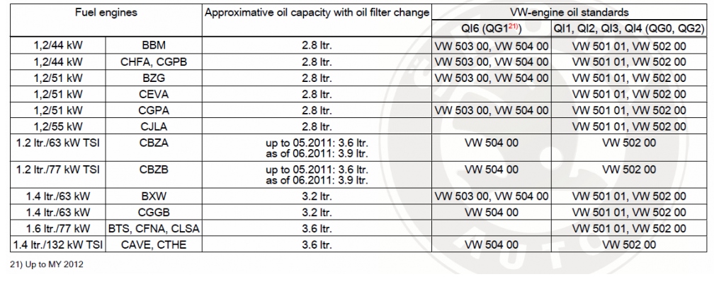

As to noise, personally i would want to be sure a good oil filter is fitted and with a 1.2 TSI i would not use the VW / Skoda recommended VW 504 00 5w 30 FS III (Long Life Oil)
for fixed or variable servicing but would use the VW 502 00 for Fixed Servicing, so 5w 40 FS and change the oil annually or ever 10,000 miles / 9,400 or sooner.
The OEM Oil Filter  & Oil Capacity changed in from *June 2012*  with 1.2 TSI's, same time as the time chains.
So
***3.9 litre rather than 3.6 litre as it had been.***
Amazing how long it took some Techs at Main Dealers to know this.  Many still do not know as they were not around on just not switched on.

The Oil Capacity change June 2012 is for the CBZA & CBZB  86 & 105 ps
