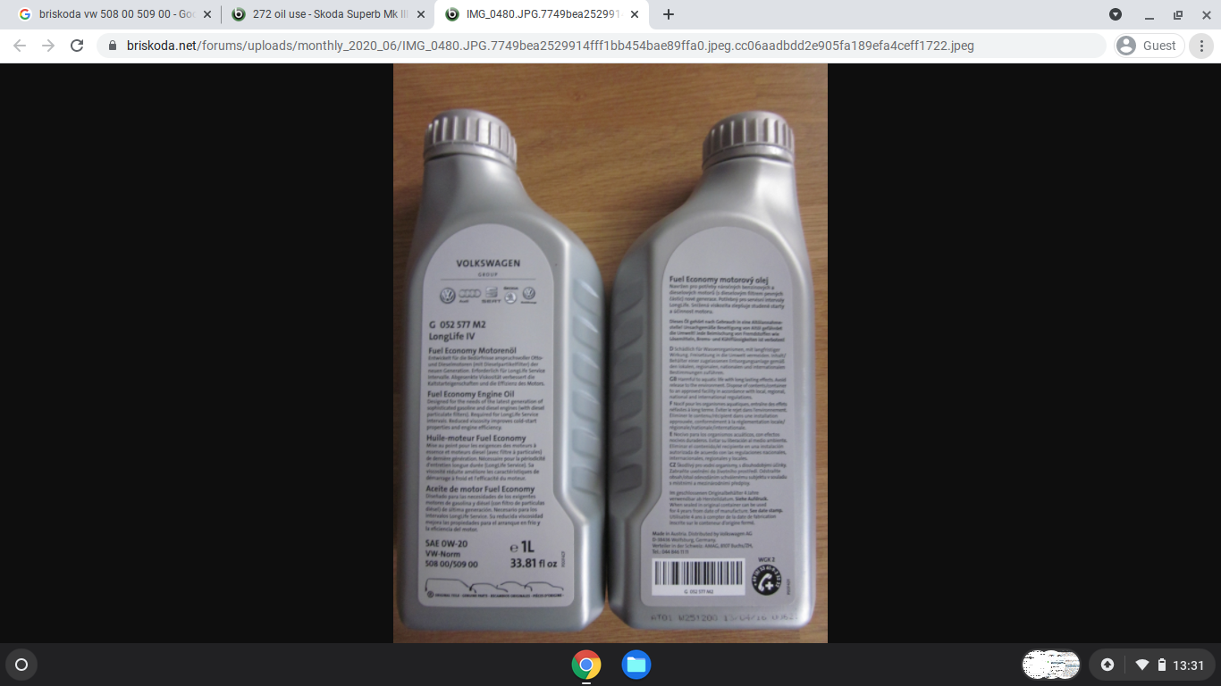

For a TDI it is long life oil even if doing Fixed Service Oil Changes.
Since the WLTP's and a bit before Skoda / VW went to using VW 508 00 / 509 00.
That is
+++ 0w 20 Full Synthetic IV +++
You can use VW 504 00 /507 00 at the Oil & Filter change which is 5w 30 Full Synthetic III.
 But if doing so you are not using the Manufacturers Recommended oil
The cost of VW 508 / 509 ,   0w 20 FS IV has come down but it is rather pricey.
