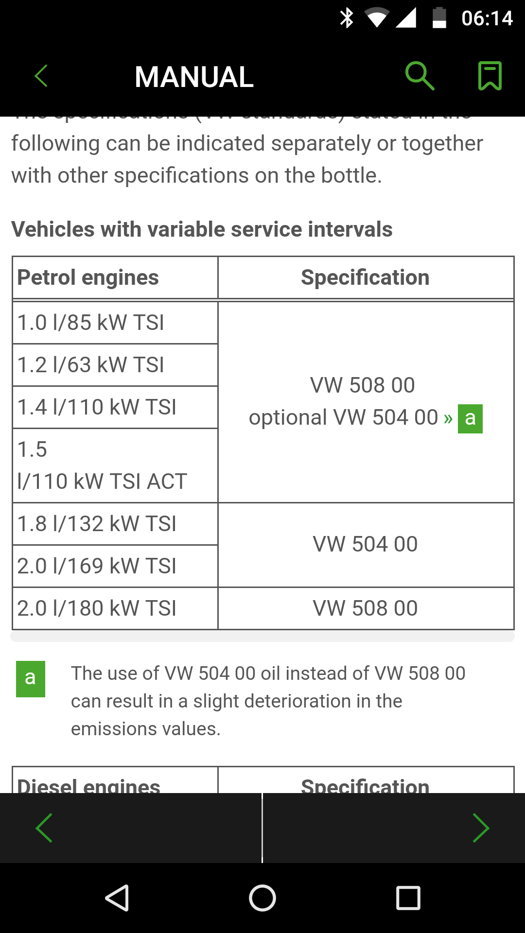

Skoda / VW Group put this out once they went to VW 508 00 VW 509 00 pre WLTP / RDE & GPF's.
This is for Variable / Flexible Servicing.   Finding that VW502 00 is ok for TSI Fixed Servicing (oil & filter changes) is more difficult.  But it is perfectly OK.
Screenshot_20180414-061447.png.ad6ebc941f71f4e7a77cecf5e55307c4.png.eb3bb2b07e733f93b57e1e5335014cf2.png

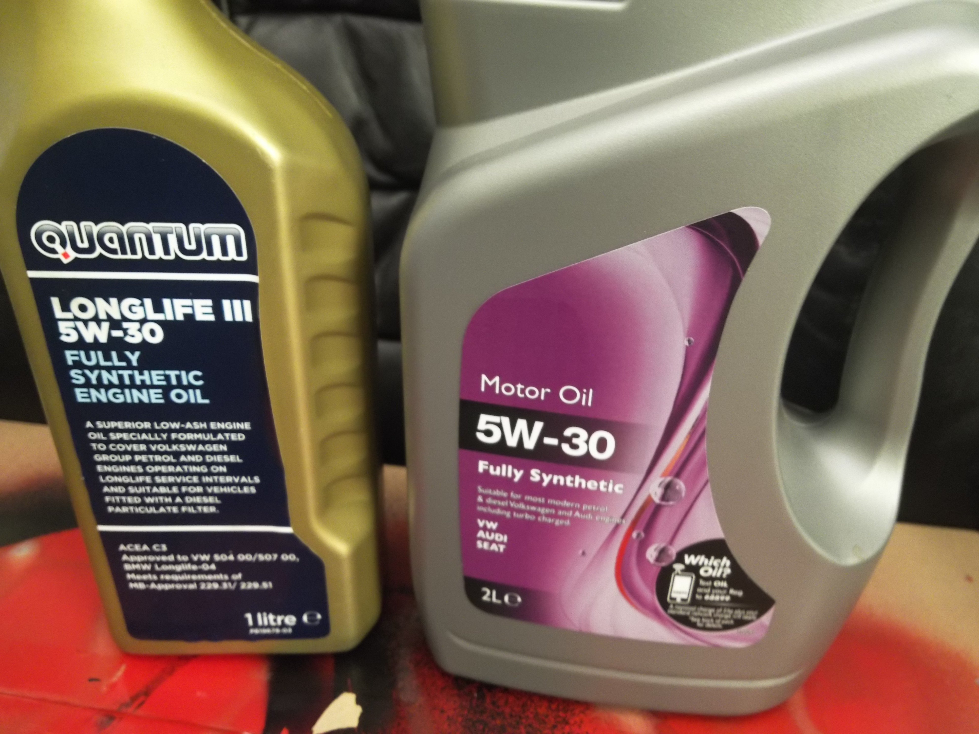

Regardless of a GPF being fitted to TSI's some Dealerships were using VW504 00 / 507 00.   (Many had no VW508 00 / 509 00 available to sell in the parts department.
Those that are Euro 6 d temp are different from the Euro 6 pre WLTP certification.     With a TDI even on fixed servicing it requires the VW507 00 or VW509 00.   It comes as VW 504 00/507 00  or VW 508 00 /509 00

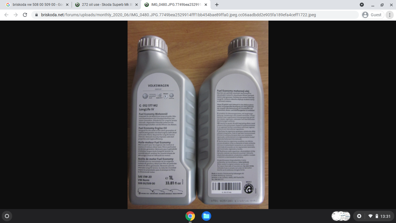

in the maintenance booklet, downloaded from the guides section on here, it seems to suggest 508 should be used, with 504 as an alternative, for my engine
i have access to the Skoda parts catalogue, and it lets me choose loads of different oils with my VIN in

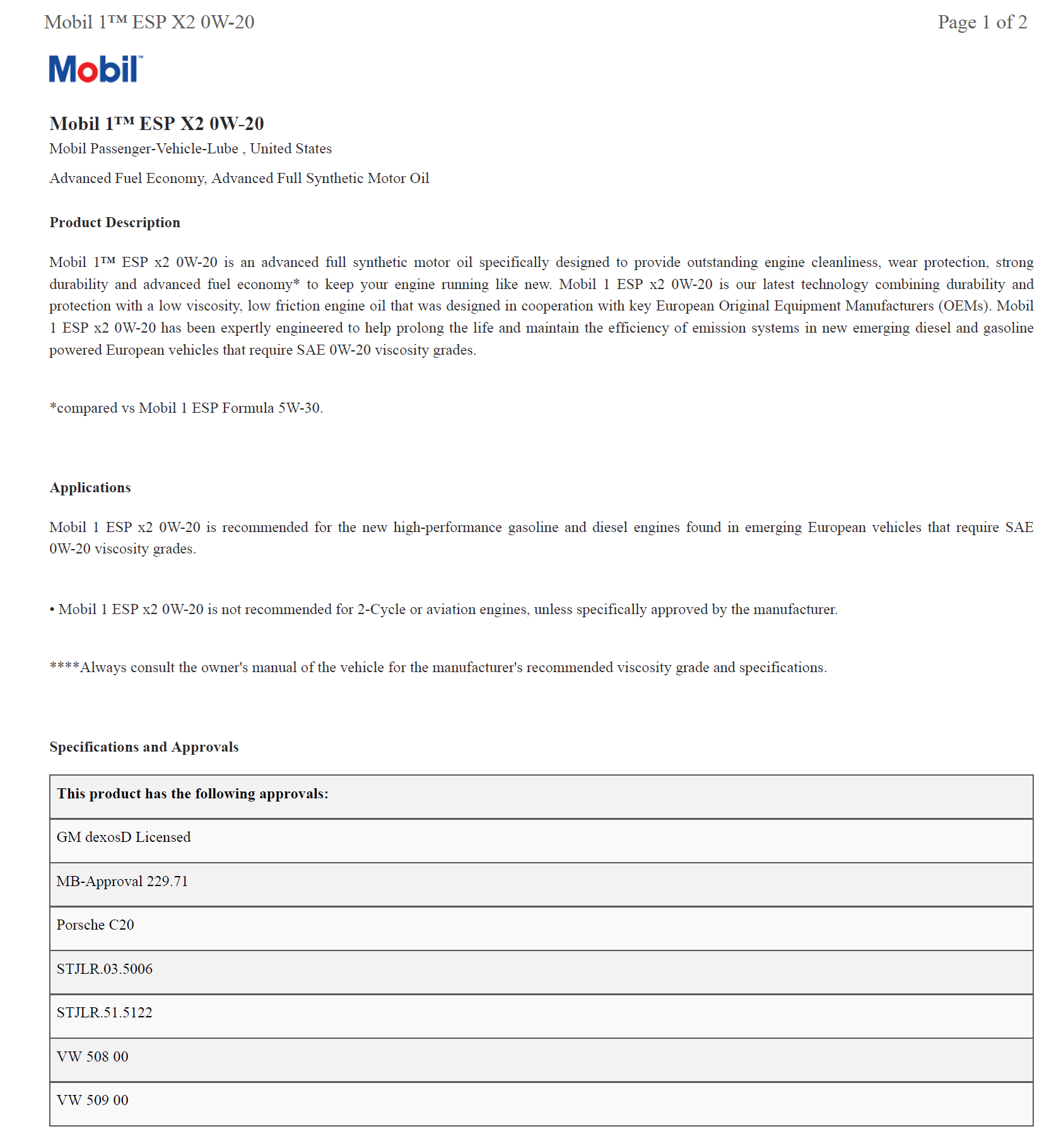

The dealer put Mobil 1 ESP X2 0W-20 in my 2.0 TSI, which is a 508 approved oil. (And 509, come to that.)
(Source:- https://www.mobil.com/en/lubricants/for-personal-vehicles/our-products/products/mobil-1-esp-x2-0w-20/ )

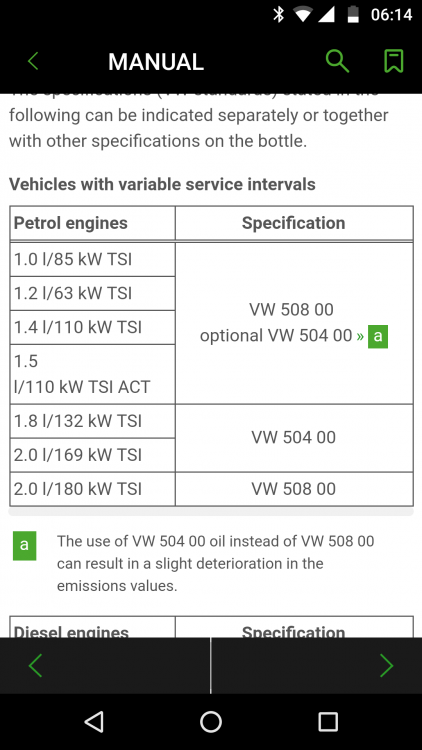

so is the image posted above correct for mine @e-Roottoot your post about an hour ago
508 or 504 spec, with 508 being preferred by VAG
everything is seeming to suggest the 508 is the correct oil, with 504 being an alternative thats also suitable

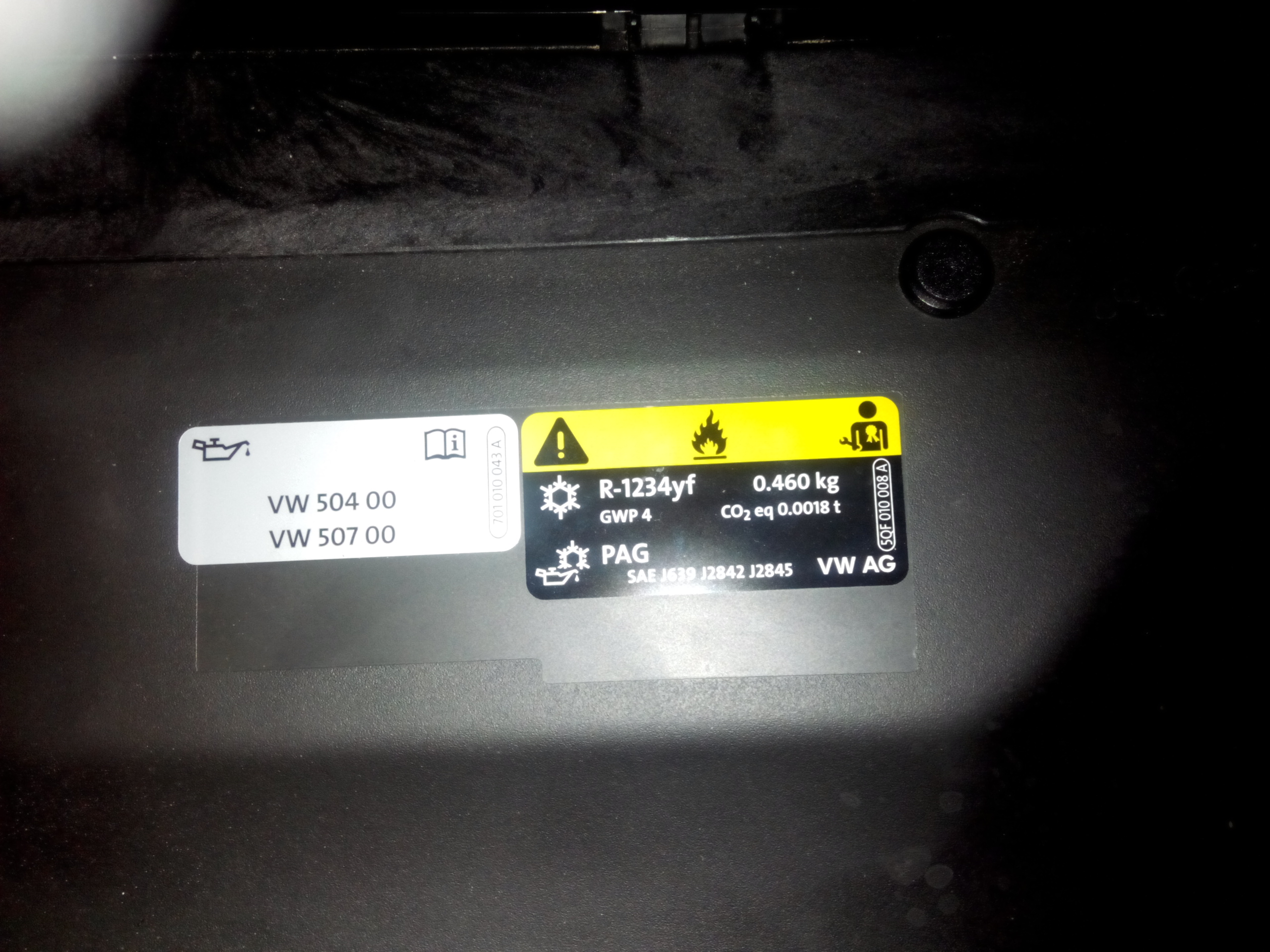

Ah! I don't have the silver oil sticker on mine, next to the black and yellow sticker.
