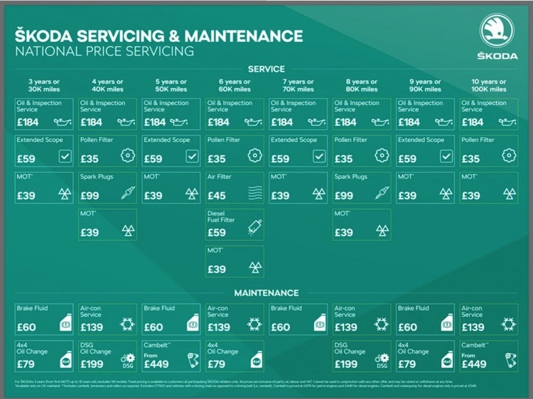

Just thinking about getting a service done in October. Will the cam belt need replaced? And any associated components? I intend to ask for an air cleaner and pollen filter change.

@gregoir Is it going to a main dealership for the work.  I hope not unless you are very flush.
Has the Air Filter not been changed at the last service, and can you not look at it, see how clean it is or not,
and change it instead of being charged £45?
£35 for a Main Dealer changing a Pollen Filter, eeek
The Pollen filter is easy, vacuum the area after the filter is removed, clean the area / wash it. Fit a new filter.

UK Skoda dealers will say yes based on the 5 years.
Skoda (the manufacturer) say no, just to inspect at much higher mileage (~130K) and replace if needed. The belt is designed to be maintenance free.
Air cleaner and pollen filter are very easy to do yourself if you are so inclined (and cost £17.50 together from Carparts4 less, vs £80 to fit from Skoda!). Air cleaner is supposedly needed only every 6 years/60K. I change mine more regularly.
The pollen filter is harder because you have to open the glovebox, and there is a knack to that (but again, other threads here if you search).
I was going to take it to a local garage for the service  ,unless the belt change was a must. So an inspection only pro tem and a belt change when? Thanks.
For what is worth, the belt replacement is recommended at 7 years in Australia.
Even the tech who asked me at the last service, at 7 year mark, admitted I was not the first to defer and he had not encountered a belt failure yet.
