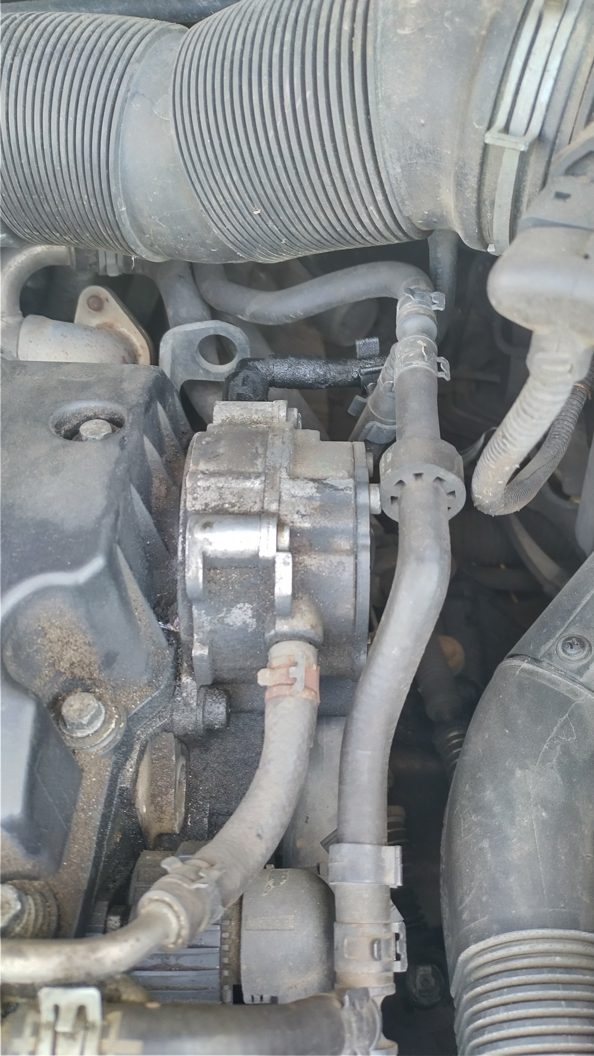

Hi Guys, just a quick question.
Does this tandem Pump look like it's leaking and also, what does the pipe at the back do??
Is it for the brakes or fuel?
Thanks in advance,
Tom

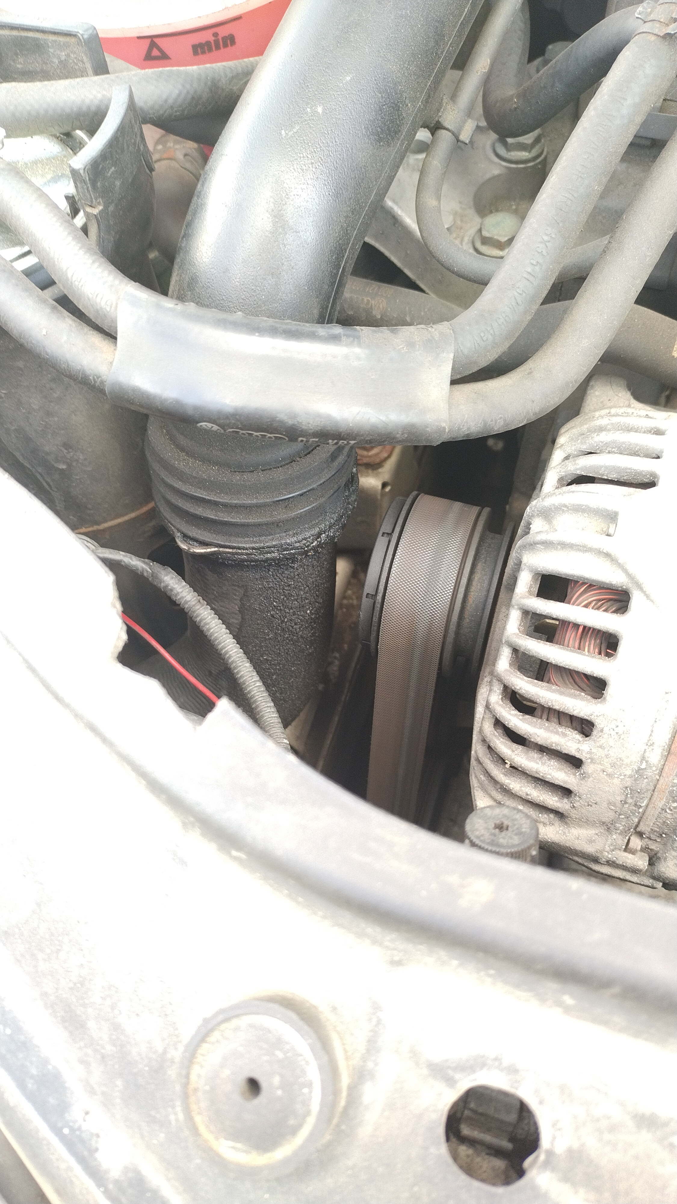

Also seeing as I'm asking stuff, does this egr pipe look shot to you, I'm guessing this would be a slight boost leak considering the external soot build up??
The tandem pump supplies fuel and vacuum, hence tandem, because it does two things at once.
So does that mean that the pipe to the rear of the tandem pump is coated In leaking fuel perhaps?
Looks more like oil though...
Yeah it could be. But where could that of come from though? the tandem pump doesn't have oil in it does it?
Yes it does, it's mechanically connected to the cam drive so it also gets oil fed from the cylinder head, doesn't look like its leaking much, I'd just clean everything up then monitor the leakage.
I know this isn't the best picture, but does anybody know the part no or the name of this top boost pipe please? The boost leak is progressing and it needs replacing asap.
Thanks in advance,
Tom
I've been looking but struggling to find it. The number is usually stamped into the plastic.
Thinking it might be item 7 in the above diagram but not 100% sure.
Yeah I think it's no 7 too. It looks to be the right pipe shape. Thanks for taking the time to look that up for me 👍
