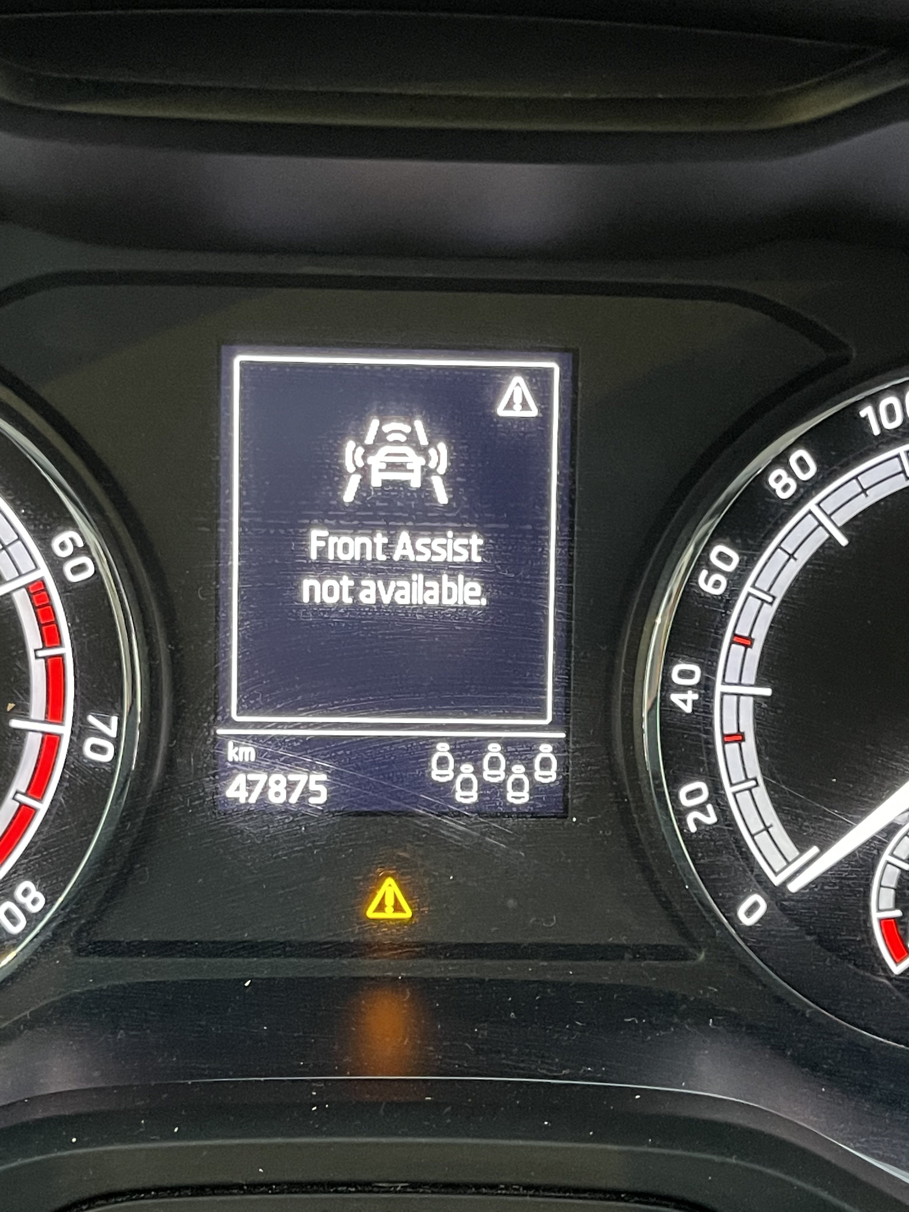

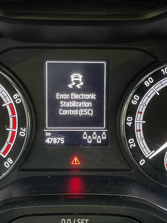

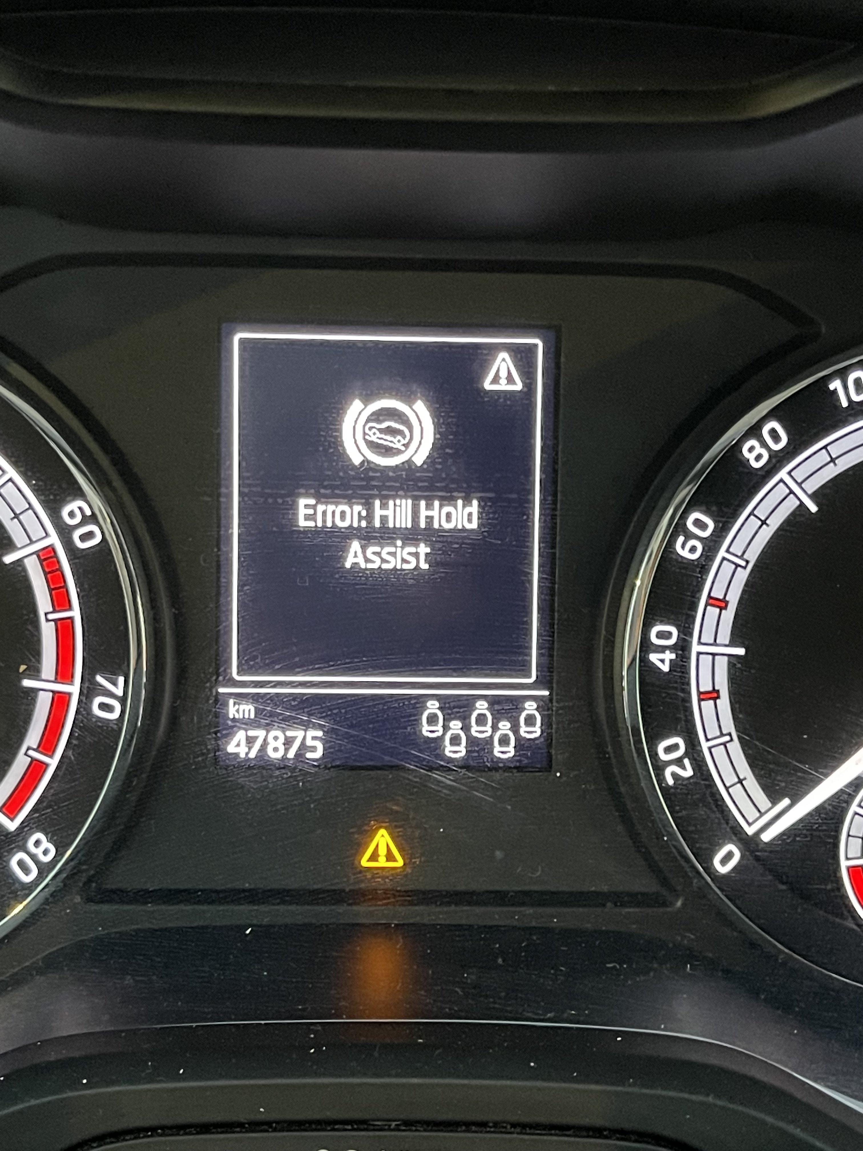

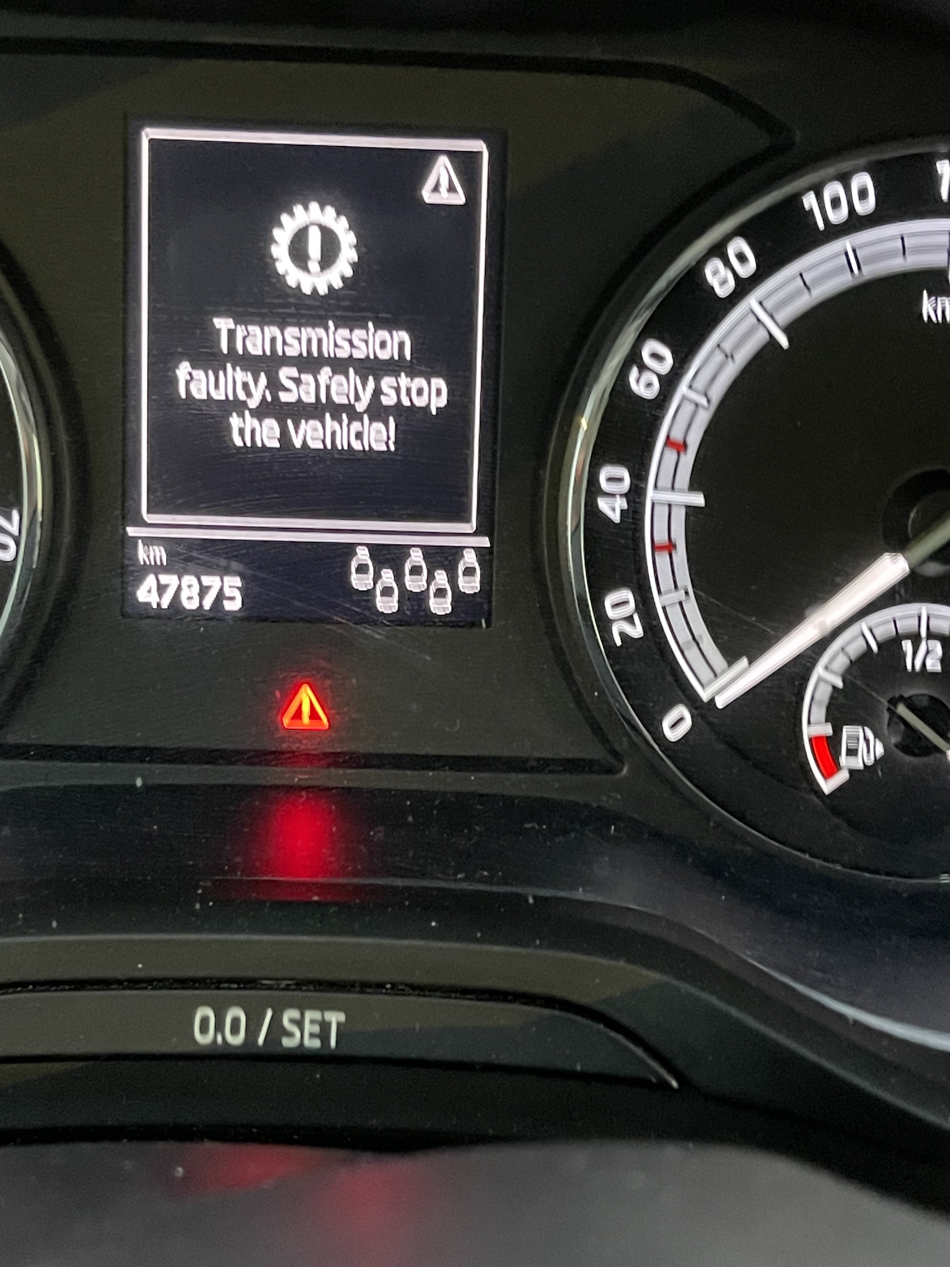

Middle of highway engine lost power and all alarms go off (gear, breaks, air pressure, battery).
 Power was on (radio, lights) but every start never moved the engine and all alarms started.

When the checked battery and charging seemed ok and so did the cables. But it happened again today and wiggling the battery cables fixed it. Oh well....
