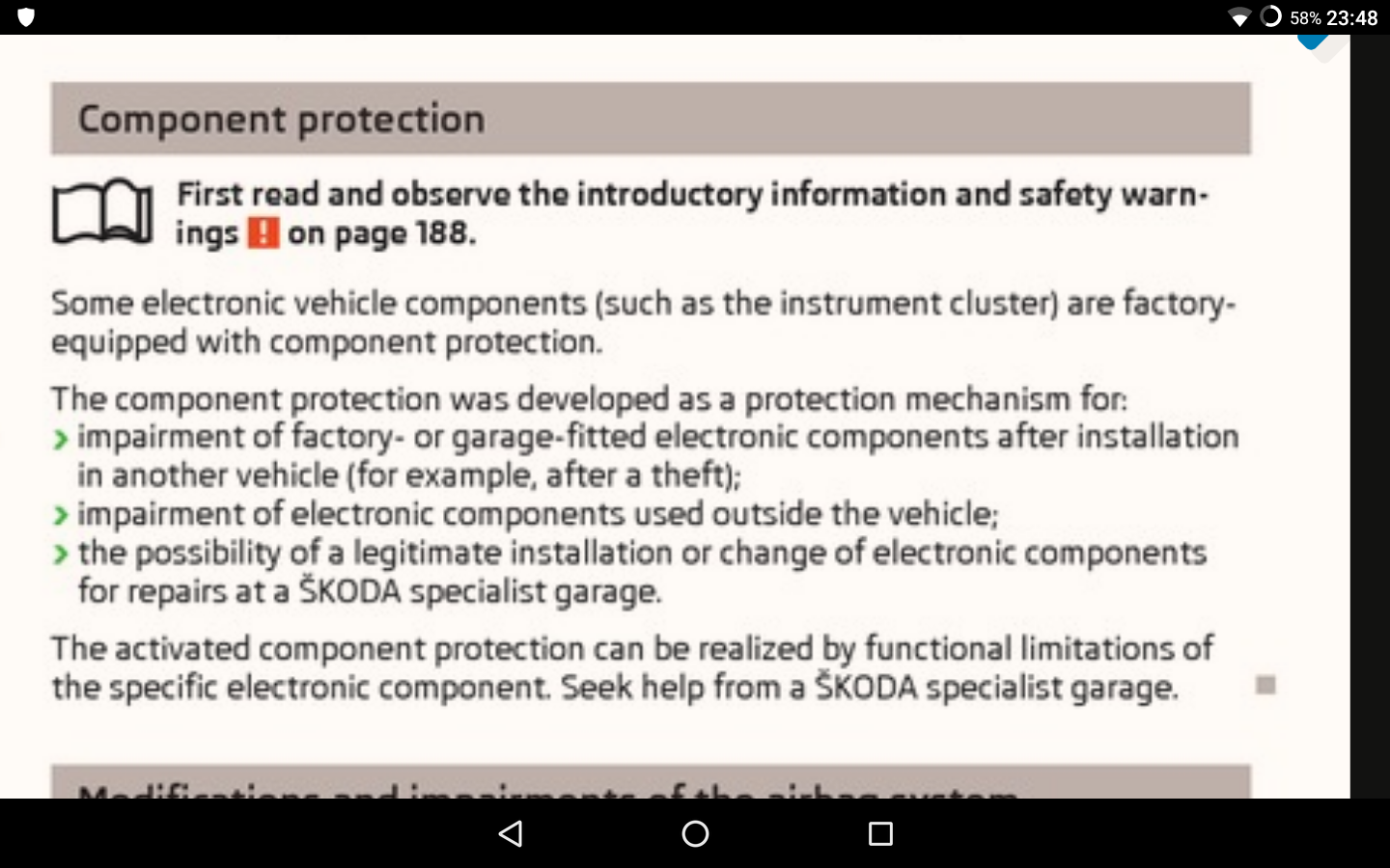

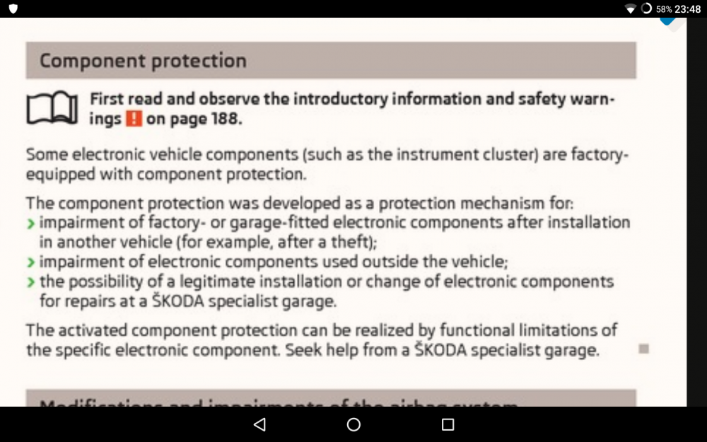

I read that calibration alone costs hundreds of pounds. A new radar is super expensive,can only be fitted by official Skoda dealers due to component protection, possibly unobtainable at the moment then you might need other front end bits, grill, even bumper if mounts are broken and geometry is out.

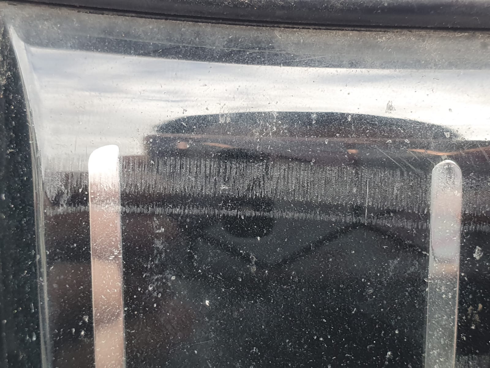

Is the sensor cover damaged or dirty?

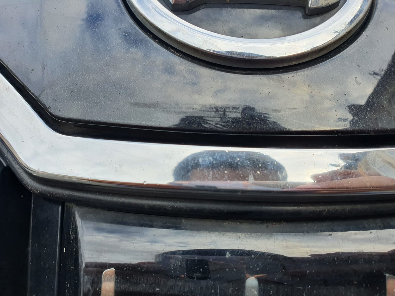

The sensor cover does have a scuff along it see image. As well as a scuff on the bonnet. I tried to clean the sensor cover to see if that was the problem, the line you see there has disappeared but it had no effect on its function.

Looking at the pics possibly just an alignment issue with something bent, maybe even a cross member so difficult to second guess without it being assessed by someone with knowledge.

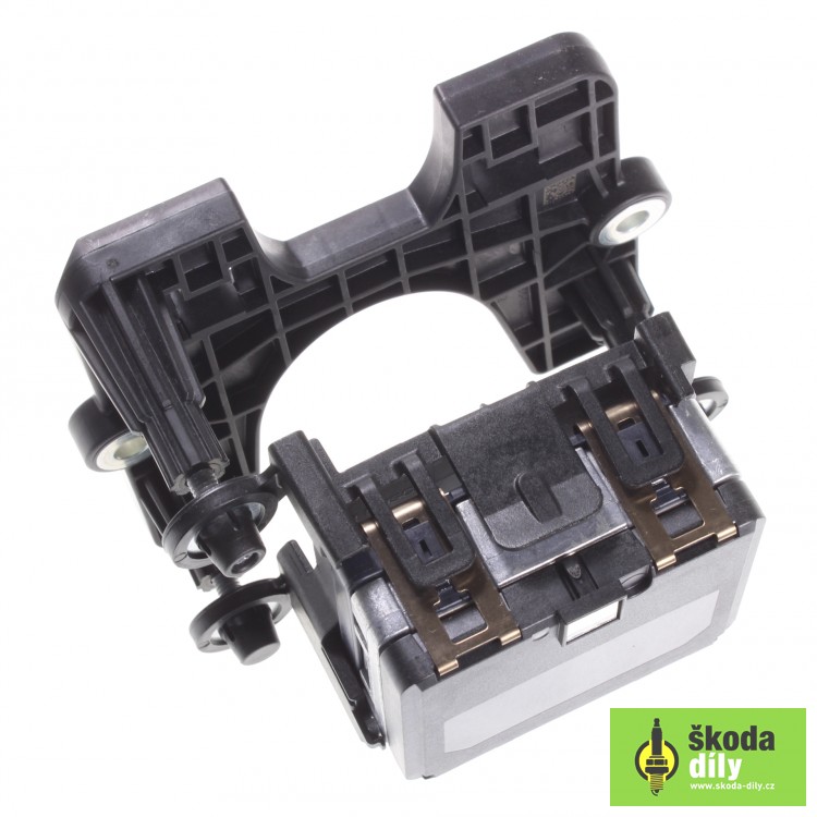

From other threads I've read, these radar units tend to be mounted on springs on the mounts, sometimes they get knocked a skew and stick rather than spring back, its just a case of pulling them back to the correct position.

@xmanthank you for your concern. I took the cover off and can physically see a plastic cap of the radar is broken off, sitting in the well, and the brackets are bent and plastics brackets have snapped off. I don't know what else could be wrong without seeing the extent of how it's damaged underneath but on the surface (covers on) it looks like nothing happened.

Add to that labour, bear in mind that only Skoda dealers can fit it due to component protection.
