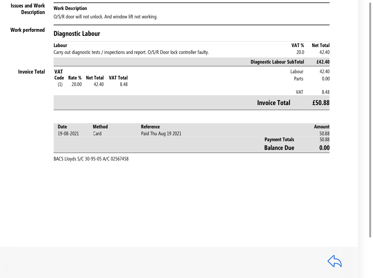

Ofcourse I agree I have done loads on my car but with this as long as I know the problem I can give it a shot as I have my lot in 3 weeks and need it open. This is the invoice they left. So how would I go about finding the wire as I locked and sprayed the plug in door hinge.

Hi so I took it to auto electrician and pointed out the ‘kinked’ wire and it was not enough of a kink to cause damage and I thought that when I looked as I have had worse wires that worked still. They tested it and managed to open the door unlike the other ones and they told me it was just the motor needs changing and it’s plug and play meaning take it out out new one in.
