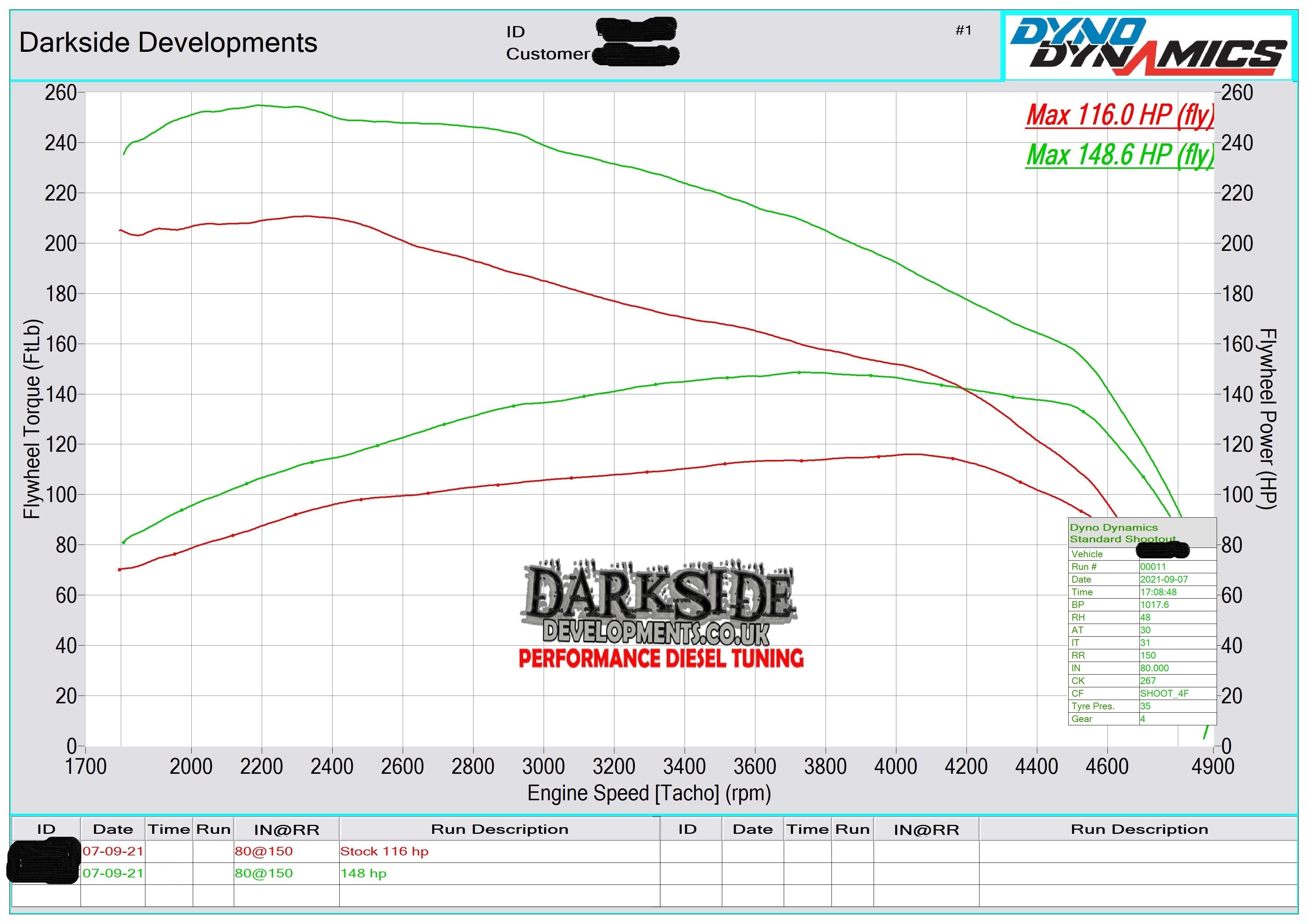

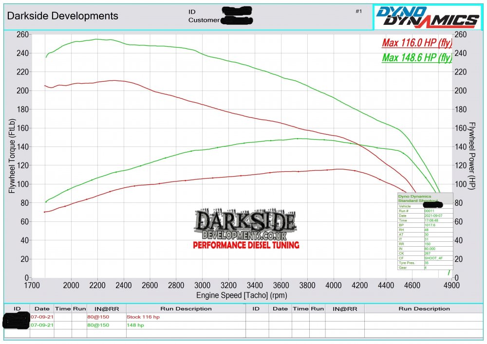

Just had mine remapped to 148hp at the flywheel (about 133hp at the wheels) by Darkside Developments nr Barnsley. Not a 'knock your socks off' improvement but gives a better and more accessible spread of torque which will be ideal for towing my medium sized dinghy trailer.

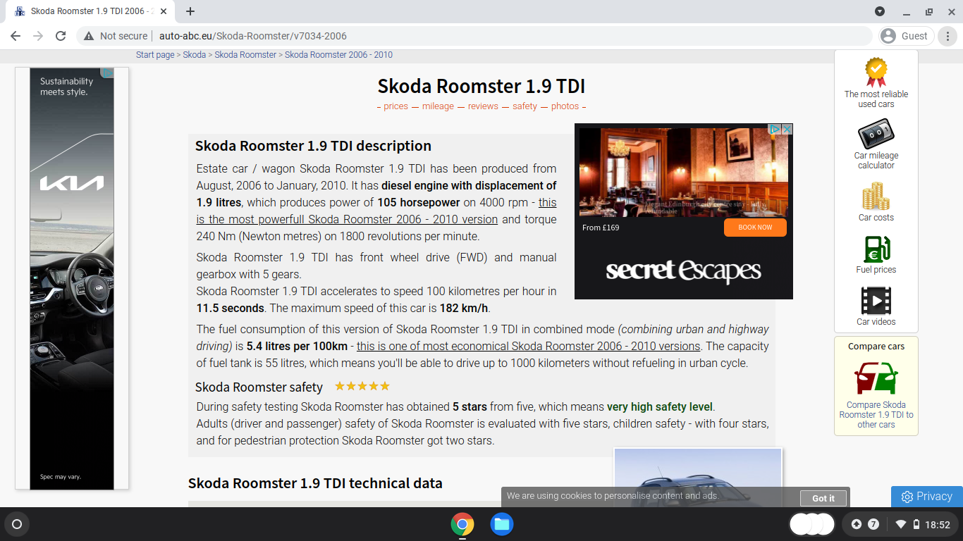

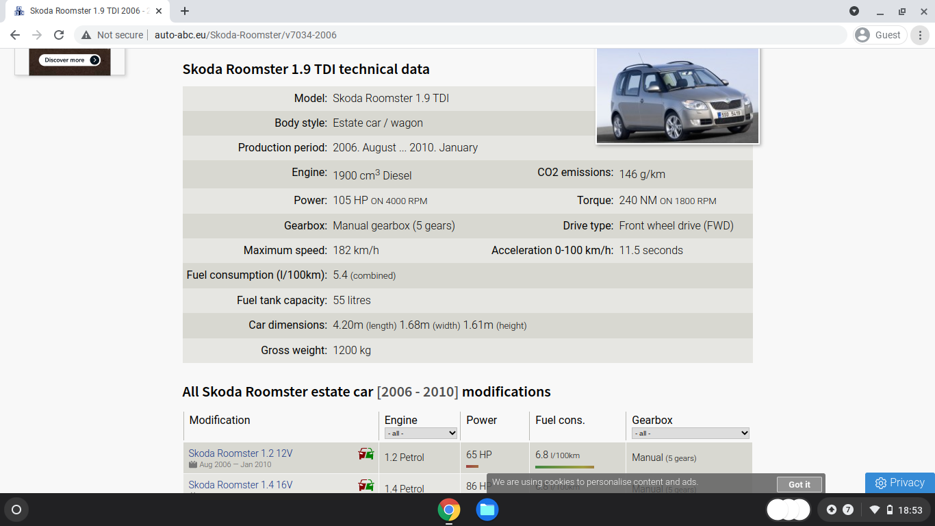

Thanks folks, was the 1.9tdi fitted right up to 2015 as I cant find one ?
I think up to 2010 for the EU / UK.    Someone will correct that if wrong.

As above - 1.9tdi discontinued 2010 (possibly at the time DPFs became mandatory)
!.9tdi produced oodles of torque and was very economical and reliable, if a little gruff.
