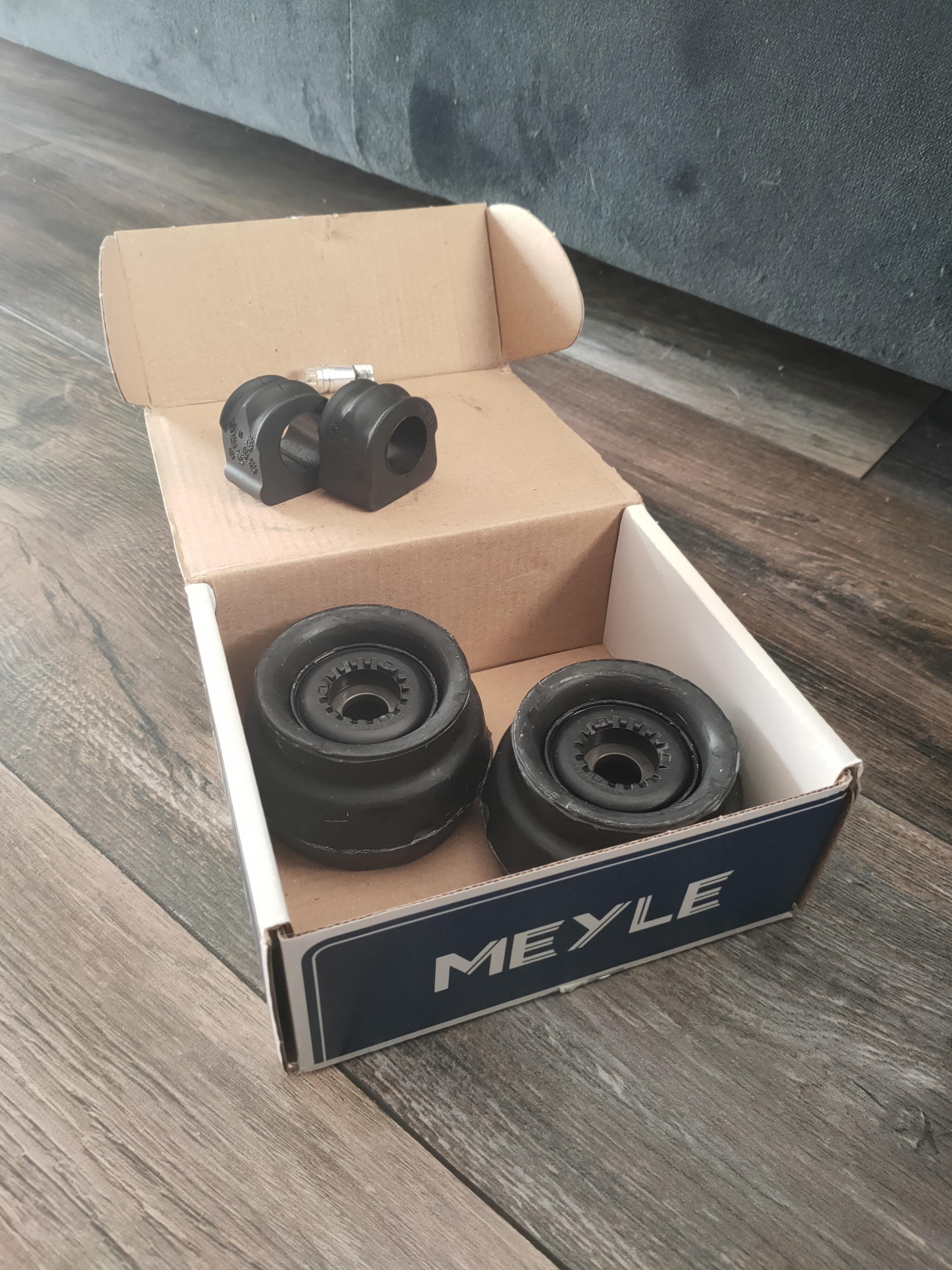

After reading through a few threads and being recommended by Evil i went ahead an bought some new Meyle ARB bushes aswell as new top mounts / bearings, hopefully going to get these fitted over the weekend and hopefully say auf weidersehen to the creaking at the front.
processed-7881bd9c-8992-4855-bae5-3564ee28b837_LGz9Zeum.thumb.jpeg.f99f8aaee282ef74a4389343c64703c6.jpeg

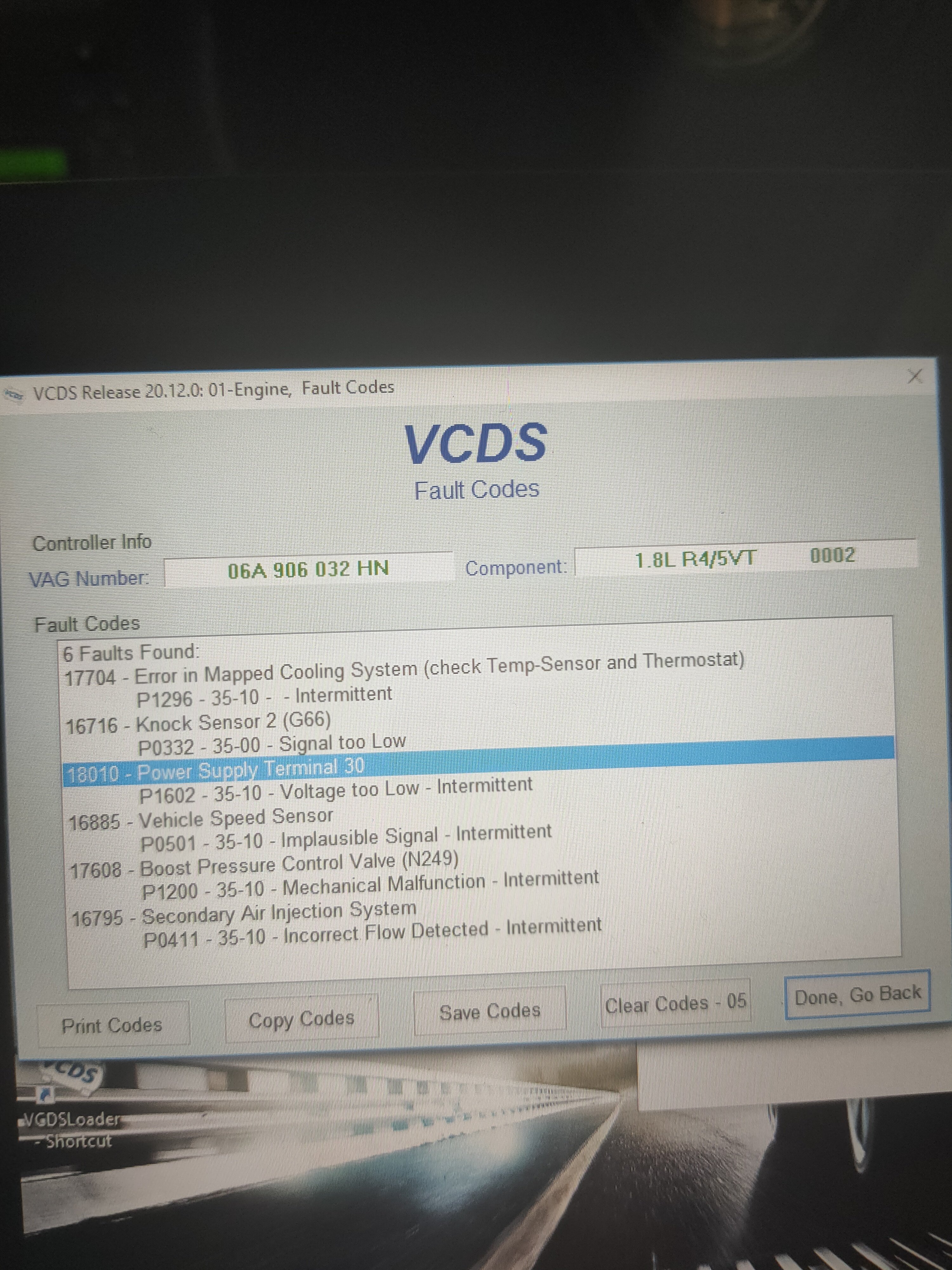

Found out a pal of mine also whos heavily into his vag cars has some crazy version of VAG-COM with all the bells and whistles, and kudos to him hes offered to use on the Octi to see if theres any stored codes and fingers crossed will be able to tell me if infact there is a boost leak or not.. however one thing ive noticed and have been noticing is when driving, lower in the rev range the car seems to run a little bit lumpy, im suspecting coilpacks on the way out..? Can anyone clarify?
Also, theres a god awful squealing and rattle when pulling off in a high gear or doing early changes ... aux belt?
Either way, bit by bit im still planning to get the car back to as best near stock condition as possible before i send it in for a map, dont really want to leave any stone unturned.

Yeah i think im going to do that, especially with the wishbones and stuff, i really do NOT fancy going through the trauma of trying to remove the bushes with a hacksaw and blowtorch lol.
I wouldnt be surprised if it were the shocks or something along those lines if im honest, i genuinely just thought the car was ridiculously soft from standard, the suspension doesnt look like its sagging in any way, its just the body roll when going round corners is enough to knock someone sick lol, ive planned now for a set of JOM coilovers for it, i know theyre cheap ebay jobs but i've used them countless times before and personally have never had an issue.
I'll have a look at all the hoses over the weekend, there are alot of them lol, anywhere specific to put my attention to?

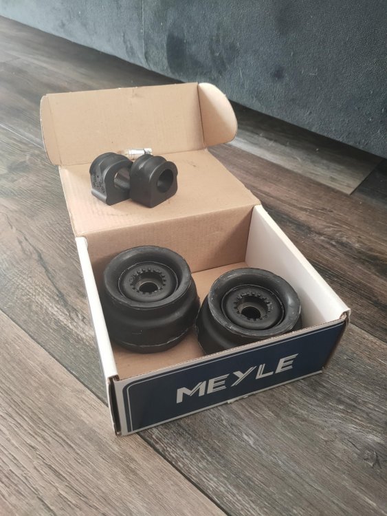

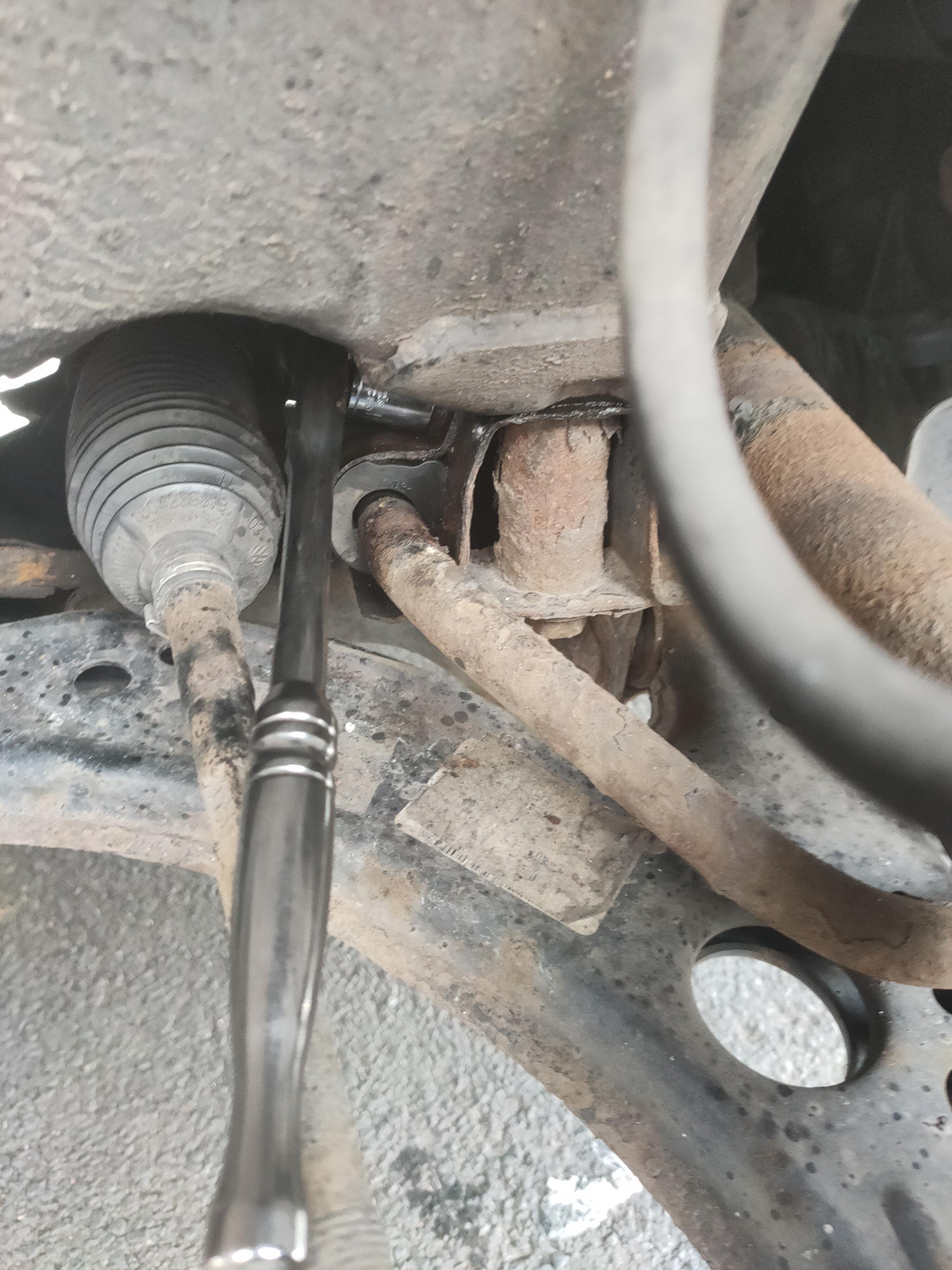

So, did abit on the weekend, when i say abit i mean not a fat lot atall haha.
I will apologise in advance, i really do forget to take pictures on whats being done so you'll have to deal with just the one for the time being paired with a very wordy update post
processed-7484e026-52b9-4a1f-b68c-70519fc4eb42_OG77k9wE.thumb.jpeg.1b68613415d0b61657a88cdb4677e65c.jpeg
Conclusion? Replacing ARB bushes are an absolute nightmare without ratchet spanners... Best part about it, it didnt fix the creaking!
Either way, after bruised knuckles, cut up fingers, and aching hips from sitting with my legs crossed for 2 hours i finally managed to get them in, even though the ones which came out didnt even look that bad.
It didnt fix the creaking but amazingly the way the car drives is night and day, it handles so much nicer now (not sure if just a placebo effect)
Didnt get round to doing the top mount bushings purely because i didnt have an impact gun to get the top nut off but after replacing the ARB's the steering wheel seems to sit straighter, still pointing to the right slightly don't get me wrong, and when ive got a passenger in, it points further to the right, so by process of deduction, with the creaking, knocking, steering wheel sitting off centre to the right and because im convinced the passenger topmount is properly fubar'd, it would make sense that all these issues are being caused by that, no?

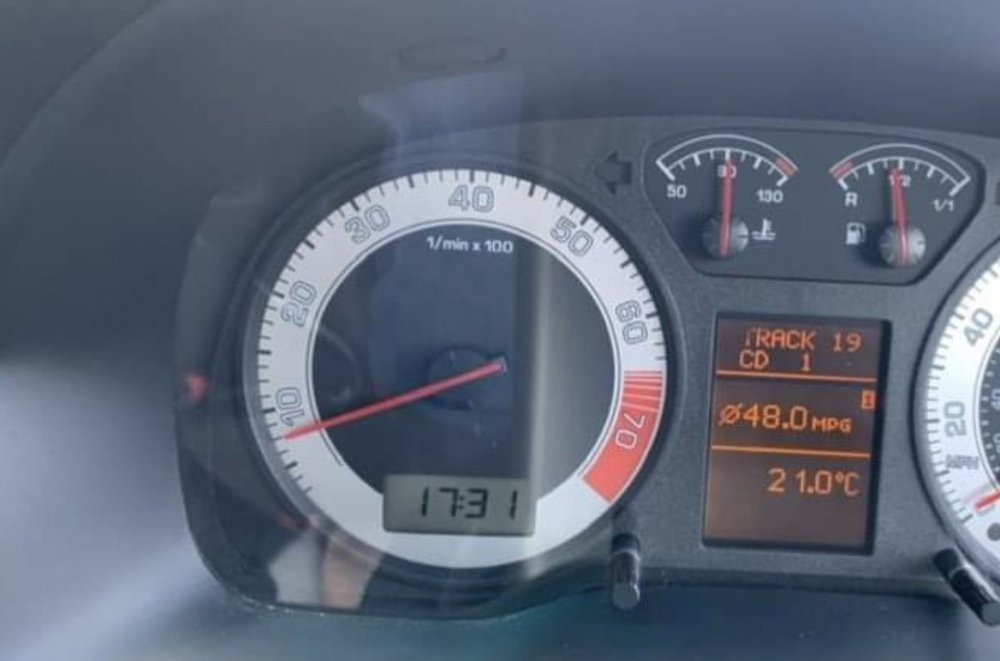

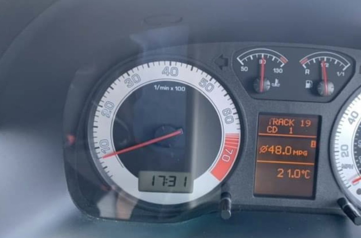

When you do miss daisy/old man driving you can hit 48MPG. Taking it with a pinch of salt, but it shows what you can get if, one sits at 60mph. 😂
Edited by DeanVRS20VT
3 hours ago, DeanVRS20VT said:
When you do miss daisy/old man driving you can hit 48MPG. Taking it with a pinch of salt, but it shows what you can get do if one sits at 60mph. 😂
the screen under your fuel and temp gauge, mines just black and shows me the fuel light and open door etc, how do i get the one you've got? 😂

Onto the update..
Had the car scanned last night, after seeing the codes i was quite surprised and full of relief considering it was probably the first time in 17 years the car had been plugged in (previous owner was a member of the tree society so didn't really give a f**k about the car clearly)
Going through them one by one
17704 - pretty self explanatory, would rather not do the thermostat so going to replace the CTS first to see
16716 - erm? help?
18010 - erm? help?
16885 - This one confused me as the speedo works perfectly fine... Any advise on this is welcome
17608 - Kinda assumed some Nxxx related valve codes would come up, plan on bypassing this anyway so nice easy fix
16795 - Same as above, not needed and advised to remove it prior to having the car mapped

Right or wrong, I tend to clear codes just in case they're historic and see what comes back.
Does your temp gauge sit at 90 degrees?
CTS is easy, 2 minute job..
Got mine from Amazon (wanted it next day) Febi 32510 £6.50
Morning Evil... Yeah it does sit at 90 once up to temp, on the drive home from Blackburn sitting at 60mph (2/2.5hrs) it did go down to say, 87? But for the 99% of the time ive owned it, yeah, once up to temp it sits top dead centre at 90.
It should just sit at 90 regardless... right there, the whole time. CTS is the cheapest part (genuine thermostat from the dealer is about £80 iirc - cheapest (genuine) I've found is circa £50 - I ain't paying it).
Well i suppose it does, me saying it dropped to like 87 is just me being pedantic lol. It warms up and sits directly up put it that way... I take it i can assume that the thermostat and CTS is ok then?
Good chance, yes. I'd probably change CTS anyway... the o-rings squish, they leak and stuff.. (plus, in my old pd130 Golf, the CTS used to really affect performance - there was an unidentifiable coolant leak that dripped onto it, changed 3 in a year)
When I was doing all the deletes recently I didn't even touch it and it started leaking, the bugger... turns out it was similar price (and quicker) to get a Febi sensor from Amazon than it was to get a new clip and o-ring.
Yeah i've had a quick look they really don't cost alot so its almost not, not worth doing just as preventative maintenance.
So after doing some digging and according to some chaps over on audizine the 18010 - Power Supply Terminal 30, Voltage too low code is apparently down to disconnecting and reconnecting the battery, something about the ecu detecting the loss of power and therefore throwing a code?
Makes sense as i took the top hose off the DV last week for some chu chu noises for the lols, it threw a CEL and i disconnected and reconnected the battery.
Just for anyone in future who gets the same code come up on a scan.
