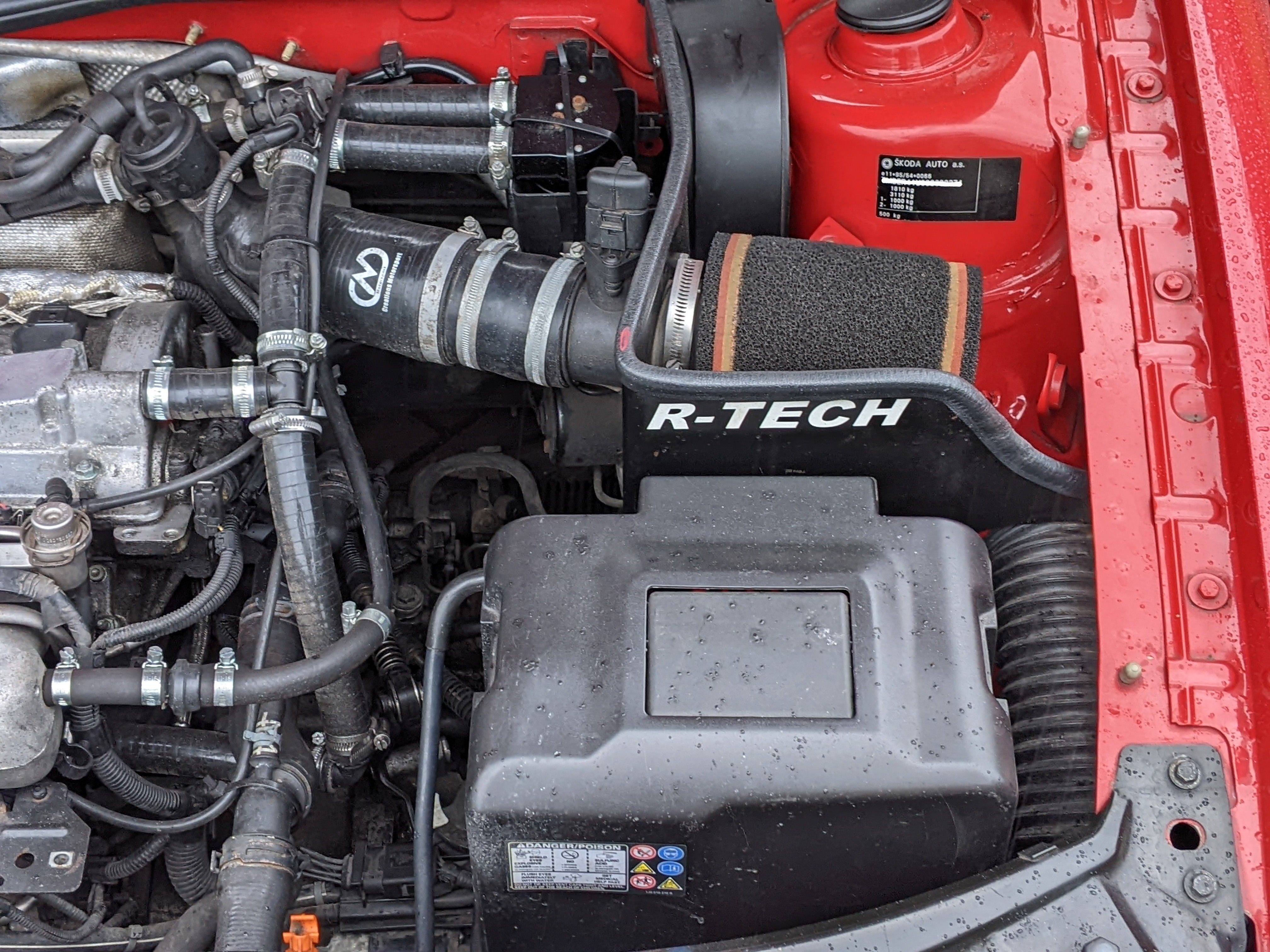

On 07/02/2022 at 20:51, Endoof said:
....comes with breather filter aswell as an aluminium housing? Sheild? Whatever the correct term is which S H O U L D prevent heat soak to some extent.. worst case ill buy some of that flashy reflective gold tape to help
Screenshot_2022-02-07-20-50-40-76_99c04817c0de5652397fc8b56c3b3817.thumb.jpg.cb79e0360e4087f652d598a7840d9e0e.jpg]
Once fitted you could add a cold air feed a bit like mine.  It works well and I've never had any issues with water getting into the filter the via pipe.  Just don't drive through any really deep water and you'll be okay.
Also, please excuse the state of the engine bay, it's my daily driver and winter has taken it's toll on what is normally a reasonably clean bay.
Edited by skinnyman
  • Administrators
When you're bored of the R-Tech heat shield, I'll take it off your hands. 😄👍
