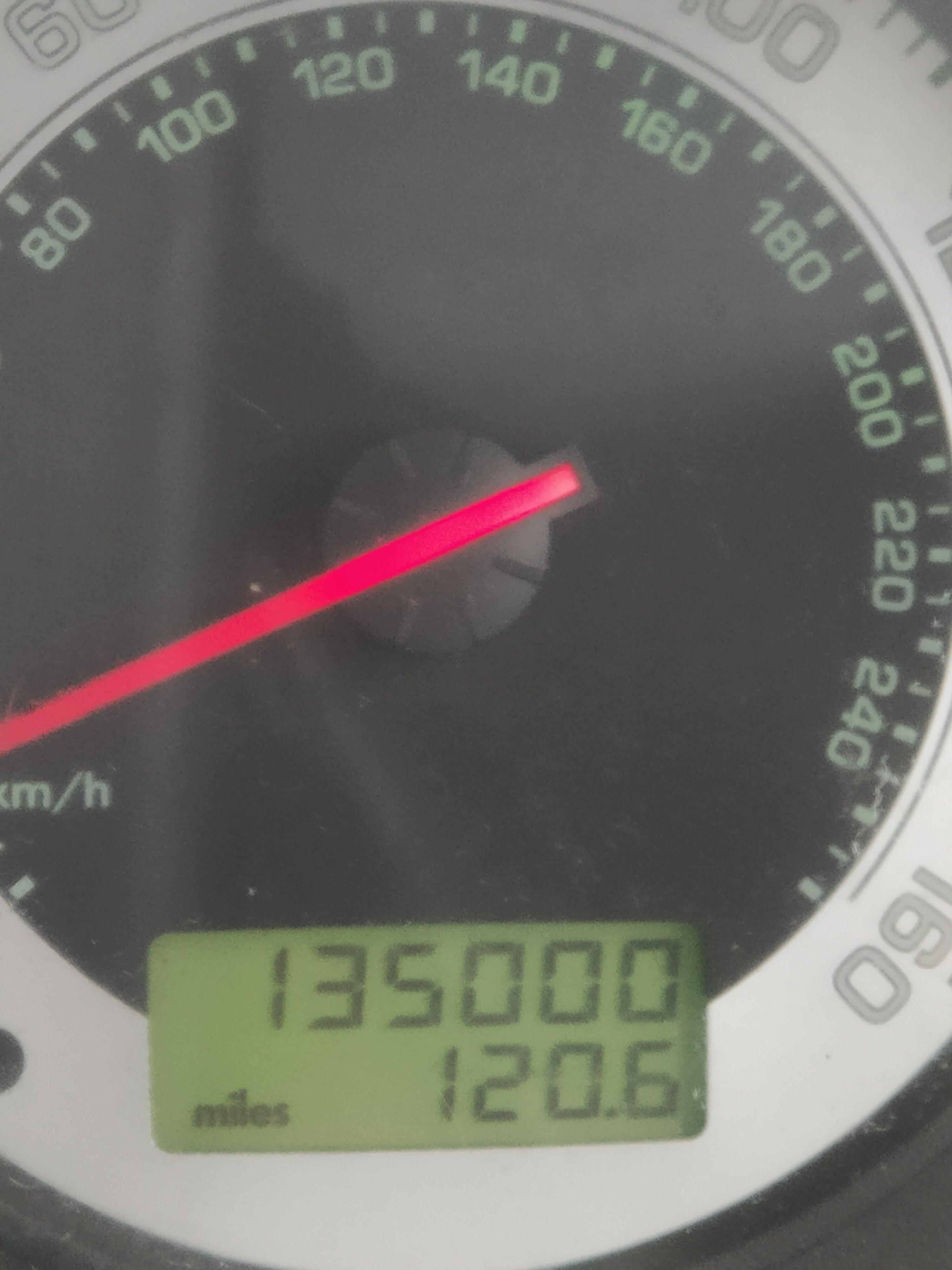

On another note, ticked over to 135,000 miles today, barely just run in eh!
Comparing the car now to when i purchased it in Blackburn it seems to be driving way way smoother than what it did a week an half ago, whether that's down to only putting 98/99 octane fuel in it or it just being driven with a bit of agro i don't know, but it does feel a lot nicer.

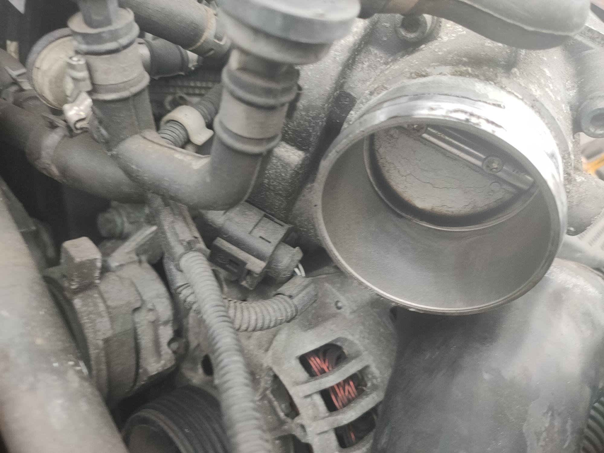

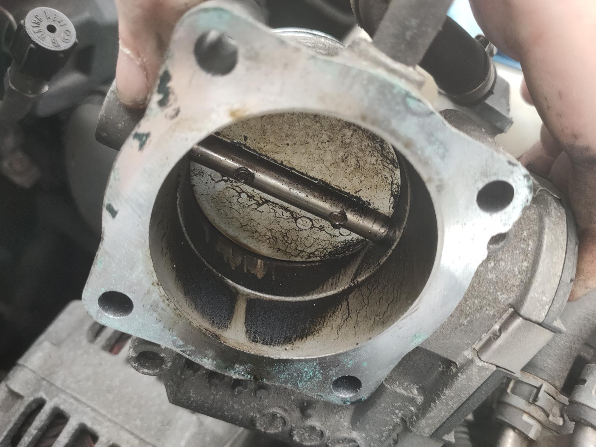

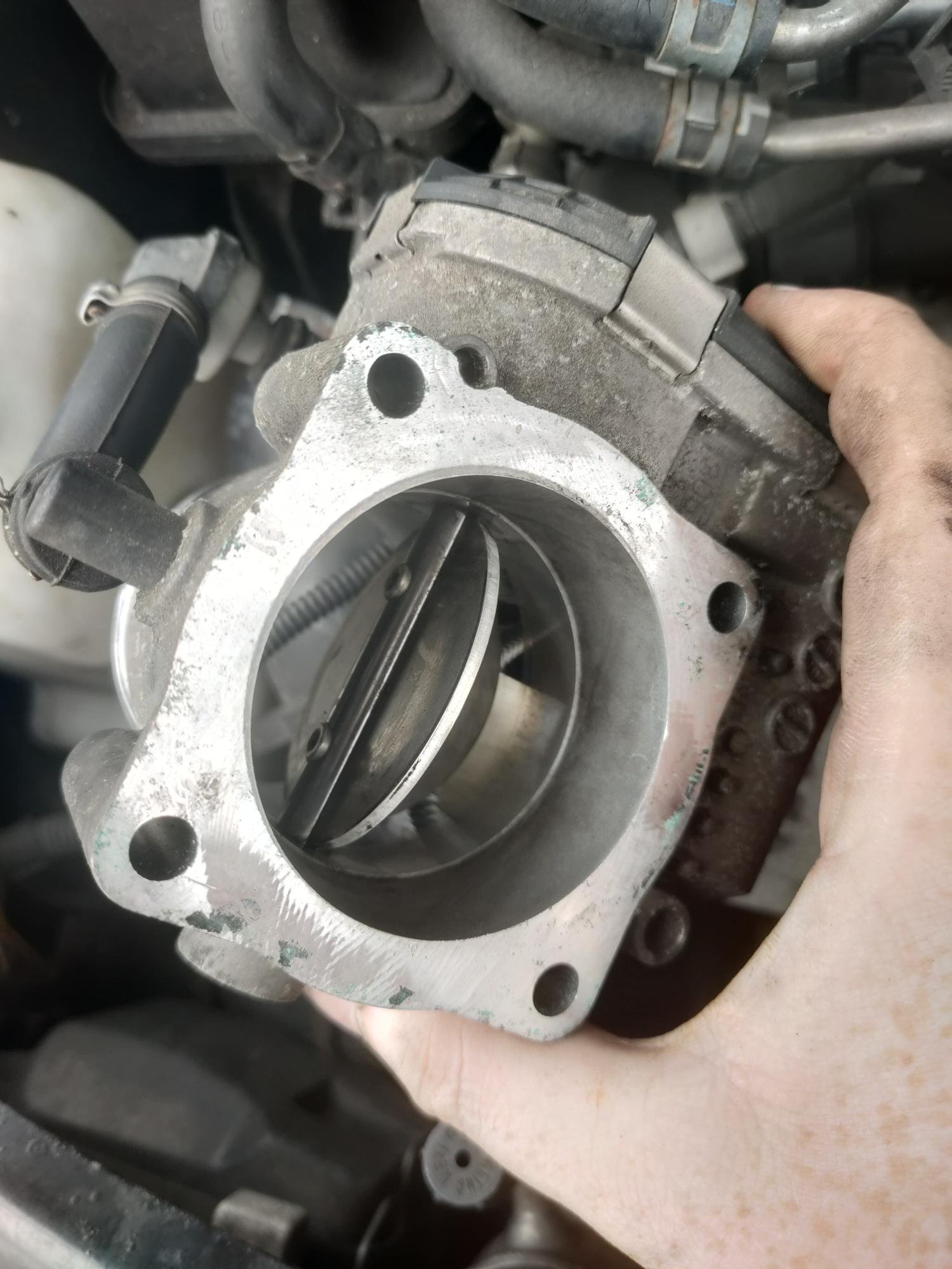

Last week of September, absolutely crazy eh..

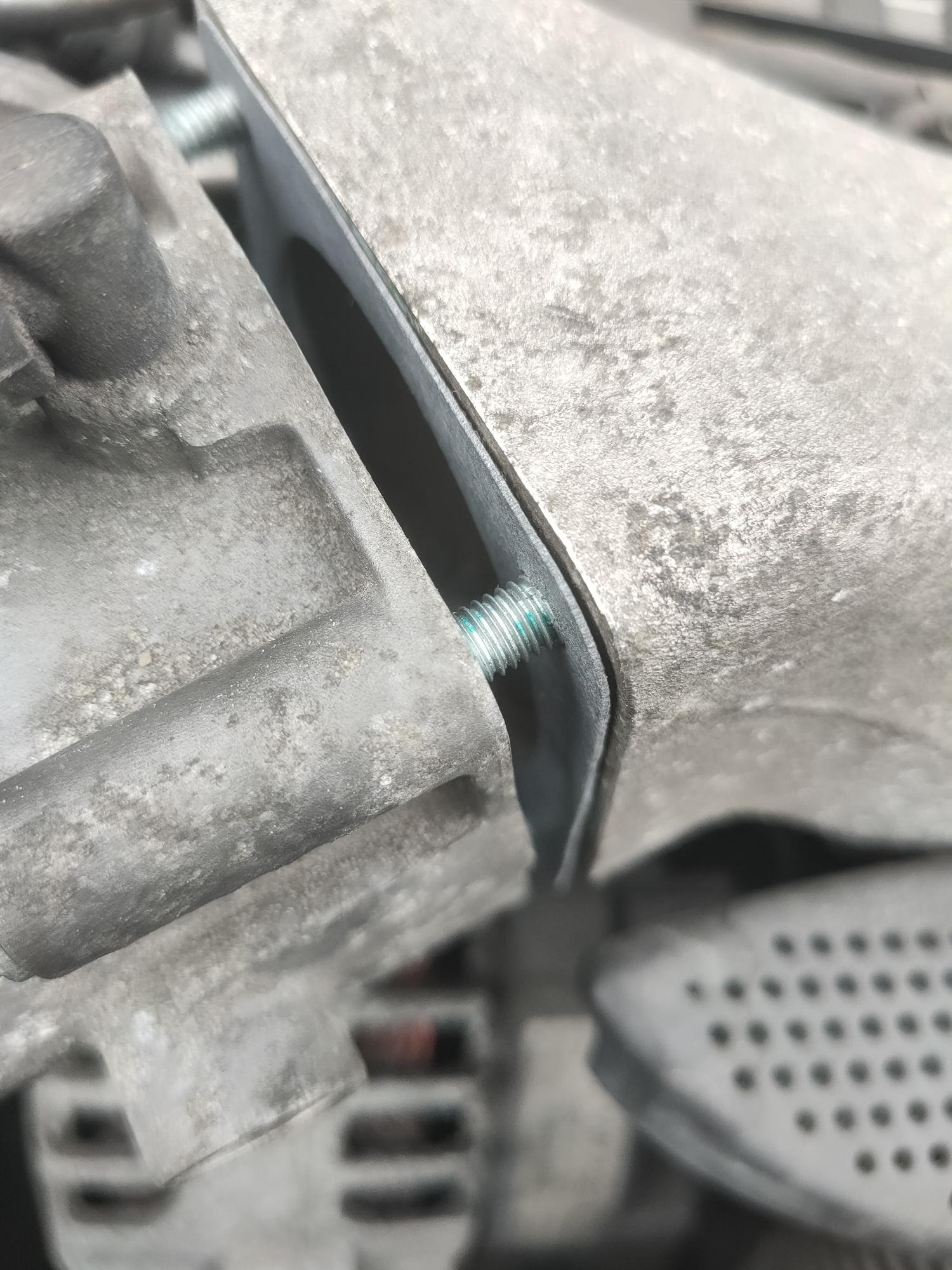

Anyway so despite the busy weekend i managed to get something done at least, i.e clean out the throttle body, turns out it really is a sub 30 min job.
Nice and easy, undo jubo clip holding the hose onto the TB, think it was like an 8mm socket iirc and boom you've got one side of it..
Looking at it from this side i really didn't think it was too bad, cleaned it up using a cloth, some ear buds and a spray bottle of carb cleaner but apart from the coked up area around the actual throttle plate i thought it was surprisingly clean.
Moved on to taking out the allen bolts, think they were 5mm, to reveal the other side and mother of god it was awful
Look at the state of that, safe to say i figured this was part of if not all the reason to the jerky throttle response and hesitation.
i did make sure not to unplug it as i don't have easy access to VCDS to re-calibrate it.. i know people say that just leave the key in position 1 or something to reset it but id rather not take the risk seeing as this cars my daily.
Cleaned it all up, above is before, below is after
Did it the best i could and i think i did a pretty good job considering the state of it before hand.
Cleaned up both of the mating faces on the TB and Intake mani and sandwiched a fresh gasket between them to call it a job done
All in all, easy job to do and just as abit of maintenance i'd highly advise doing it.
The result? The car really does feel like it picks up better and generally just feels more alive, especially in the lower rev range the pick up seems stronger and when motoring around in low revs theres no judder, no hesitation and the overall driving experience is much much smoother.
A must do job for anyone who hasn't done it, i did think it was a placebo effect and that it would wear off at the start but its been 2/3 days now and i'm still amazed at the result you can get for the sake of £10.00 (Carb cleaner from halfords and a gasket)
Gasket i got was a Febi - https://www.ebay.co.uk/itm/174087885784
Cleaner i got was - https://www.halfords.com/motoring/engine-oils-and-fluids/fuel-and-oil-additives/carlube-carb-and-air-intake-cleaner-247638.html
Cheers!

Issues or not i'm sure you'll notice some sort of difference as to how the car runs, still baffles me lol

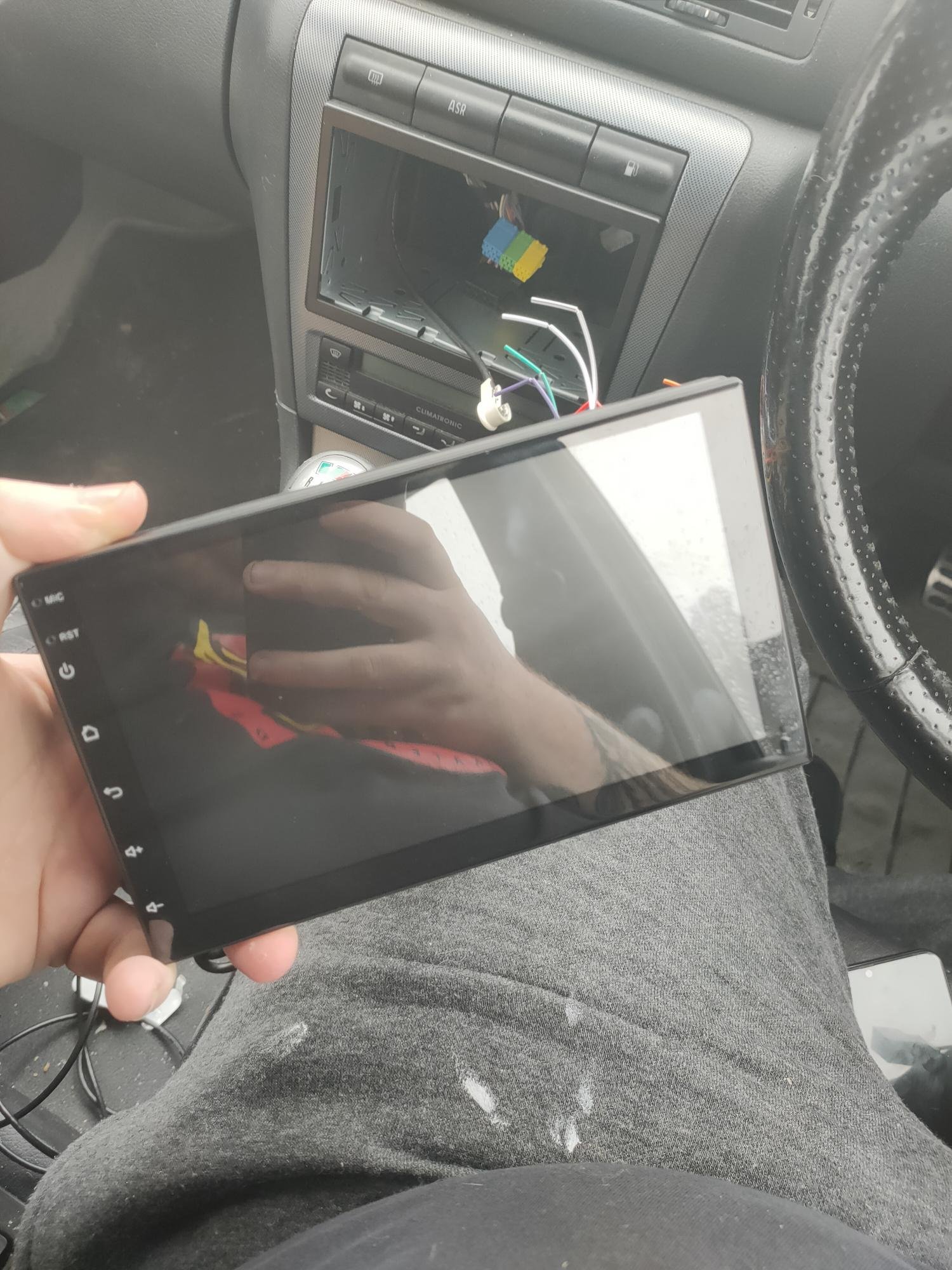

So here it goes, installing a chinesium double din touch screen head unit, by someone with no auto electronics experience.... atall.
Welcome to Jackass. 😂

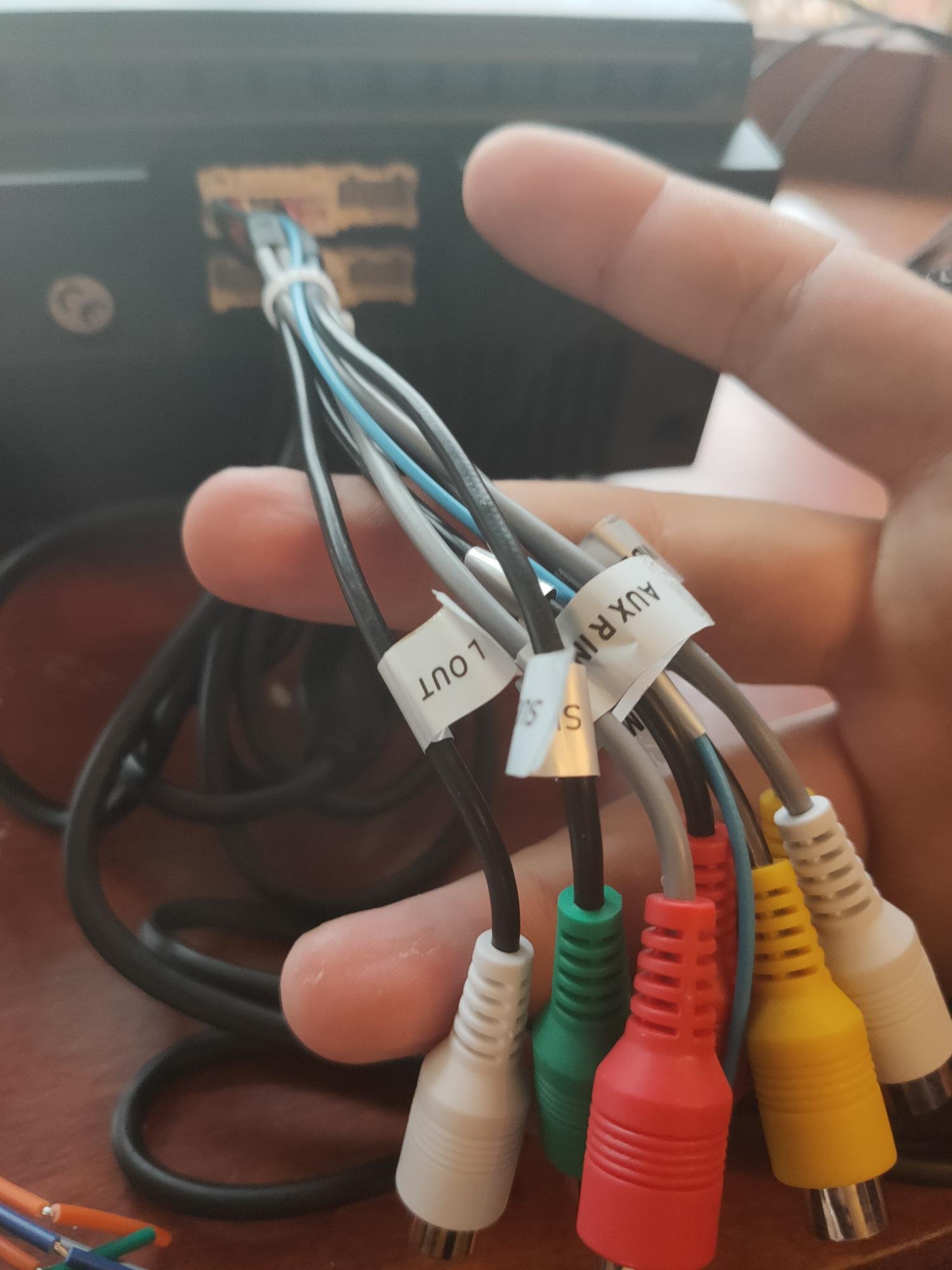

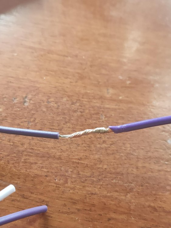

So on saturday i fitted the head unit which turned out to be alot more of a nightmare than it was supposed to be.
pic of said head unit

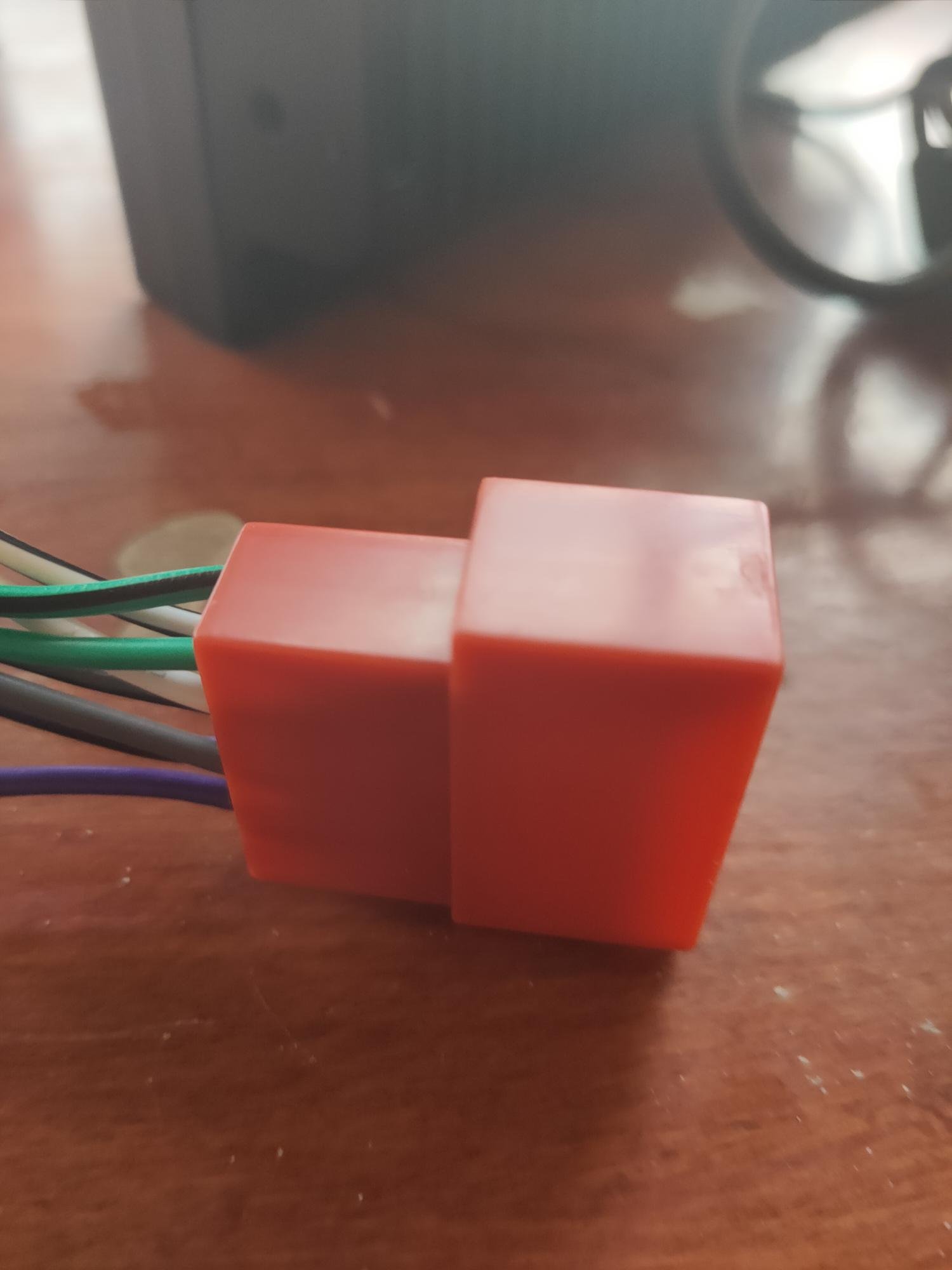

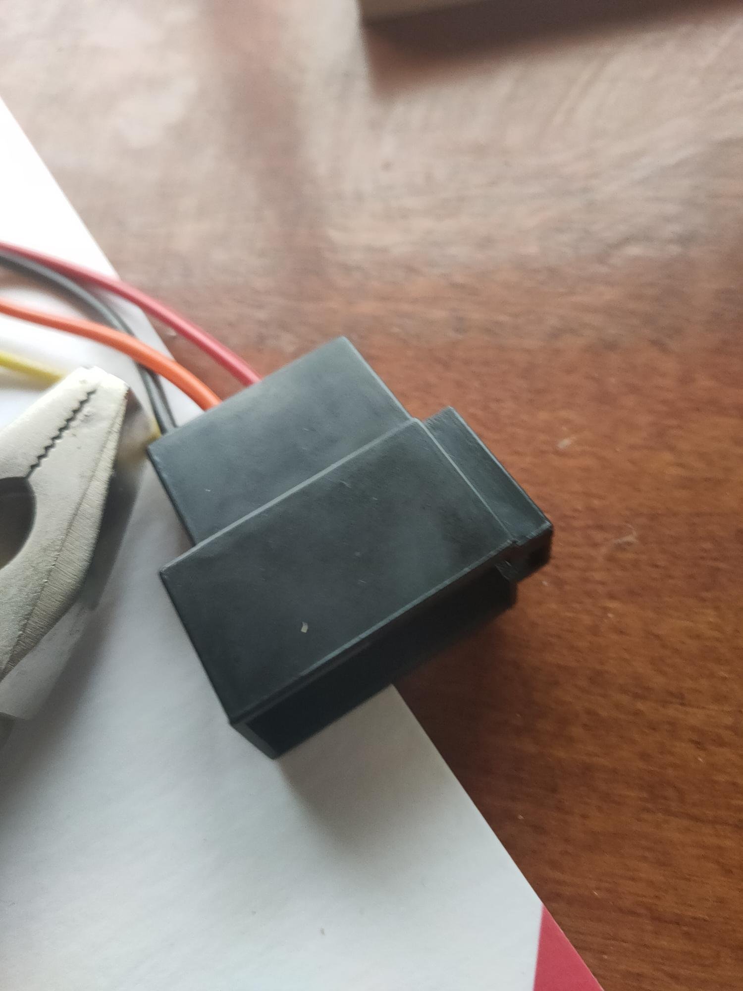

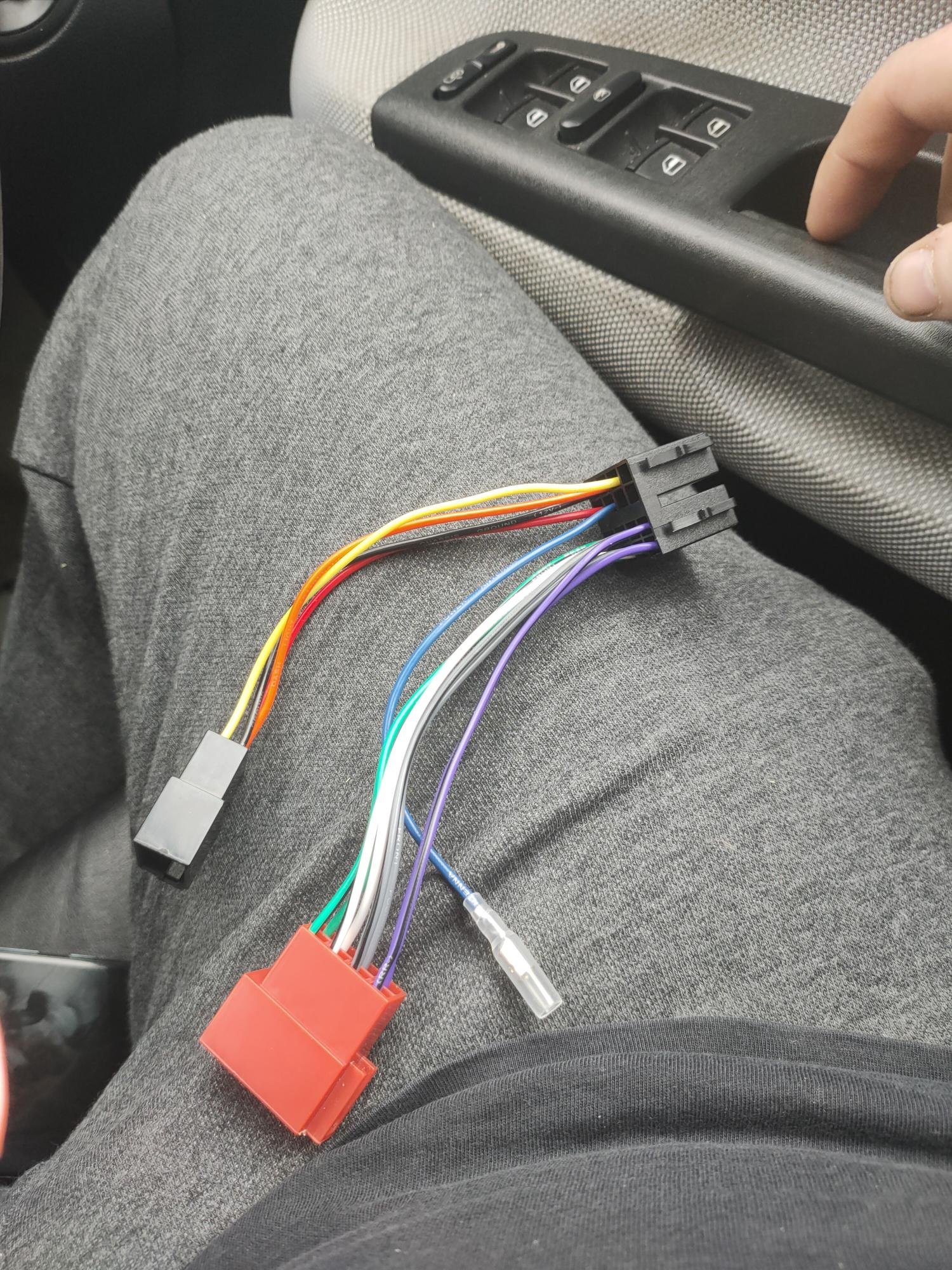

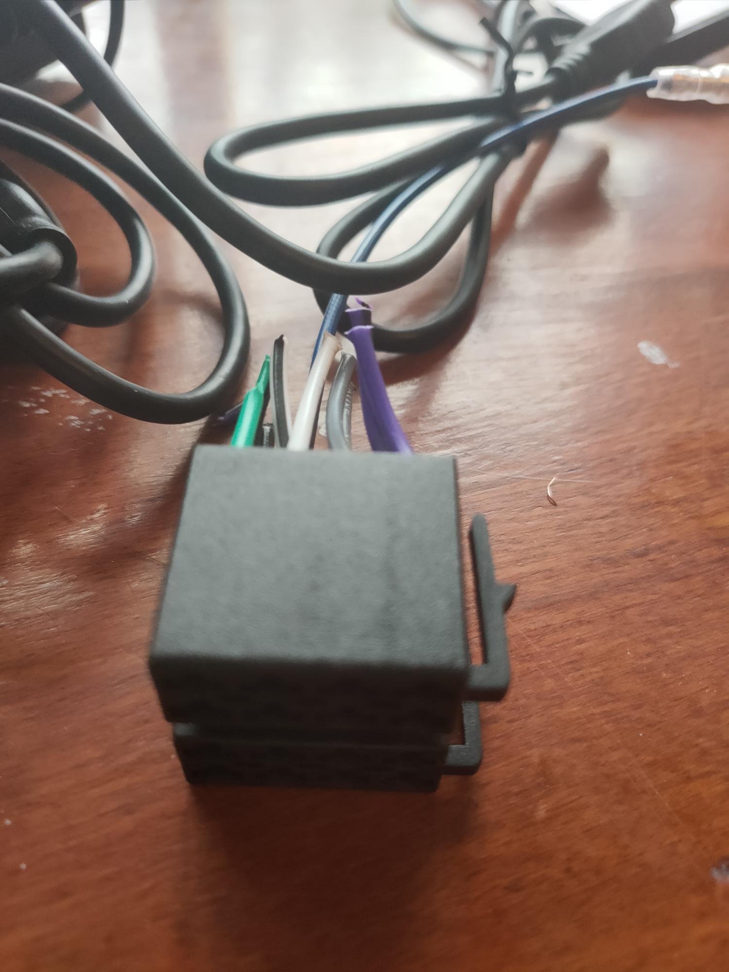

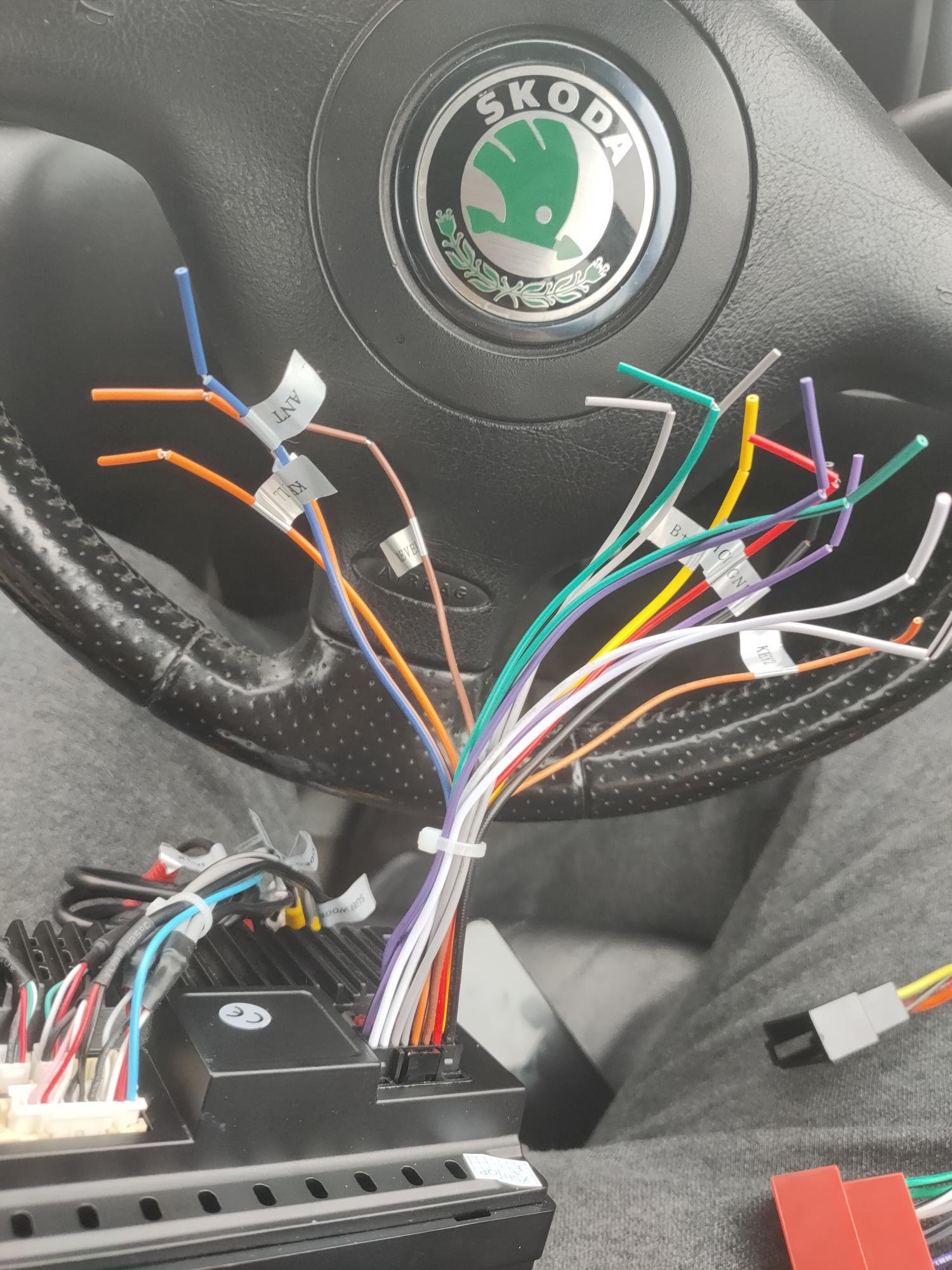

For starters, the headunit came with no harness adapter to join it up to the skoda loom, so a trip to halfords saw me buying a connect2 harness.
Happy days.

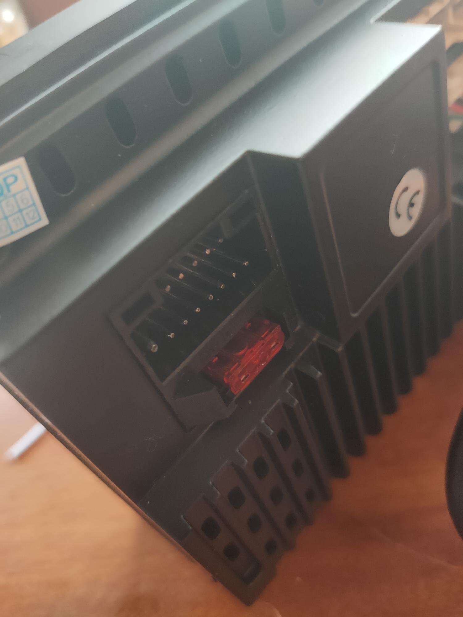

went to get the headunit in, went to connect up the harness adapter, turns out that the headunit hasnt got ISO connections on the back.... great.
Now i've never done one single bit of auto electronics and i didnt know anyone who had so the only alternative was to take a punt, chop up this harness and wire it up one by one, i had no idea what i was doing, the below is what i was having to work my way around.
cut off the plug on the head unit side to start with
got left with the 2 separate plugs for the loom side

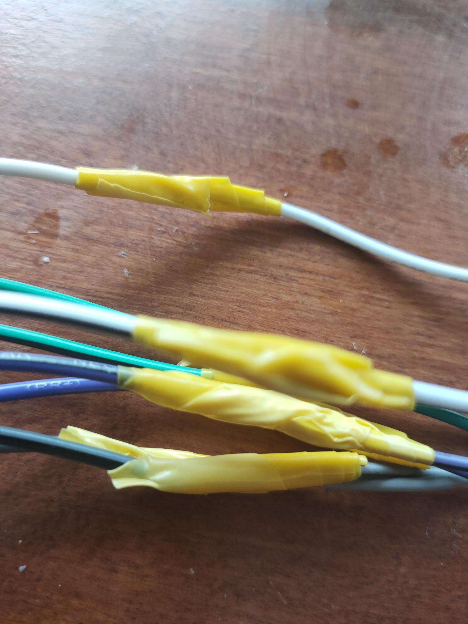

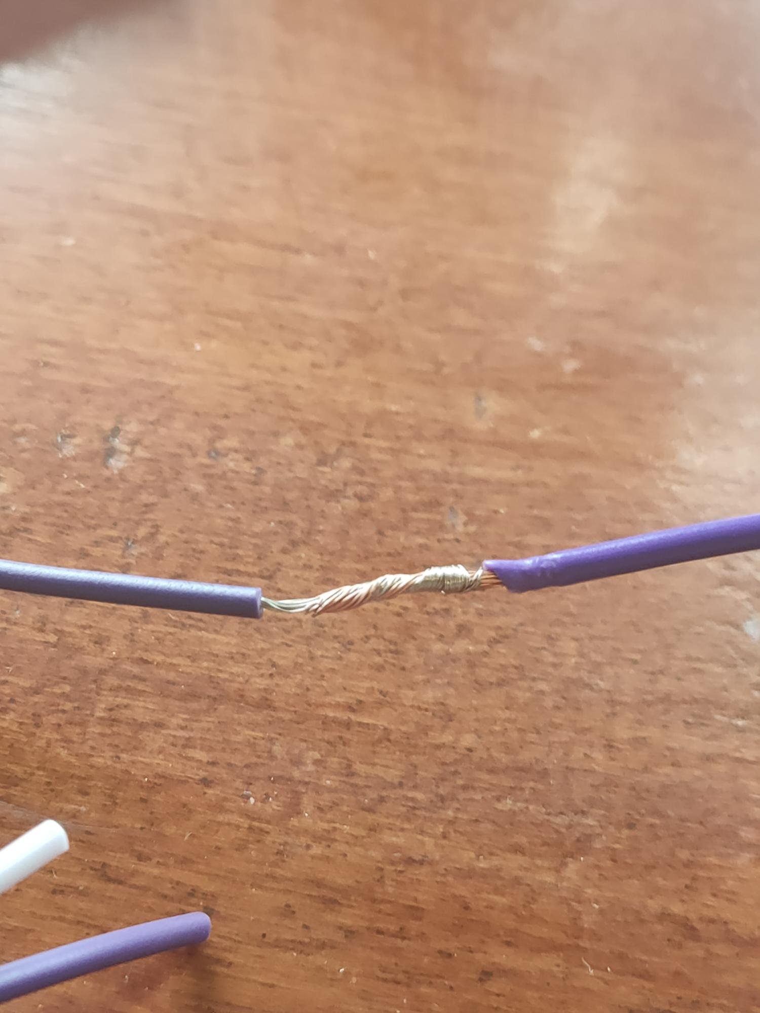

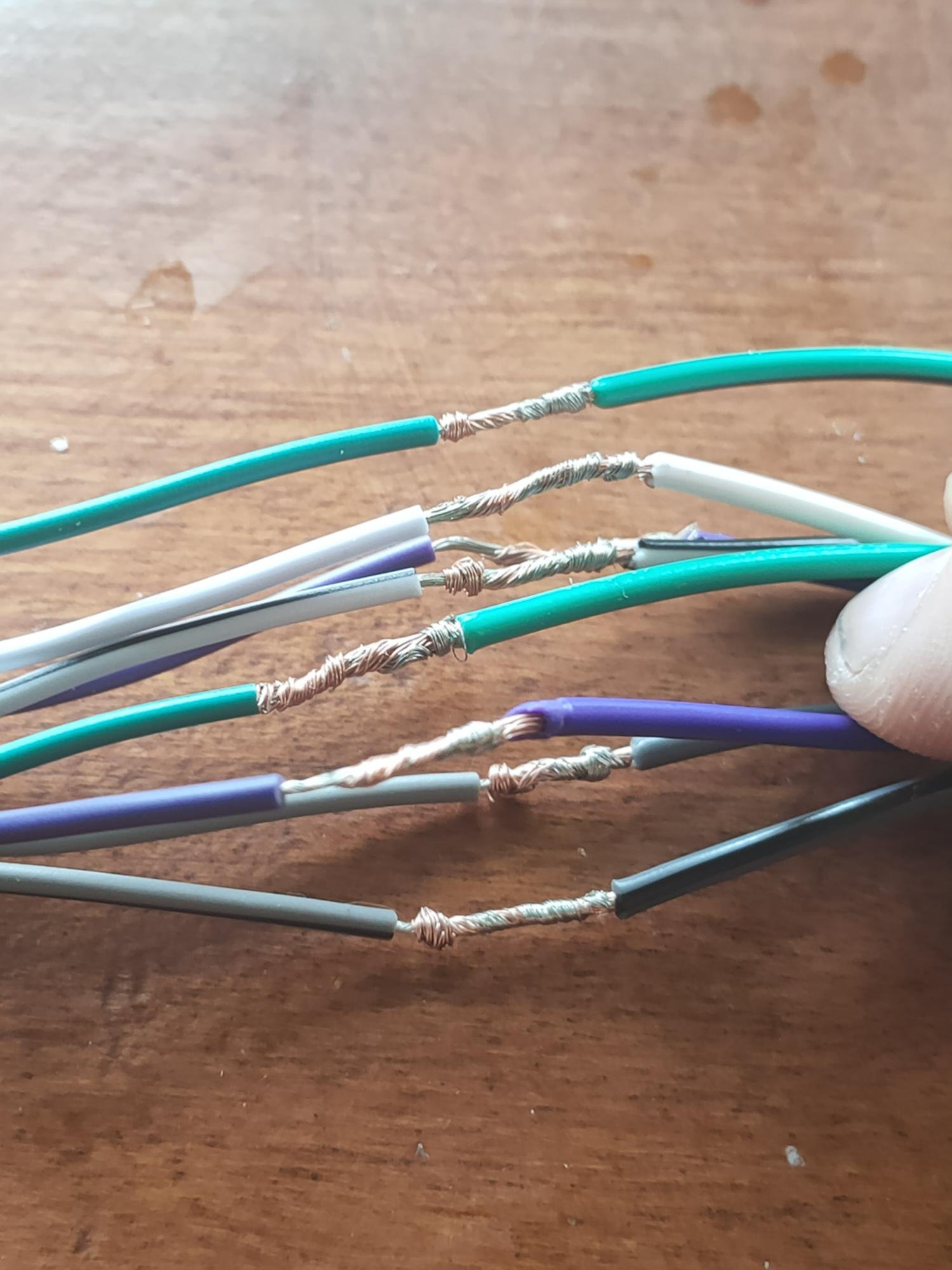

Now, thinking wires are just wires i decided to go about just matching up each individual wire to their corresponding colour on either side of the adapter im making.
First one done.
Seemed to be easy enough apart from the strands of copper in my mouth, so i continued.
i did this for all of the wires following, bit by bit finding out which did what, turns out grey, purple, green and white all relate to the speakers.
tidied them up best i could given the lack of material and tools i had (please dont shoot me for the lack of heatshrink)
i carried this on with the other side aswell with the power, ground, switch live etc etc.

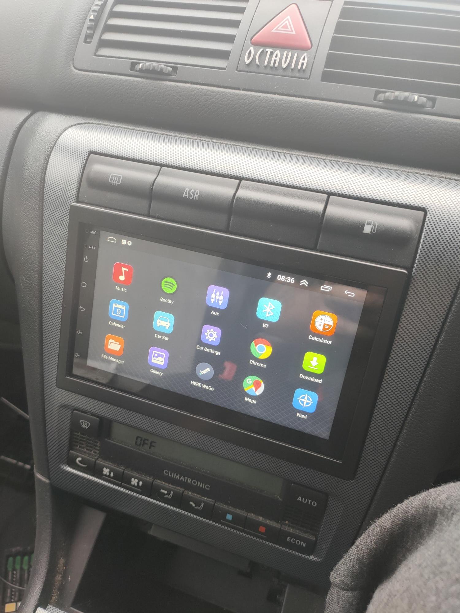

hey presto... it works!
The above pic is the finished product, i will mention however the cage i got from connect2 was way way too small for the head unit, i ended up drilling out the rivets, re bending it with a pair of pliers and sticking it back in, thankfully its properly jammed in there and isnt going to be moving about any time soon and the same goes for the screen too, i'm yet to hook up the radio atenna, GPS antenna or wire up the USB ports but for now i've downloaded spotify and its doing me just nicely.
There were a few wires i didnt need for one reason or another, such as the below
But i think they might be for an amp and sub? if someone can let me know thatll be grand.
Apart from it being a little bit slow (not in an annoying way, just compared to the mobile phones of today worth £500+) its perfectly fine and for the sake of just shy of £100, the quality of life has improved tenfold.
would 100% advise this mod to bring your car into the modern era.

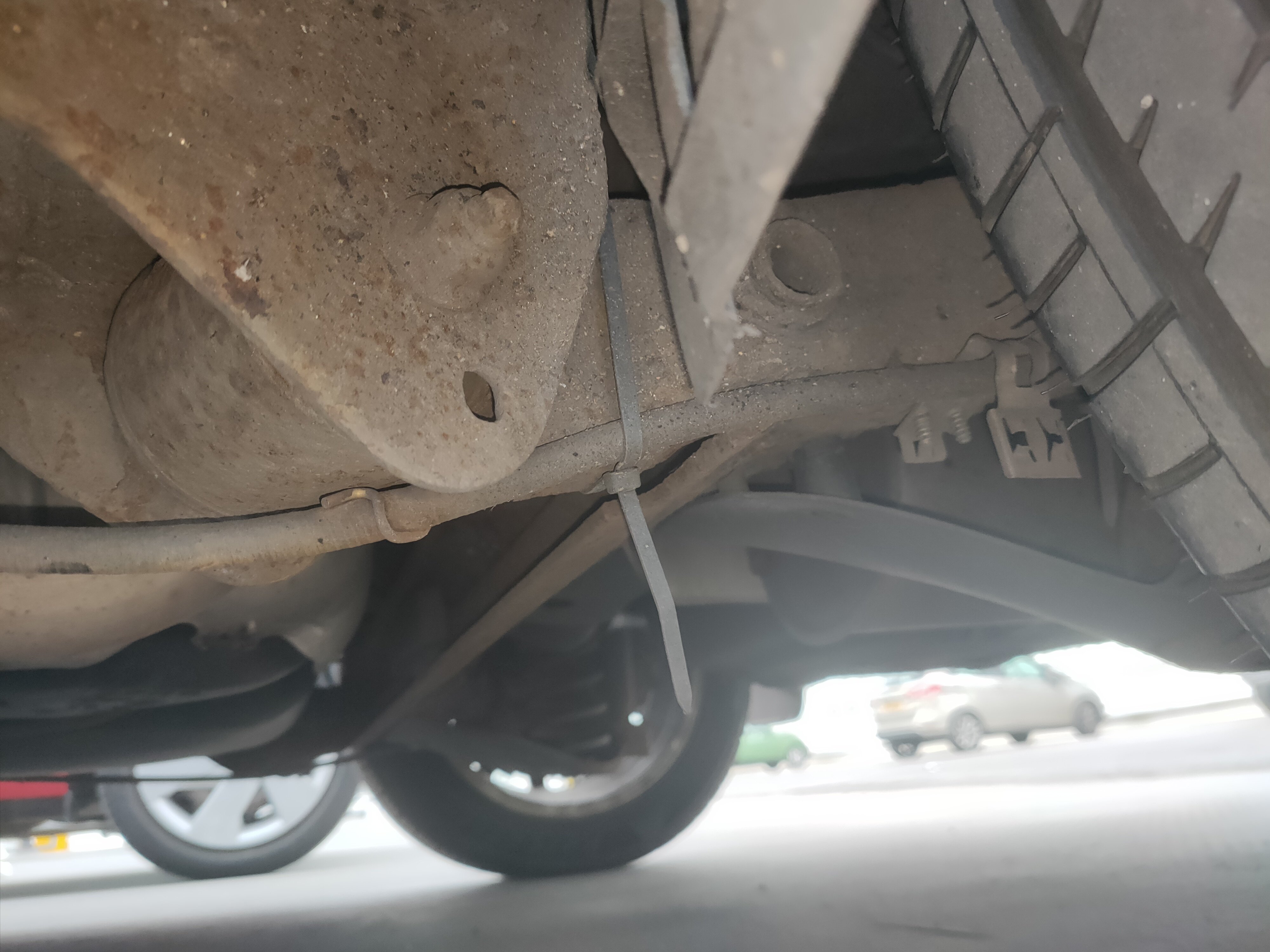

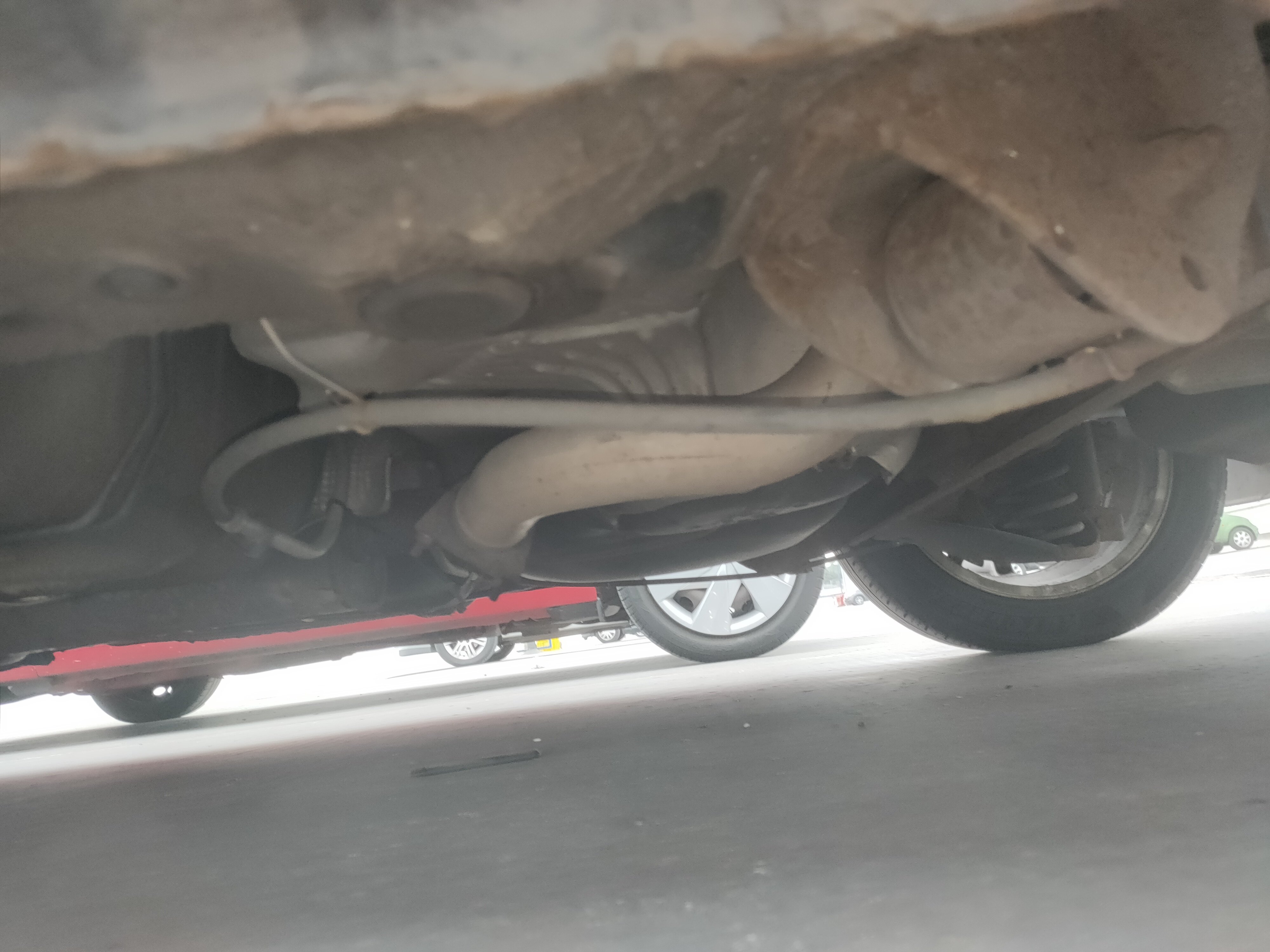

On another note however, approaching the car from a distance the other day and noticed the below, held to the car with cable ties..
(pics below)
Q1. What is this for?
Q2. Im gonna assume this isn't meant to be in this location, so where is it supposed to go? because that's waiting to be damaged by something
Thanks in advance
(p.s, still not got the topmounts in lol)
Handbrake cable?? That'd be my guess.. see where it terminates...
Should it be held up with cable ties? 😂
Well they aren't usually but they do sometimes dangle a bit, previous keeper may have been worried it was hanging too low? ... as long as it's not affecting the function I see no issue tbh.
Could always cut it loose and see... if it's too low, re cable tie it.
It looks like the previous owner couldn't be bothered to redo the clip behind where the cable tie is there or said clip can no longer fasten. Try redoing that clip and you won't need the cable tie if it stays shut.
