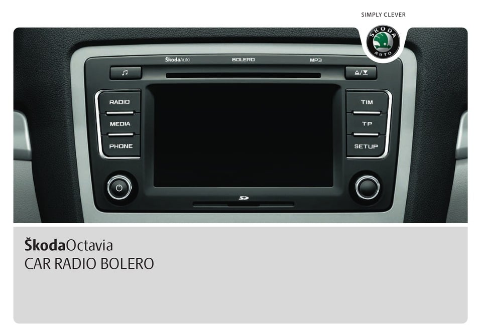

Sound system:  "BOLERO"  ( # 1Z0 035 156 G )
I'm in need of newer software/firmware files to update my unit/device with it.
Skoda "Bolero"  <------> VW RNC510
These two are very closely related not to say the same under the shell.
What is the latest software version for the BOLERO audio device ? ❓
