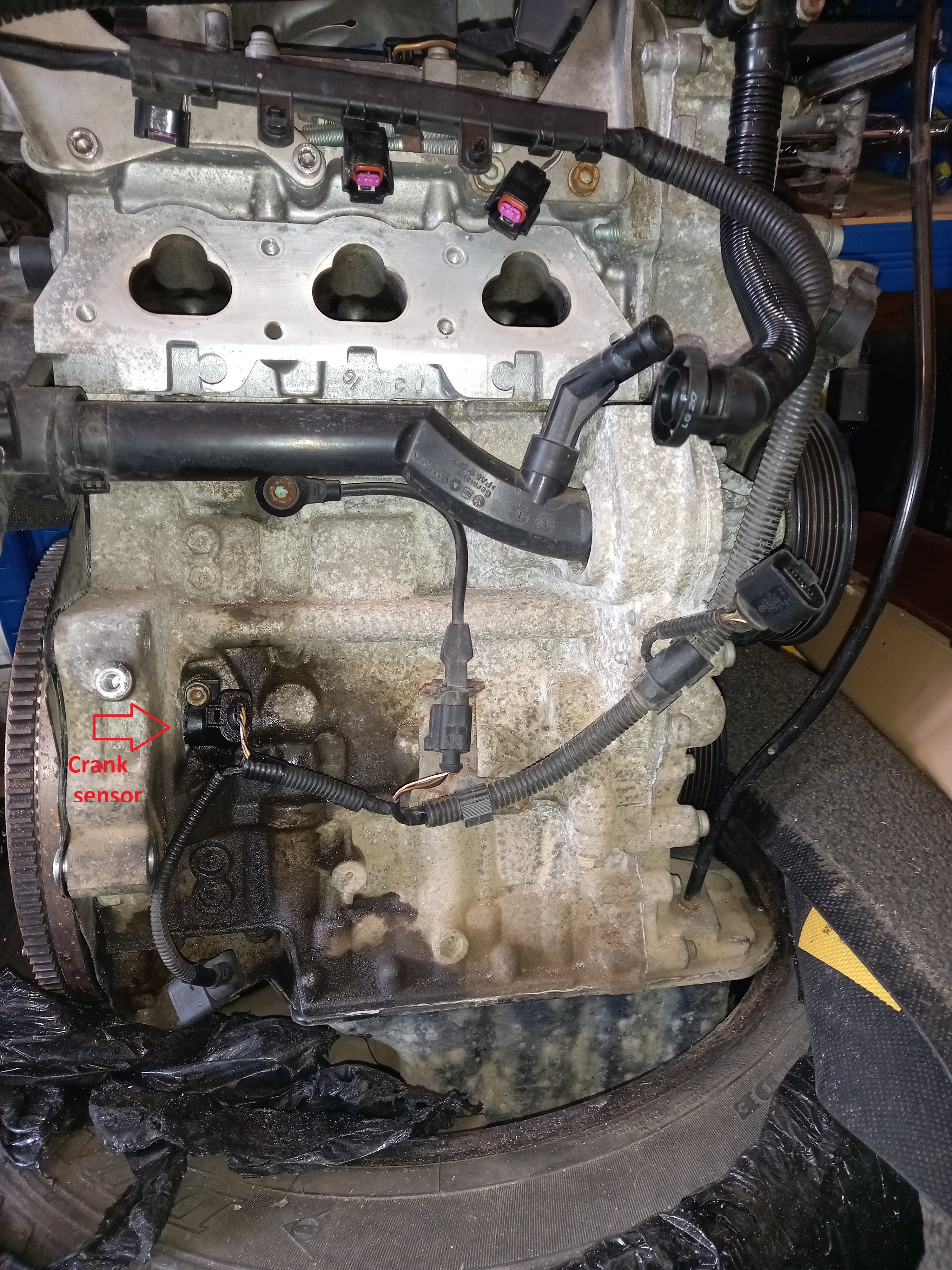

Does this point to the crankshaft sensor being faulty? ,also does anyone know the location of this senor as the Haynes manual is clear as mud about this.

I would suggest that you check the chain timing before replacing anything else. This can be done by removing two covers from the battery end of the rocker cover, and checking the relative angles of the two slots in the ends of the cams.  They should always be at the same angle relative to each other. When cylinder 1 is at top dead centre on either compression or exhaust stroke, they should be parallel to the head/block join.
Crank sensor is in an awkward to access spot on the back of the engine block.

So is it fixed? With a new crank sensor?
The sensor is changed, you were right about the difficult access.
The fault has cleared and its starting up properly and light staying off.
