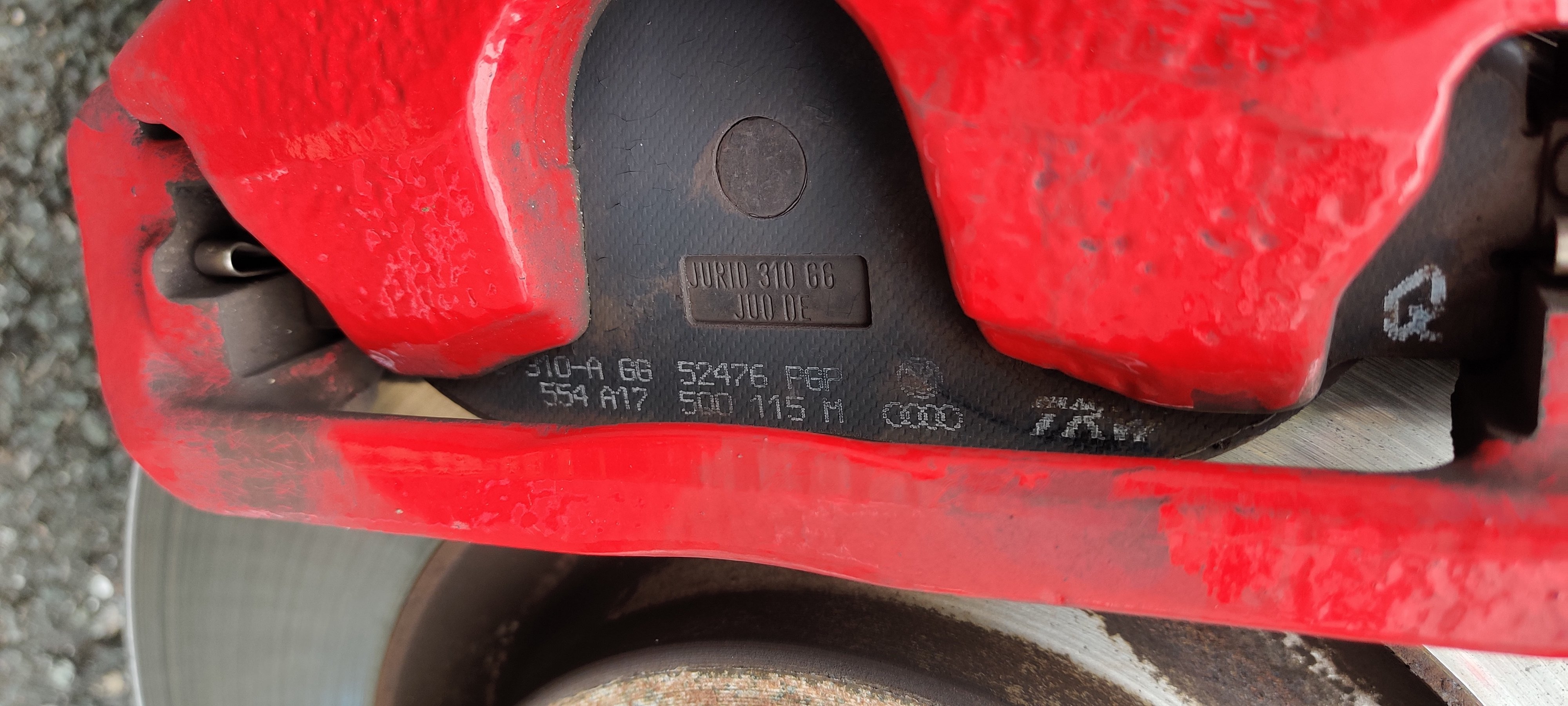

Original brake pads, VRS 245 2017.
Hi,
The original brake pads bear both TRW's and Jurid's brand name.
Jurid appear to be part of DRiV Automotive Inc, whereas TRW are part of ZF TRW Automotive Holdings Group.
Jurid and TRW sell pads/ rotors independently, after-market, so why would they collaborate for OE?

Pad is Jurid.
Braking system is TRW.
That'w why you have both brand logos on the pads.

As above OE pads were Jurid and caliper was TRW, which is why fitment is printed on the pad. Earlier VWs with the same brakes had ATE calipers with a different fitment so probably helps save some idiot trying to hammer the wrong pads in.
