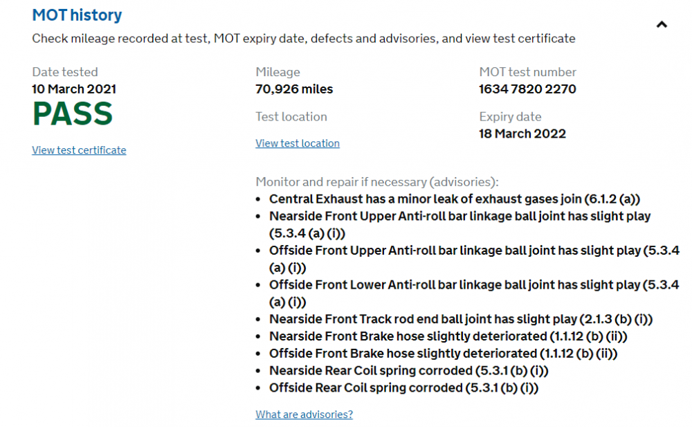

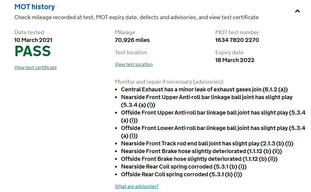

On its last MOT it had several advisories, but the dealer noted that this was performed by Halfords (implying they would look for stuff to repair and charge?), and the previous owner was an old lady who always paid to ahve whatever work she was advised to have done. Please see attached image for its last MOT. My question is, how likely are those advisories to cause a fail come 12 months & could anyone give a rough estimate of how much it would be to repair any number of those.

None of those advisories is a cause for serious concern. ARB links are trivially easy and cheap to replace, as is the exhaust joining sleeve that is the likely cause of the slight leak.
The last four I would ignore completely as they are subjective and fairly inconsequential. Iff you did want to clean-sheet it, brake hoses and rear springs also not expensive to buy or have fitted.
