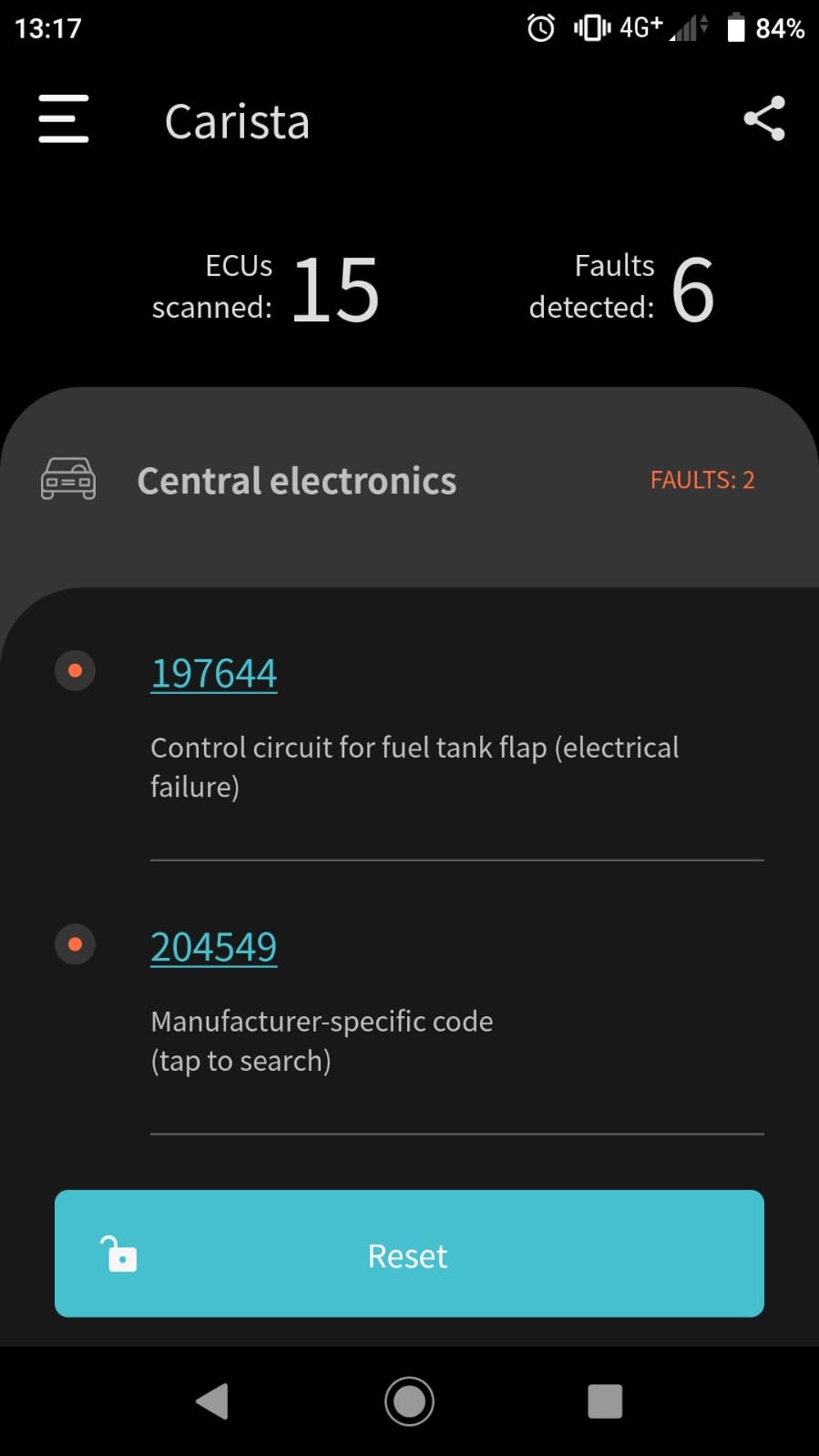

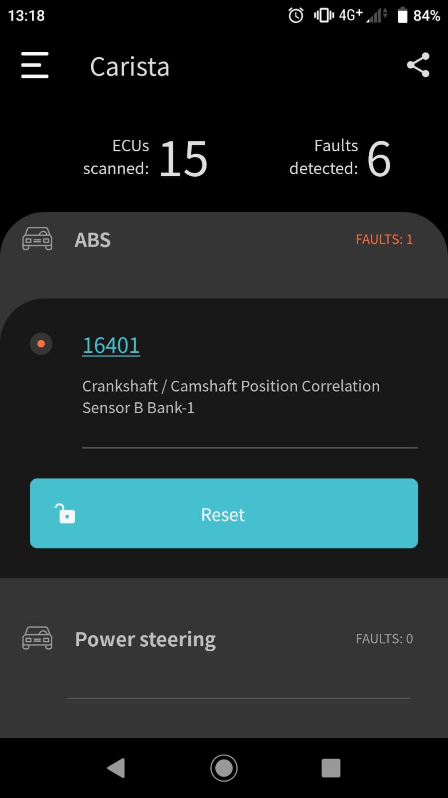

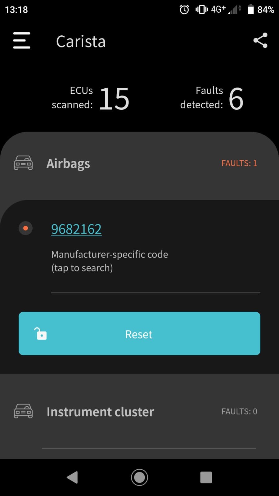

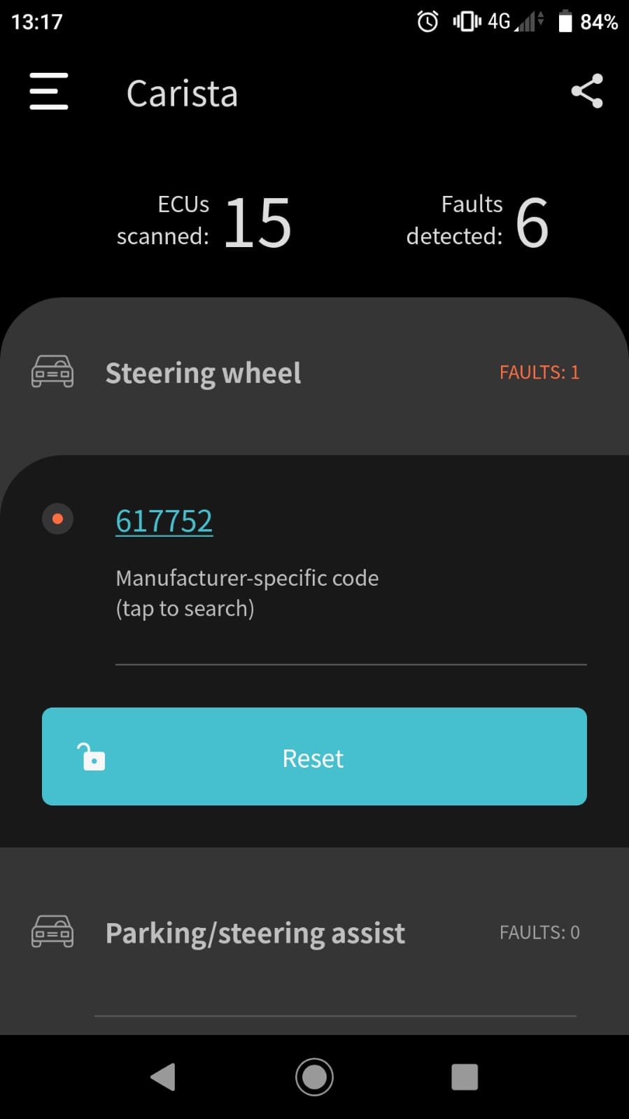

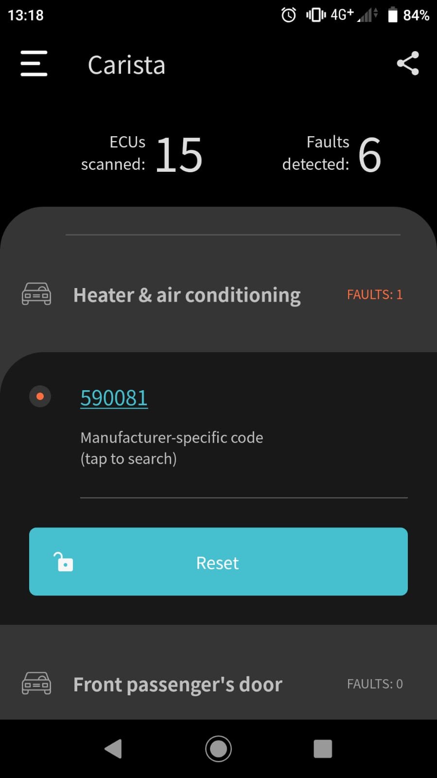

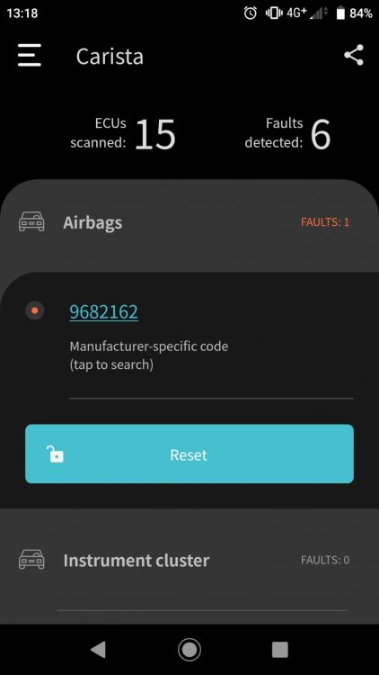

So my pal came round today with his wee carista device and we've got the following codes. The 16401 is incorrect as on VCDS this reads as a tyre pressure monitor.

carista scanning not reliable at all.  i have carista for coding, but to read errors  vcds.    get voltmeter to inspect battery instead trowing money for new one. maybe needs to be recharged 24h in your house with decent charger.
